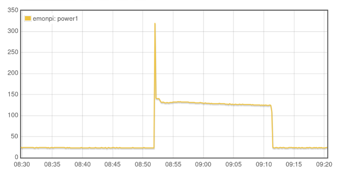

Hi André,
What I understand is that when switching Appliances that have motors in them, there is a peak of current that may be over the ~15A limit that the contacts of the Smart Plugs.
Does it seem reasonable?
There will be a peak of current, called “inrush”, as you say. Here is my combined refrigerator/freezer starting - the vertical axis is watts (not current), captured by an emonPi with an averaging time of 9.8 seconds. From the graph, the average power over the 9.8 s interval was about 300 W. The peak probably lasted less than 1 s, so the peak power could have been about 3 kW or more, so about 13 A - which is the continuous rating of the plug and socket. The current when it is running is about 700 mA at a power factor of 0.65, which gives a real power of a little over 100 W as shown. The voltage at the time was about 235 V rms, 50 Hz.
Whether it will be greater than the continuous current rating of the Smart Plug, and whether this matters, might be very hard to find out.
