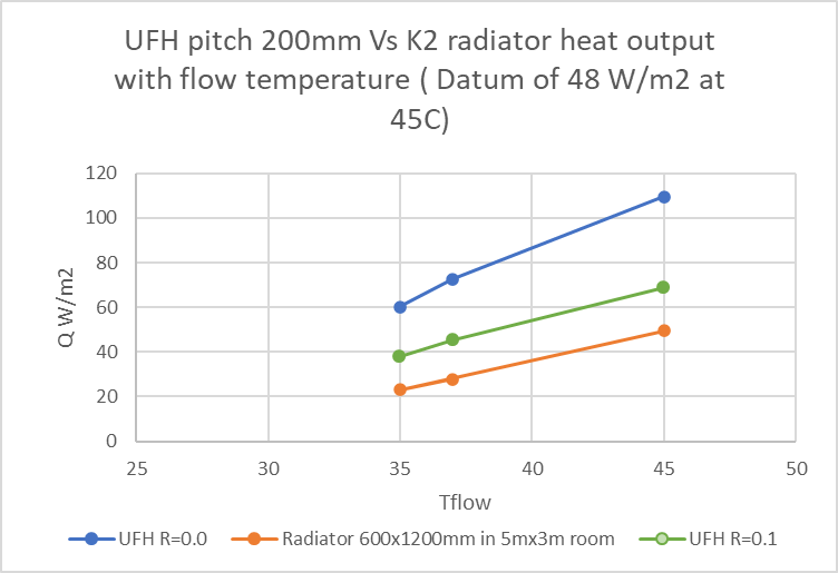

I hope the plot here helps. It shows the heat delivered by the UFH with a pitch of 200mm against a K2 type radiator. The radiator size is chosen to deliver 48 W/m2 at your original design case for an notional room size with a flow temp of 45C. The 48 W/m2 was based on your 6.5kW ASHP in a 136m2 house. (6500/136=48 W/m2). It suggests the UFH with 200mm pitch may not be the constraint. The UFH (200mm pitch) should typically offer higher performance than a radiator system. Unless it has a larger than normal room floor area unheated, or a carpet, or wood laminate covering with a TOG>1.0. If you have an UFH mixing valve, then that could adversely affect the UFH flow temperature. It was difficult for me to understand the heavily insulated piping around the UFH manifold.
Typo on key, R=0.0 should read 0.2?
Hi Judith, I will be able to re-check the CIBSE guide in a few weeks. However, from memory, the R=0.0 is correct and applies to ceramic tiled floors with no thermal resistance. The ceramic tile allows more heat into the room. The R=0.1 is probably a carpet (ToG=1.0). We opted for wood effect ceramic tiles in our house and small rugs for this reason.

Hi njh, Here is the UFH lamiate floor versus radiator comparison more tailored to your situation. The data was taken from the CIBSE guide book. It suggests a 22mm wooden laminate floor cover with R=0.15 should still perform better than a K2 radiator. I added the 150mm pitch option to show the extra heat output compared with the 200mm pitch. It is ~3 W/m2, which is pretty small. So the choice of a 200mm pitch or a 150mm pitch does not appear to be a deciding factor for your UFH system heat output.
You may want to gather more information on the flow and heat balance in to the ground floor UFH heating loops and the upstairs radiators. The very “simple” chart suggest the radiator heat output still constrains the flow temperature compared to UFH, but it all depends on your house characteristics ( radiator sizes, etc, etc).
