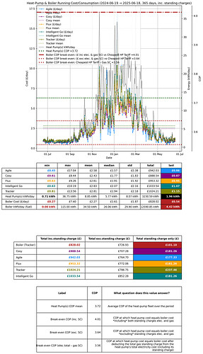

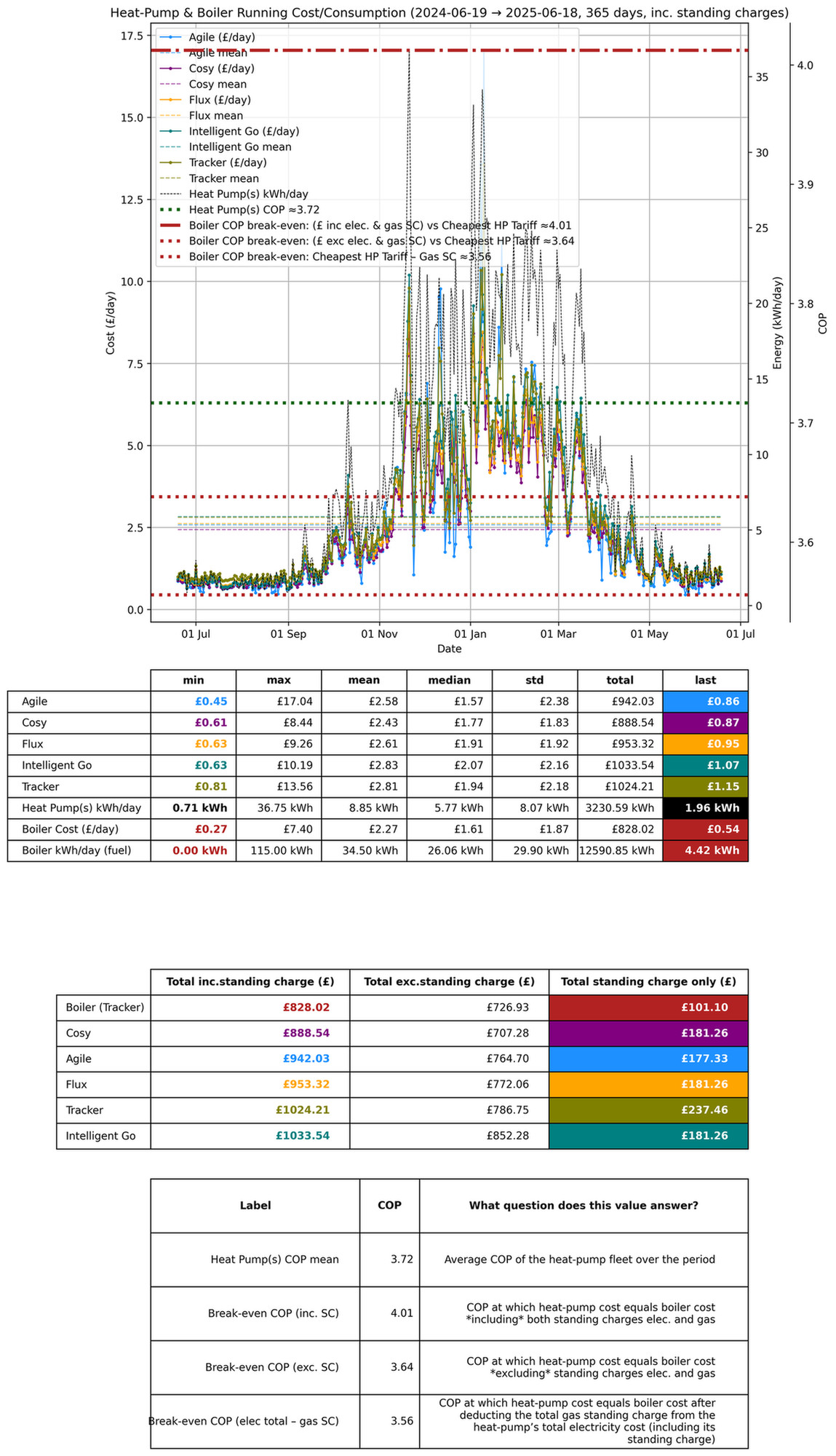

Yes, it’s possible and as long as queries are not overloading the servers, you should be OK. I compare my boiler to heat pumps as there’s no such research available elsewhere. Here’s an annual view of one of the graphs I generate with the data. Thanks OEM :green_heart:
See: HeatpumpMonitor.org
