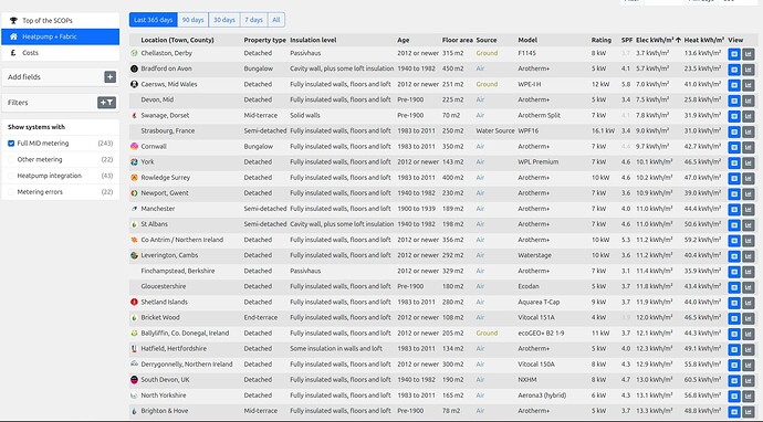

Hello @Staedford did you see the fabric page, it gives figures in kWh/m2 which is a common metric for building fabric efficiency: HeatpumpMonitor.org

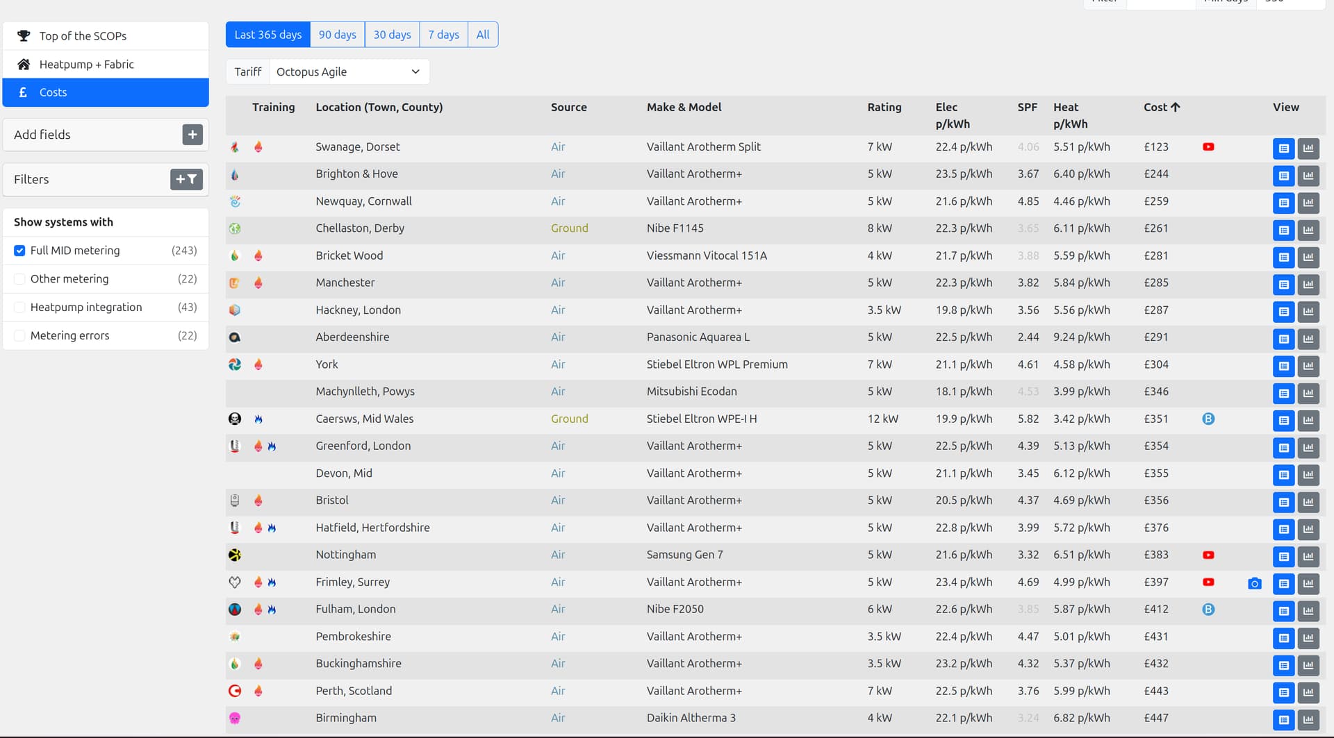

There’s also unit cost and total cost:

I’m not a big fan of CoP as the only or even the primary metric; it’s notable that the systems at the top of the Heatpump + Fabric dashboard report distinctly average SPF figures, despite having the best-performing building fabric.

If the gas/oil users are your audience, why then does the page not open on the costs page, where is the horizontal line that says, all the users above this line users that can heat their home for less than a oil or gas user, without significantly changing their building fabric. I could go on,…..
So an oil/gas user could visibly see, that there are real people with actual systems heating there house for same or less, with little or no change to fabric.
