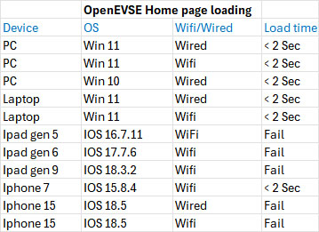

My problem accessing the OpenEVSE home page using Apple devices has worsened recently. I believe this is an Apple specific problem but am sharing the details here as I have no idea how to correct the problem.
I am currently using:
OpenEVSE 7.1.1.EU
OpenEVSE Wifi v5.1.2
My test is to simply use a browser to access the home page which in my case resides at 192.168.1.140
The devices that generally fail to sometimes succeed but very rarely and often with only a partial page showing.
These are the results:
