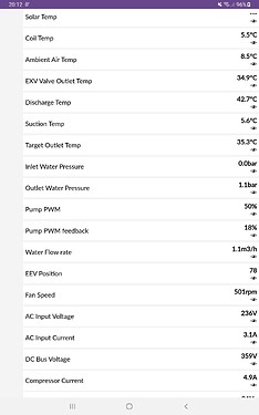

In my experience, NIBE units are pretty good at reporting data at multiple points around the refrigeration cycle. For example, my NIBE F1145 GSHP reports:
  • Con­denser Temperature (BT12)
  • Dis­charge Temperature (BT14)
  • Liquid Line Temperature (BT15)
  • Suction Gas Temperature (BT17)
In addition to:
  • Supply Line Temperature (BT2)
  • Return Line Temperature (BT3)
  • Brine In Temperature (BT10)
  • Brine Out Temperature (BT11)
(I believe the “BT” codes are NIBE-specific parameter names.)
I don’t think the data from my own system will be especially useful - since it’s Ground Source and doesn’t have a variable-speed compressor - but other NIBE installations might have this data available.

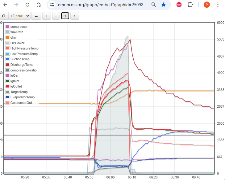

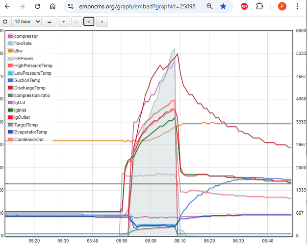

Have 1 minute data from 12 kW LG ThermaV (R32) collected for about 18 months. Data in emoncms
The low/high pressure temps are conversions from low/high pressure sensors converted to temps via interpolating R32 data.

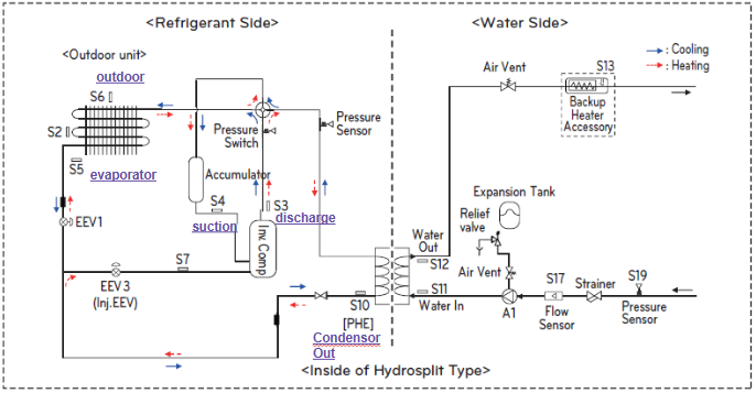

The cycle diagram for the LG is taken from their install manual, I’ve labelled the suction/discharge/exporator & condensor out sensors below. Hopefully the rest are obvious from the feed name. The registers used to obtain this info are not in any official docs I’ve found but from intrepid developers who I believe had access to the LGMV tool to create a sensible register mapping (credit to LG Register documentation · basti242/homeassistant_lg_therma_v_modbus Wiki · GitHub)
Let me know if you need to locate the feed data.
(I’d also say that the lgOat (outside air temp) is typically 2 deg higher than reality, measured by other sensor. And their temp sensors only have ~0.5 deg resolution)

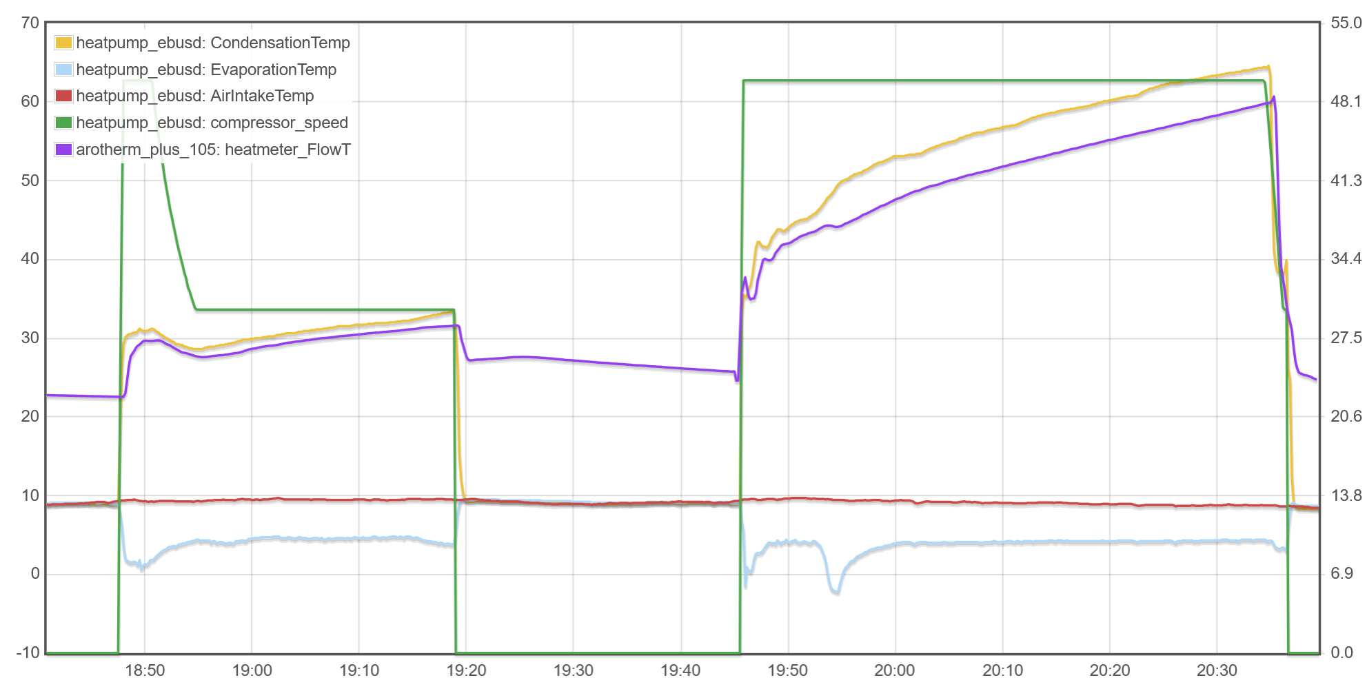

So here’s some representative data from me (Arotherm plus 105/6 10 kW). I can only offer two compressor speed datapoints as my heatpump runs either at 30 rps (heating) or 50 rps (DHW). Due to massive oversizing, heating never requires more than 30 rps besides the initial ramp-up period in a heating cycle.
The typical Vaillant shenanigans of course also apply to their other sensors. I have manually shifted condensation and evaporation temperature to roughly overlap with the air intake temperature during idle periods. Of course this still leaves these values uncalibrated vs. my flow temperature measurements…
In any case, here’s the data. The evaporation temperature is 5K below the intake temperature for both 30 and 50 rps. The condensation temperature is about 1.1 K above flow temperature for 30 rps and 5.5K above flow temperature for the 50 rps DHW run.
So from this limited data it appears that mostly the condensation temperature shifts upwards relative to the flow temperature.
I will try to get a full power DHW cycle in the coming days to add another datapoint.
