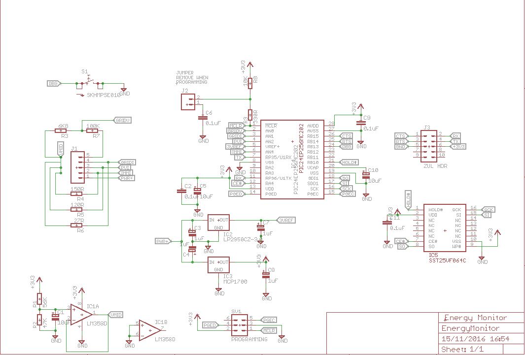

I’ve a Microchip PIC based electricity monitor that’s been running for 2 years. Now I want to add gas meter monitoring. I’ll probably have to redesign the PCB, and certainly make firmware changes, so I’ll have to do extensive testing of the upgraded monitor side by side with the existing one. The accuracy on the existing monitor is good, about 0.1% on the PV line, and I don’t want to lose any accuracy on the ongoing measurements while testing the new monitor.
There are 4 sensors, three CT sensors on the grid, PV and immersion heater circuits, and one AC voltage. It would be easiest to connect two separate sets of sensors to the two monitors. However the meter tails for each circuit are short and each pair of sensors would necessarily touch each other. I suspect each transformer would disrupt the measurements of its adjacent one. Can anyone confirm this?
An alternative is to use only one set of sensors and split the output from each sensor into two, one to the existing monitor, one to the one under test. The sensor lines go to four ADC inputs on the PIC microcontroller. So each sensor line will be connected to an ADC input on two PICs, one on the existing monitor, one on the test monitor. I think this should work OK. Does anyone see any problems with it?

Without seeing the circuit diagram of the front end of your PIC, I wouldn’t like to say what, if any, interaction there would be. If it followed the configuration of the emonTx, you could share the c.t. between the two. Clearly you’d have only one bias network and one burden resistor active, and you’d share the burden voltage together with its bias offset with the (presumably new) second monitor. When you’d concluded the test period, you’d need to physically move the burden resistor to the new monitor to preserve its calibration (because the burden is in the calibration chain).

This is the schematic from Eagle
The three CT inputs are on the left. The voltages across the burden resistors are between the mid point of the 3V ADC range and the sensor inputs.
However I hadn’t thought about the burden resistors properly. Only using one would mean I couldn’t leave both circuits intact while I’m testing, and calibration would be a mess. This approach will just not work.

Can’t it be made to work? You build Serial No.2 without burdens R4-R6 and without R3 & R7. Link J1-2, J1-3, J1-4, J1-5 & GND to the same places on S/No.1, then do what you need by way of testing. When you’re happy, you lift R3 - R7 off S/No.1 and solder them in S/No.2.
You could have temporary resistors on a spare plug for J1, along with the connection to VMID.
I’m assuming the software removes the bias offset.
