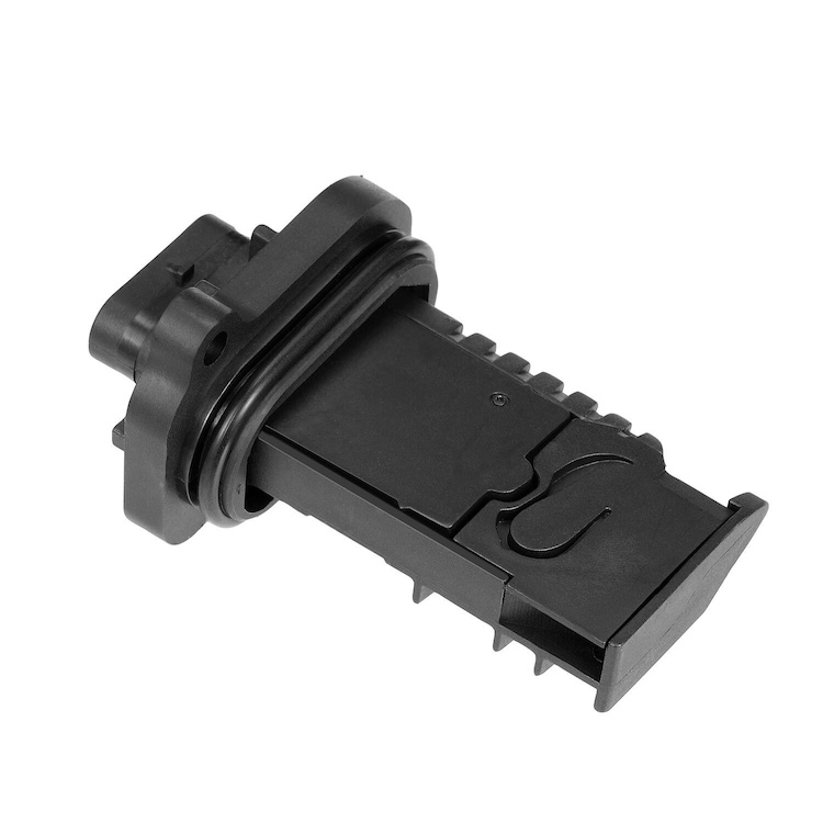

It occurs to me that the Mass Air Flow (MAF) sensors in modern fuel injected engines are effectively just hot wire (or hot film) anemometers. While some MAF sensors are integrated into a section of duct and probably wouldn’t be suitable, there are some which are just a sensor probe that bolts into an existing duct - something like this:
Many of those are much less than £100. I wonder if it would be practical to re-purpose one of those for MVHR flow monitoring?
