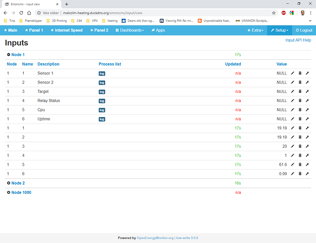

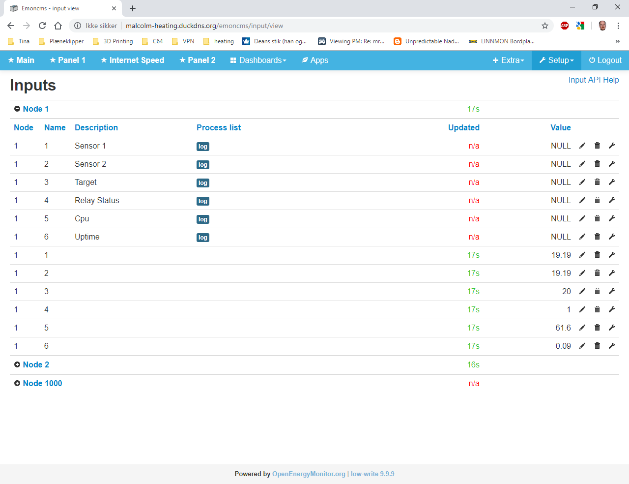

hmmmmm
for each of the 2 pi’s sending data i now have 12 inputs and now 6
and of course its not updating those that it used to
so now the question is why i have 6 new inputs? but it would explain why the feeds are not updated
Old rarely seen issue that has never been fixed.
Just delete all the second set of inputs, ie the one’s without processes.
If all your valid inputs have processes attached then you can simply use the input/clean api to delete all inputs with no processing in one hit.
http://server/emoncms/input/clean
oki… but should that one not be fixed if it can be fixed?
Maybe one day!
I have just added a link to this thread to the issue I opened a couple of months back so your comments can be found here (no need to add any further comments to the issue on github please, that is to keep track of cases and hopefully discuss the fix, not to discuss individual cases).
:smiley: thanks anyway
and should it happen again i know just to delete the extra inputs etc
