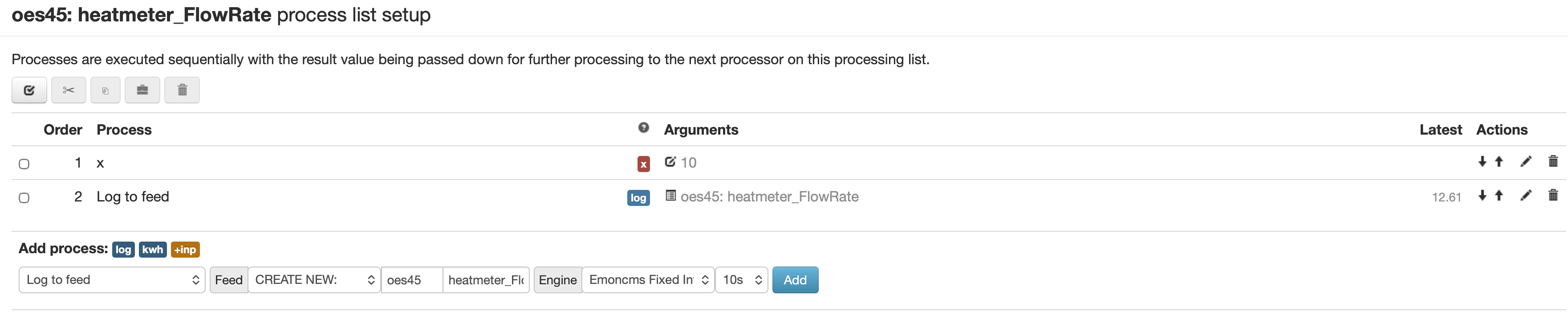

I think I have messed something up.
This process had process order with ‘x’ as order 1. I removed this by mistake and have now reinstated it. However, I have entered 10 in arguments field and not sure if this is correct. the dashboard shows a flow rate of 13 l/m. Is 10 the correct figure?
Hello @dmhom
It’s usually x16.67
m3/hr converted to Litres/minute x 1000 / 60 = x16.67
Thanks for the information.
