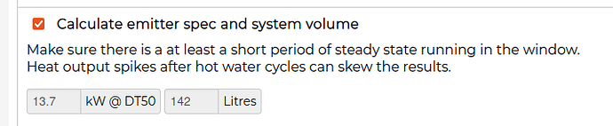

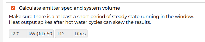

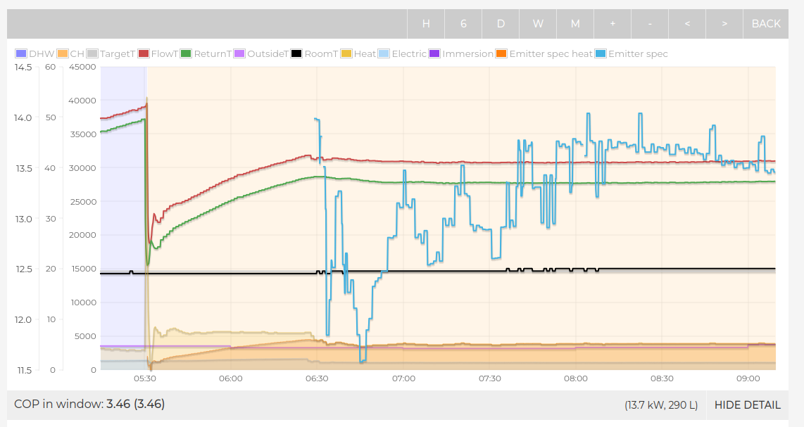

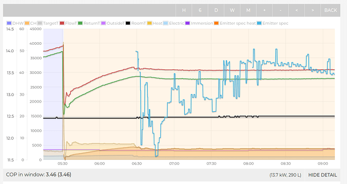

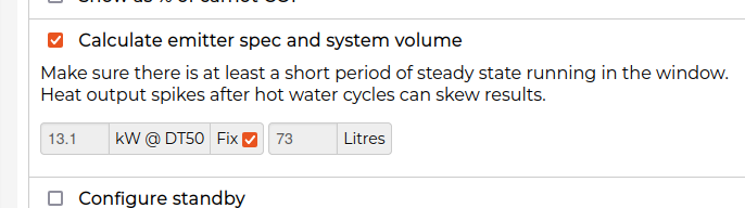

It really needs some way of filtering out the spikes at the end of hot water cycles as that really throws the result e.g 290L here.
I’ve added a little note on this and need for a short period of steady state running:

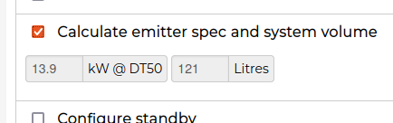

It might be helpful to add a checkbox to “Lock” the calculated volume radiator output so that it doesn’t jump around when looking at different parts of power graph. I have to go a loooong way back to find stable enough data.
Thanks @Timbones, do you mean to lock the radiator output spec?

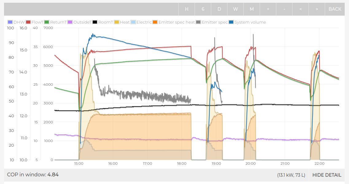

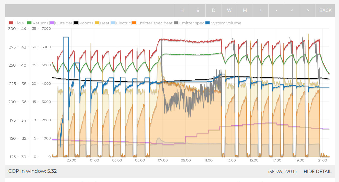

I’ve added a plot of how the calculated system volume evolves as it proceeds through the window, which gives a useful insight into how well the calculation is doing. As you can see in this example, there’s some errors early on that become smaller as time progresses, in other times you can see errors building it doesnt take long to see when a result looks more plausible
Sorry yes, I mean radiator output.
Hmmm, it’s still quite unstable at times…
This is now implemented and it works well.

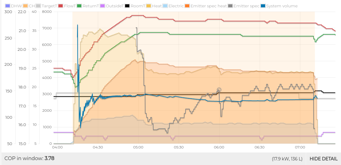

Latest version (note emitter size, and system volume printed next to hide detail):
The try fixing the radiator spec:
you can then zoom in on the cycles without steady state running e.g:

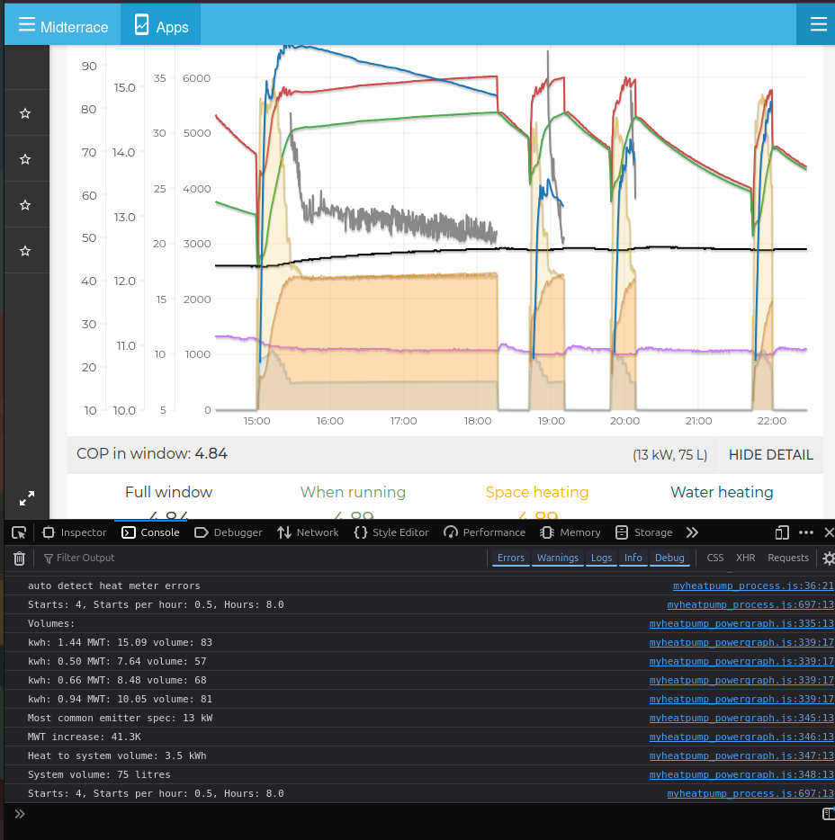

There’s also a bit of info in the development console, including the calculated volume for each cycle individually that might be useful for testing:

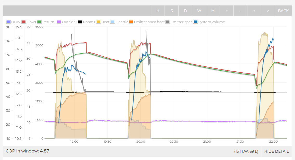

@ajdunlop I think you system has around 100L, what do you think?
Noting in the first post above that I calculated my system volume based on radiator volumes and pipe length to be 73L the results seem pretty good on my system.

It looks like I regularly lose 20-25% of my 100L capacity at the minute, I assume through the bedroom TRVs shutting off.

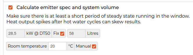

Would there be a way to add a fixed room temperature, so this calculation can work for those of us not reporting internal temperature via OEM? My house only varies between 19.5C & 20.5C during the heating season so I’d be happy to estimate from 20C. Or do you think this isn’t accurate enough?
Sure, added in:
Im not sure that it’s that reliable / accurate but maybe interesting to experiment with…

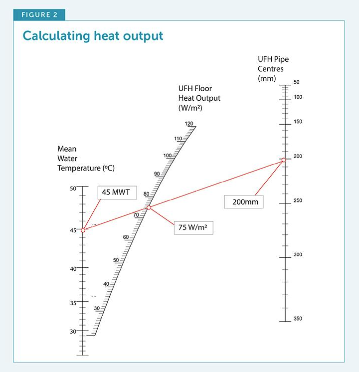

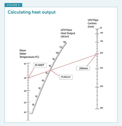

Another factor is the “n-coefficient” as defined by EN 442, usually 1.3 for most radiators. I’ve struggled to find a suitable value for underfloor, but one source suggests 1.15 with this chart.
On a related note, I found a spreadsheet that had 1.1 for fan coils and 1 for fan convectors.
