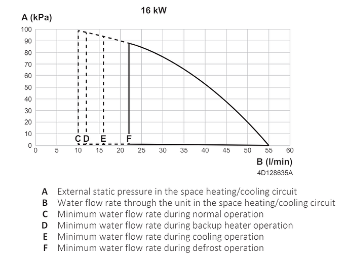

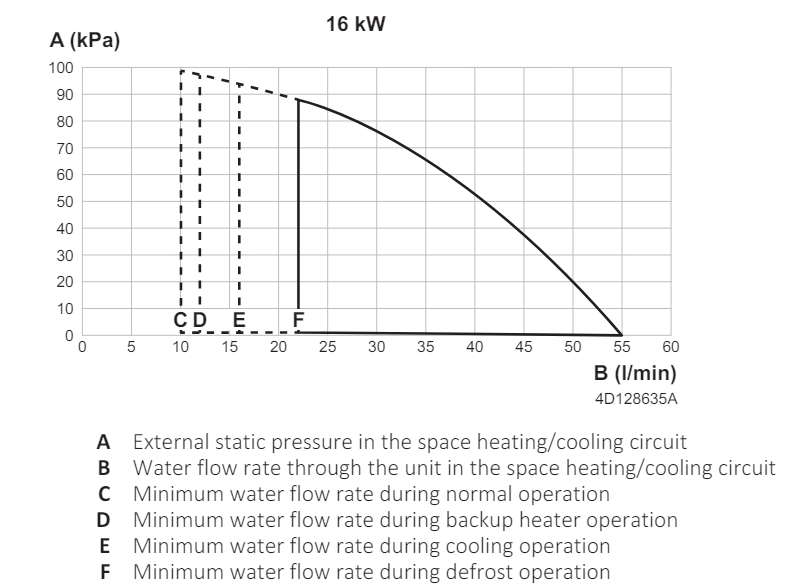

2b- Re-pipe the buffer as a volumiser in the return line. The problem that I can see is that maybe the Daikin internal pump will not achieve enough flow for de-frost operation due to the restrictive pipework. I have compared both the Daikin pump chart and the Pico pump:
Yonos Pico 1.0 30:
Daikin 16Kw EBVX16S23D6V:
The Daikin pump appears to be more powerful, so it should achieve better flowrate. At the moment, during cooling, the Pico screen shows 69W power consumption, which based on above would mean a flow rate of about 24l/min? Therefore, the Daikin should achieve more than that, but I do not know if I want to risk it.
