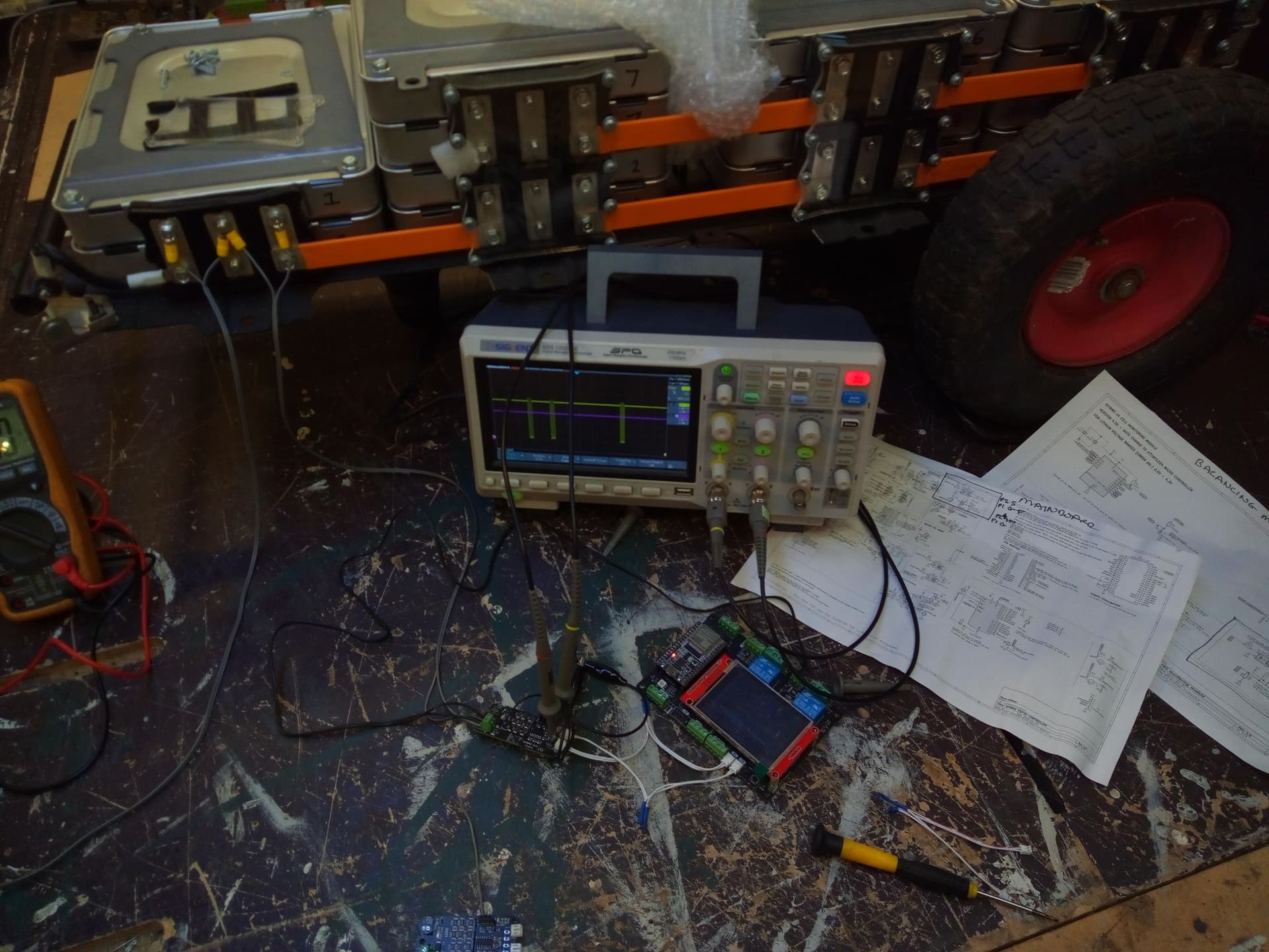

I am seeking help identifying why my build is not working. It is my first time building a pack with diybms and I’m hoping I’m just missing something simple because I’m a newB!
I am building a 7S arrangement, with version 4.5 balancing modules (57bf3f3) and version 4.6 main board (be885e1). When it starts up it reports software version d052e574 (2 Jan 2025).
At the moment I have just one balancing module and the main board hooked up in the serial loop. Is that an acceptable configuration for discovering the first module (don’t need them all)?
I have the TX port on the control board connected to the RX port on the balancing module by way of a straight-through JST cable arrangement, so that pin-1 of the TX port on the controller is connected to pin-1 of the RX port on the balancer. Then the return is the same (both cables are ‘straight through’ type).

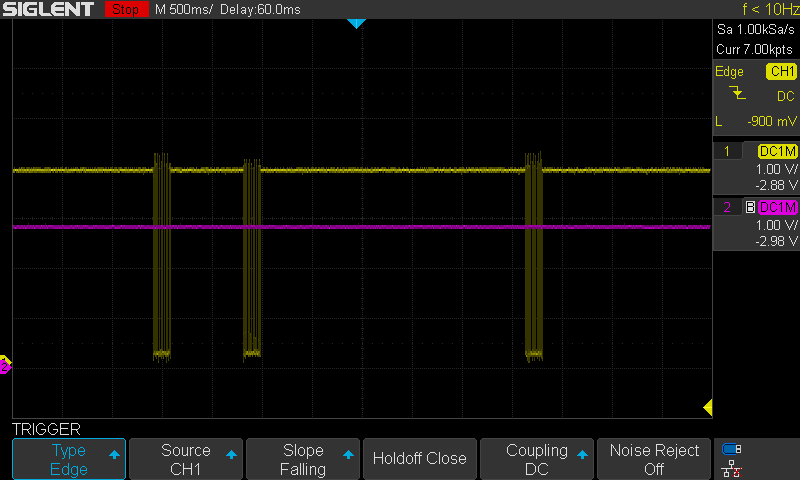

I have a scope attached to pin 1 of RX on the balancing module (yellow trace) and pin 2 of TX on the balancing module (pink trace). It looks to me like there is data coming out of the controller but no data coming out of the module. The controller continually displays “waiting for modules”.
I programmed the module using an updi2jtag programmer that I built out of an Arduino and the output from the programming session indicates that I successfully flashed them. When the module powers on it flashes LED D4 three times - does this indicate the correct code is running? I flashed them with module_fw_V450_10K_ATtiny1624_450_e0_h0_l0.hex

I will try and attach a scope grab and a photo of the setup. If attachments fail then the files can be viewed at the link below.
I also recorded this video the startup sequence where you can see the controller board send data on the scope (yellow trace):
Today I got it working and I am replying now to my own questions in case it is useful to anyone else reading this in the future.
My primary problem was that I had programmed the balancing boards with the 10K firmware not the 2K4 firmware and I did not understand the difference (it is comms rate related). Once I had the controller settings configured to use 10K comms speed and got it hooked up with two monitoring boards in series, I was in action.
Straight-through comms cables are indeed the correct configuration and yes the flashing of D4 three times on boot is normal and is an indication the correct sketch is running on the monitoring boards.
And finally yes that arvdude jtag2updi programming command was correct and the fuses must be good enough because it’s working :slight_smile:
