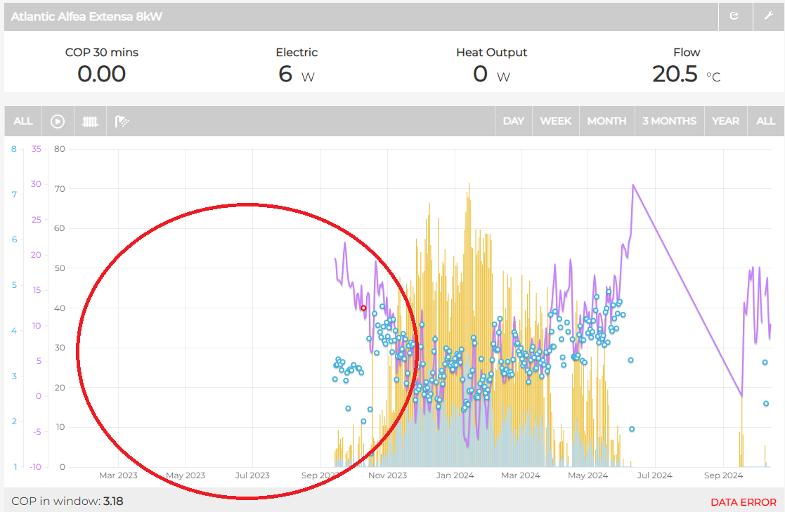

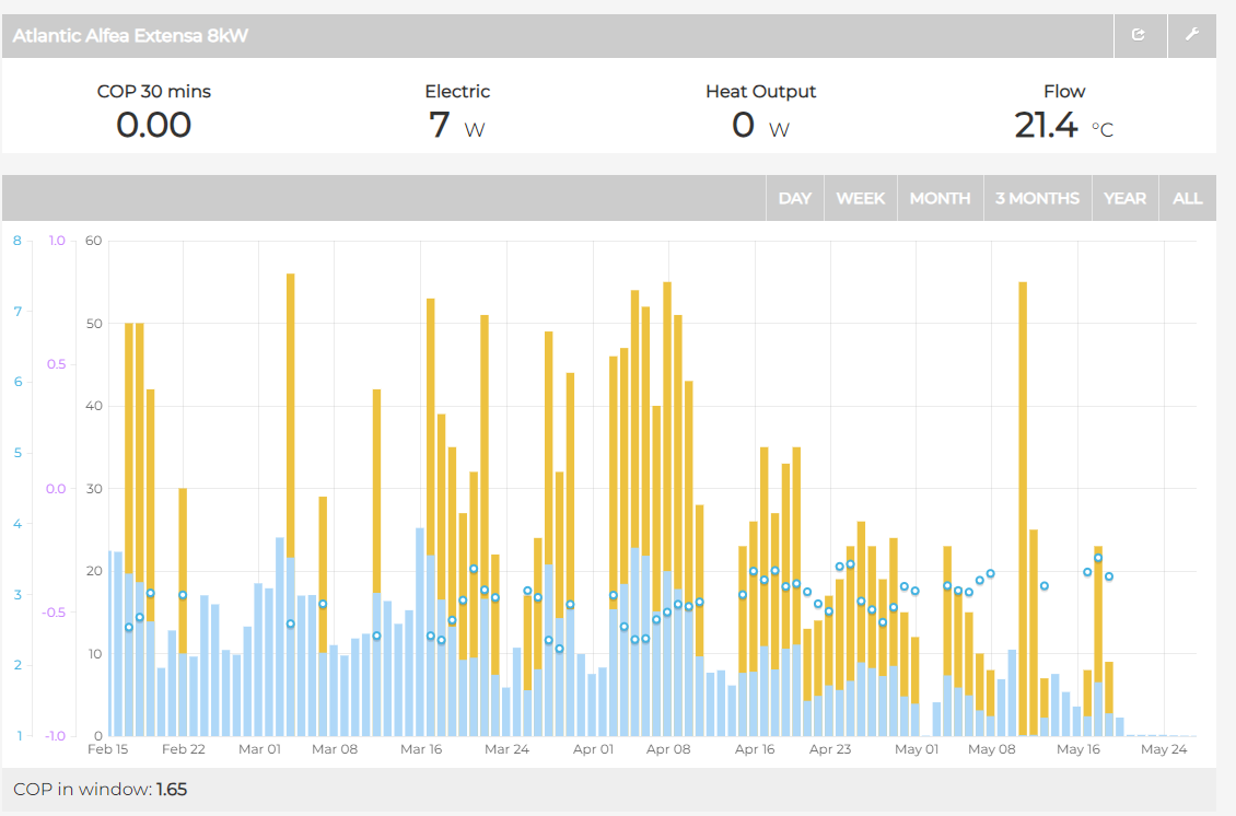

Hello. Does somebody know why im basic view I see only an year and a month of my Heatpump app data? If I go to dayview a pressing back button I can see also data before this period, which is available in feeds? Launch date is set to 0…
Hello @Ivailo_Stefanov the start date is set to 1671491620 on your system, If you set that to 0 and then reload stats and refresh the page that should do it.
No. This didn’t fix the problem, but when I uncheck the function “Enable daily pre-processor” i can see all the data I have. But other problems appear - I have days with missing heating production, although in day view it’s present.
Edit the URL in the address bar, changing /app/view to /app/cleardaily keeping all other parts the same. Go back to the original URL and it should recalculate the daily data for you. Leave the page open until it’s finished.
Ok. Thank you! That worked for me.
