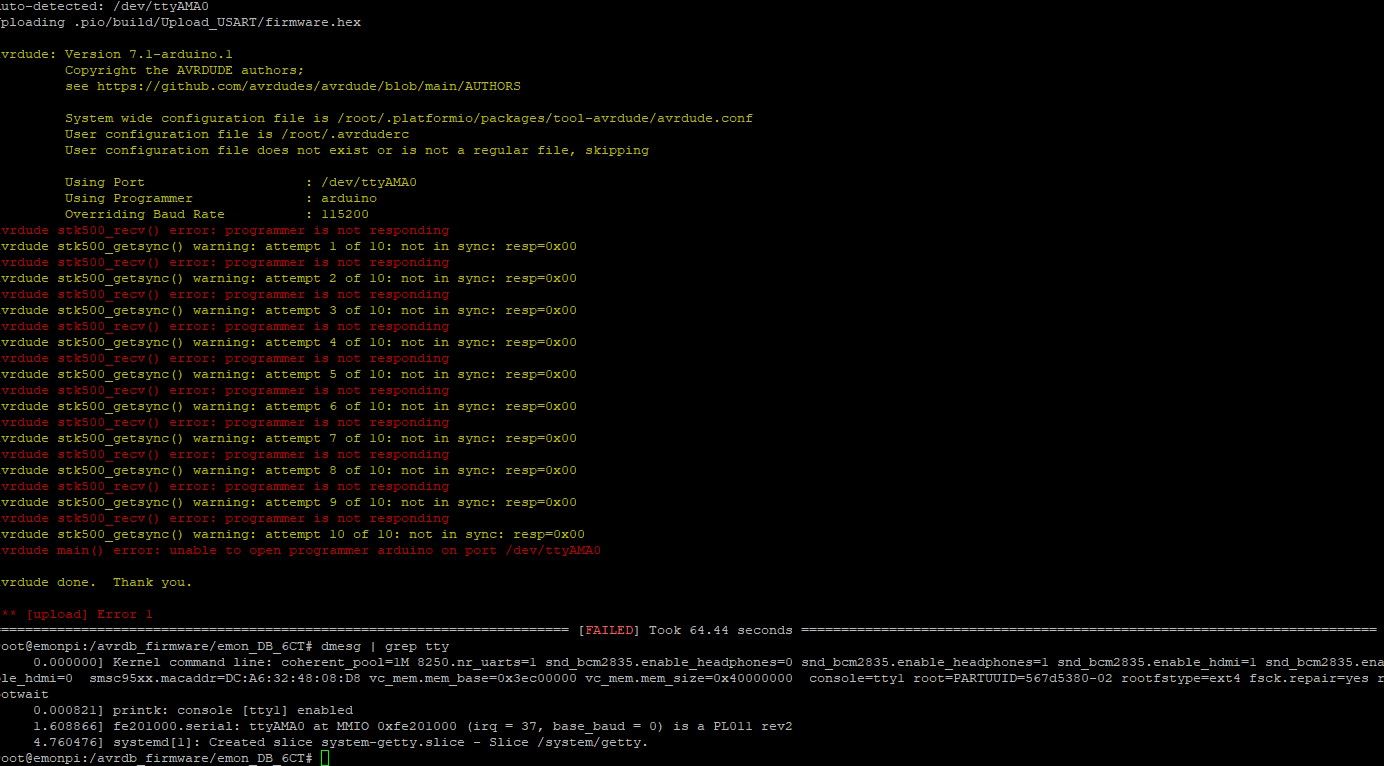

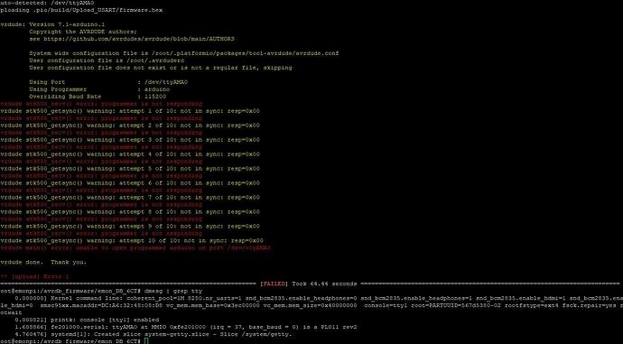

  4. When attempting to flash the chip it keeps giving the following error - programmer is not responding.
  5. I can see the device using dmesg @ ttyAMA0

I’m not totally sure of your specific hardware, but in general terms, to flash an AVR chip using the serial UART requires that the AVR already has a bootloader installed.

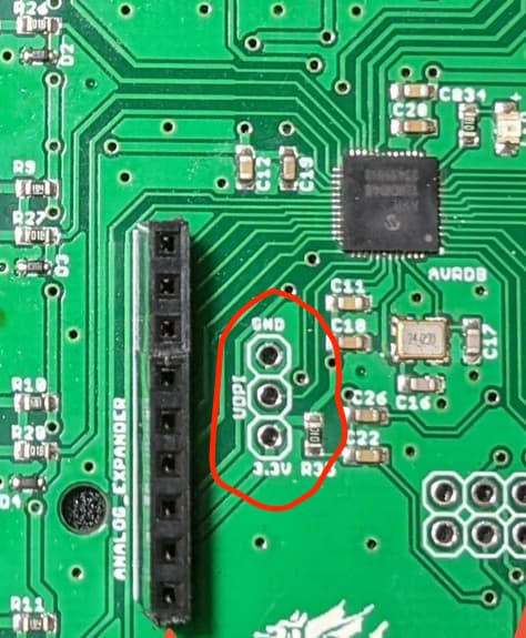

Oh, I forgot it was UPDI :man_facepalming:You need to populate the UPDI header on the Pi2 - it’s the 3x one next to the expander header, labelled as UPDI.

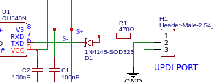

On the Pi side, you need to connect the UART Rx and Tx pins similar to that shown below:
The diode provides protection between the Rx and Tx pins. On that UPDI port, pin 1 would be the middle pin on the emonPi2 board.
