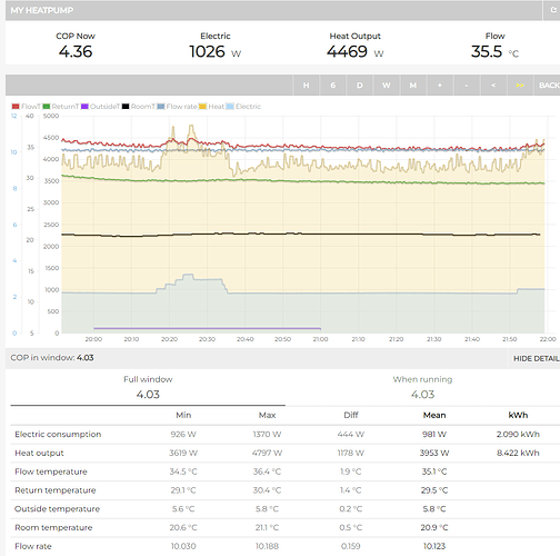

Hi Matt,
Here is a time window from Sunday with approx 10% higher heat output and COP. Inside temperature was very similar.
At this point, the heat pump was pushing above the target temperature.
I think it’s probably because the outside temperature was a few C higher, making the pump more efficient.
I’m not expecting epic COP values from my system, but would like to understand the differences between days. If I can consistently get another 10% performance, that’s worth it.
I’ve currently got a weather curve what’s targeting around 37-39C. Do you think I need that a bit higher with my radiator sizes?
I’ve been reducing the flow temp to try and avoid lots of defrosts.
https://emoncms.org/app?readkey=0e9ab50e73d8ae59d9e6dcc70e5dd5f7&mode=power&start=1706511240&end=1706522040#myelectric
Hi Jonathan,
I find exactly the same with my heat pump.
I get more heat at the same flow temperatures when it is warmer outside, not really what I want! It does also seem to be in the order of about 10% extra heat.
@ColinS helped me with this when I was running in a similar configuration to you. Go back through the `Thank you’ thread.
WDC and Madoka won’t help, they only work when you aren’t already running at the minimum output.
You need to find the flow temperature that gives you about 4 to 4.5kW of heat.
This heat pump should be at a COP of 5 at 7c outside and a flow temperature of 35c. As we know the minimum electricity is around 900w then we know we are aiming for 4,500w of heat.
Your radiators won’t be able to do that at 35c, I would expect you to need around 43c to get that heat output. I had to run at 42c fixed lwt with about 10% more radiator output than you have.
Your radiators should put out about 4,650w at a dT of 20c between mean flow temperature and room temperature. How much electricity this takes will depend on weather conditions in the main.
I would forget the wdc fttb and just run a fixed lwt and adjust to find what works best. Once you have done that it’s what you need to run at.
