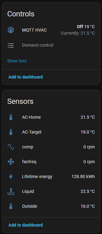

Hello.
I recently installed Daikin 8 kW air-to-air 4 way multi-split system. Through Faikin ( GitHub - revk/ESP32-Faikin: ESP32 based module to control Daikin aircon units ) I get the following in Home Assistant:
  • total energy consumption in kWh
  • outside unit ambient temperature [T_ambient]
  • refrigerant liquid temperature [T_flow]
  • fan rpm
  • compressor rpm
  • near indoor unit temperature (this swings quite a lot depend on liquid refrigerant temp)
  • Plus, I have a general room temperature sensor
Are my labels in square bracket correct numbers to use for?

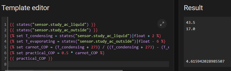

Hopefully I got this calculation correct?
But thinking about it, I don’t think refrigerant flow temperature should be used as input if the equation is designed for air-water HP. The water flow temperature in air-water will be lower, it has to go through another heat exchanger to get the heat from refrigerant. For air-air HP, may be the out-flow air temperature should be used?
For a multi-split system, how does one unit affect the other? Is overall COP a time-weighted average across all units?

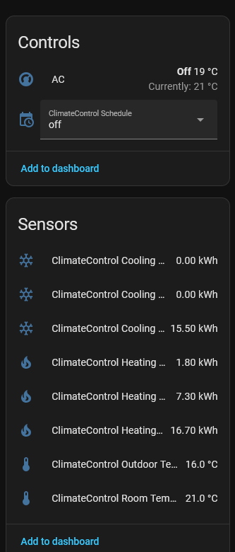

This comes from Faikin, similar figure can also be found in Onecta for each device split into heating and cooling. I only have whole house energy monitor, didn’t get a separate monitor for AC as there was no room inside my consumer unit.
Faikin exposed sensors via MQTT, there’s others that are disabled, either doesn’t apply to me or I don’t feel it is needed.
This is via Daikin Onecta custom integration, with a rate limit of 200 per day across one account (hence I got Faikin):
