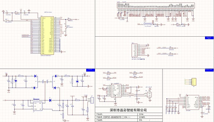

Hi there, i got another question,
As in the image, there are 4 pins, which are 5V, GND, RXD, and TXD. I wonder what the RXD and TXD pins are. I need to use it to communicate with another ESP/Modbus for my project; right now I can’t figure it out yet. Thanks!
yes you can use it to communicate with an esp or other device. it 5v so some esp do not like 5 volt only 3.3v you need a voltage converter chip unless your ESP has one built in already or you can use a io port and software serial they are 3.3 volt
Have you used the RXD and TXD pins here? I want to know what GPIO of these RXD and TXD is. I have tried 36 and 37 in the schematic, which is UART0, and it still didn’t work, or maybe when I’m using the serial monitor, it blocks these UARTs from transmitting or sending data, and I tried 43 and 44 from the ESP32 S3 pinout and it still didn’t work, or my step is wrong; you can let me know. Thanks again for your help!
I am pretty sure this esp32 does not have voltage converter chip on it so you have to add one… but it be better to make a software serial port on the screan using this port
or what ever it might be on your screen size.
then just have tx from the screen got to rx on the ESP32 and the tx on the ESP32 go to the rx on the screen and use the screen to power the secondary esp32 that what i do for mine. though i use esp and not esp32
Alright. Thanks for the answer!
