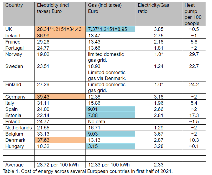

I have just watched the Resolution Foundation discussion as linked by the OP at the top of this thread. It seems the main concern is the very low installation rates of heat pumps for the middle to low income households (i.e. the vast majority). The BUS grants are mainly going to wealthy home owners in rural areas and take up by the others is being hampered by the uncertainty and disruption as well as cost.
Lowering electricity tariffs at the expense of natural gas is proposed and loans that are then repaid by future savings on energy bills may have to replace grants. Reducing delays with approvals and with more categories allowing air to air heat pumps as well as HT. More efficient heat pumps was mentioned only briefly. Using EPC was singled out as not fit for purpose and proposing heat loss measurements to replace it.

The presentation highlights some basic facts surrounding the lack of affordability of ASHPs in typical UK households. The uptake of ASHP is less than ~1% of the installed gas boilers in UK homes, even with a full BUS grant. The ASHP is still too expensive to install and operate for the typical household without other costly products (eg solar, battery storage for night tariffs, etc). The video highlights an excellent point to rebalance the electricity and gas bill levies. Unfortunately, the UK has the highest electricity/gas ratio in Europe. The UK has one of the highest electricity bills per kWh combined with one of the lowest gas bills per kWh in Europe. See the table below. The present electricity/gas ratio is 3.89. You would need a very good SCOP approaching 4.0 to be notably cheaper than a gas boiler. The present UK energy market appears to have an uneven playing field compared with other European countries. If the 16% levy on electricity bills was swapped with the 4% on gas bills, then the Electricity/gas ratio falls to 3.09. That makes it notably cheaper to operate an ASHP compared with a gas boiler. In my opinion, a rebalanced UK energy levy is needed to help increase the uptake of ASHPs in the UK. It still does not address the high up-front cost of the ASHP, or the UK government policy decisions surrounding the phasing out of gas boilers for new builds or for future home sales.
