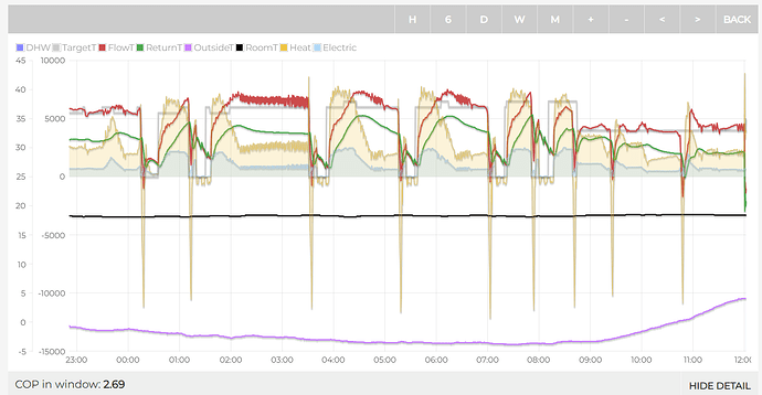

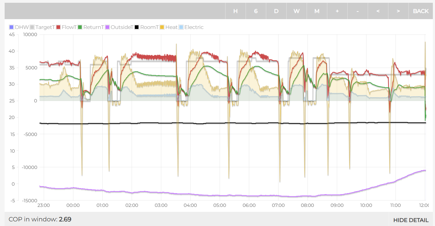

have you missed one of your pictures to show the differences

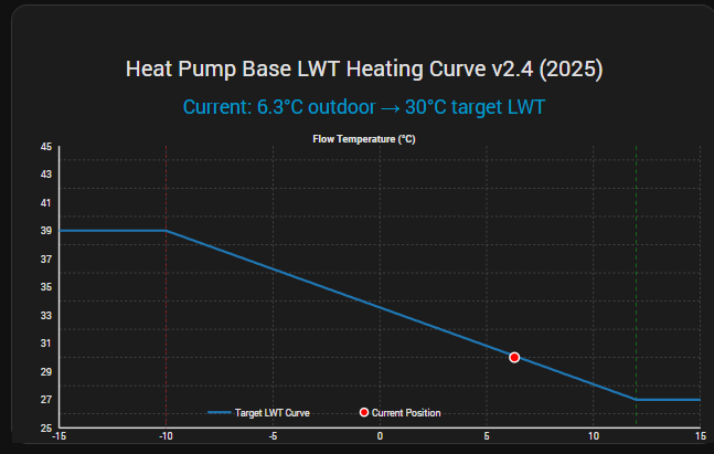

no that chart shows the cycle before and after the defrost. dropping the LWT helped keep the heat output lower, which hopefully reduces the work for the compressor.

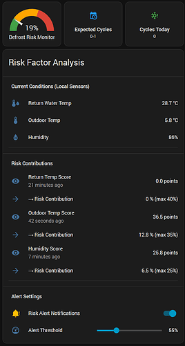

I’ve also been letting AI chew through a CSV log file I’ve been keeping for the heat pump and its come up with some thoughts. Its thinks my defrost issue is actually caused by the return temp rising over 33C, a low delta, which combined with outdoor humidity and temperature, raises the defrost risk.

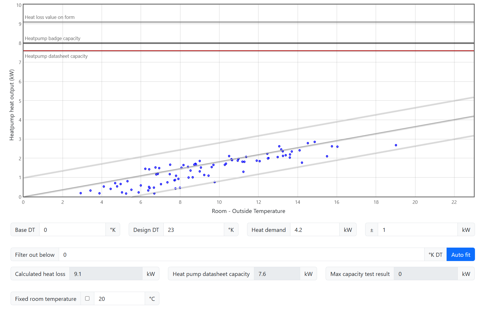

The issue I have is I still have radiators sized for an 11kW Daikin and a heat loss of 9.1kW, when my actual heat demand is 4.2kW and have an 8kW Daikin. This means I can run at very low flow temps but consequently a very low delta between flow and return.
The AI agent has suggested keeping my flow target at no more than 39C, which should keep the return less than 33C for about 95% of the time.
39C shouldn’t be a comfort issue as the only time I feel like I need more is with a strong easterly wind, which I can deal with differently. I had bumped it up to 43C at the cold end
Lets see if its suggestions help.

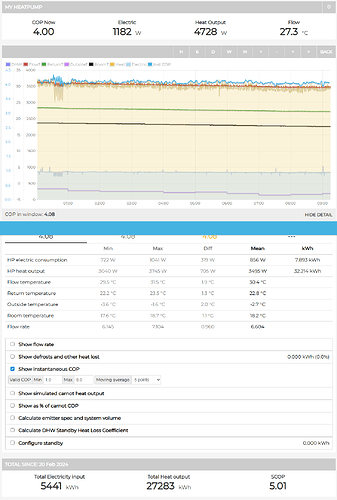

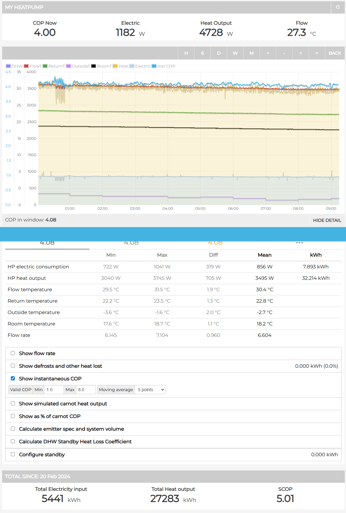

Here is my current LWT, live data.
My heat loss was calculated at 9.1kWh and an 11kW Daikin was installed. Actually I was told I needed to fit an extra 2kW plinth heater in the kitchen as the 11kW Daikin may not be able to cope at times. I didn’t go ahead with the plinth heater. Later the 11kW was swapped for and 8kW and straight away was more economic and comfortable to run.
Wind direction plays a huge part in my heat loss, with an easterly wind (1920s solid stone) needing a very different curve to westerly winds (2024 built extension.
The algorithm used to calculate the heat loss and radiator sizing just didn’t work well for my house.
Here are the radiators
The warmest room in the house is the kitchen, despite according to the survey being massively under radiatored according to the survey.
This is the resulting heat demand since March of last year
I think its fair to say the design was poor for the house.

I was just looking at my defrosts today.
Each one consumed about 35W of electricity and took about 300W of heat from the house and lasted for around 5 minutes.
That’s very gentle.
I am very happy with how the 8kW Daikin family performs.

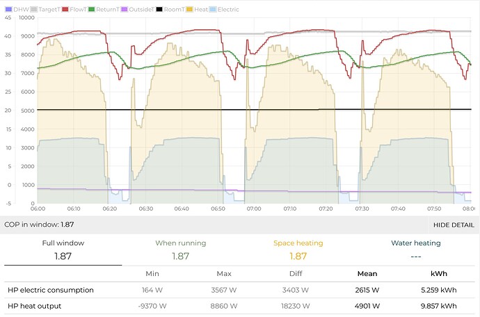

The issue I’m having is a 5 min defrost is followed by 45 mins of really aggressive operation, with the heat pump practically running flat out consuming 2KW+, then going back into defrost, it just doesn’t get a chance to drop back to it’s steady state consuming around 5-600W.
This has some knock on effects.
My battery which normally lasts most of the day can be exhausted before lunch.
The constant flat out for 45 mins then off for 5 is causing thermal shock in my pipes, meaning frequent clicking, creaking and banging, which in turn is keeping us awake. Fyi, we have tried addressing the plumbing but as yet no plumber wants to know. We have another coming to look on Wednesday.

This is mine this morning.
You should be able to achieve similar results.
You have a similar heat loss to me.
There is no way this heat pump will consume 500 to 600W in these conditions, you are dreaming :slight_smile:
What flow temperature are you running at these kind of outdoor temperatures and what heat are you producing?
Yeah, in these conditions your steady state is going to be at least 1kW at 0 and 1.4kW+ as it was earlier at -3 to -5. Even if you achieved a reasonably excellent COP of 3 at -5 you’d still only be looking at a 4.2kW output with a 1.4kW input.

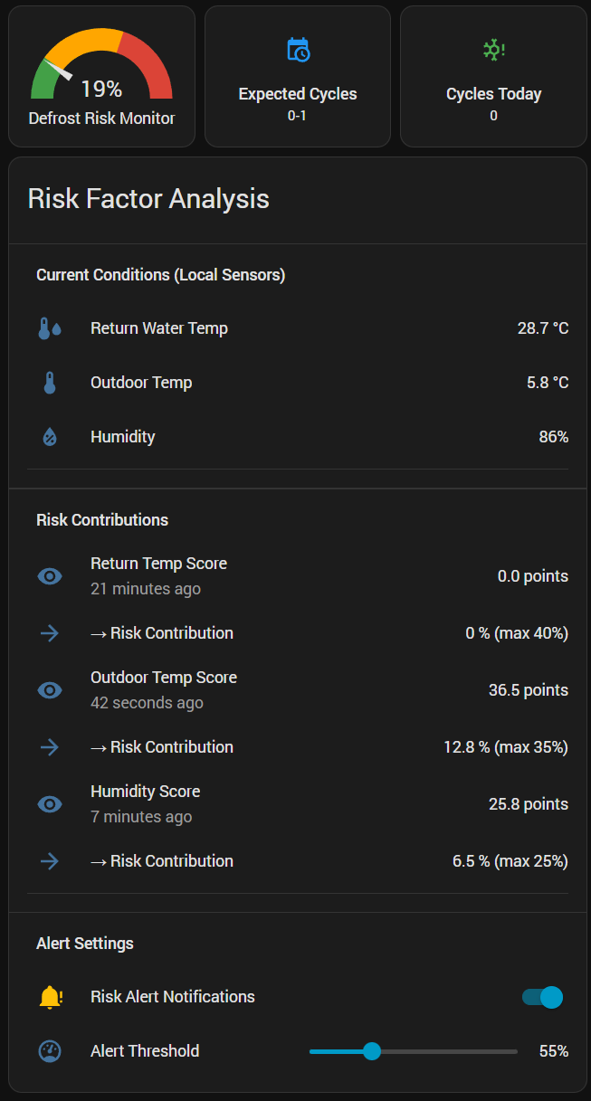

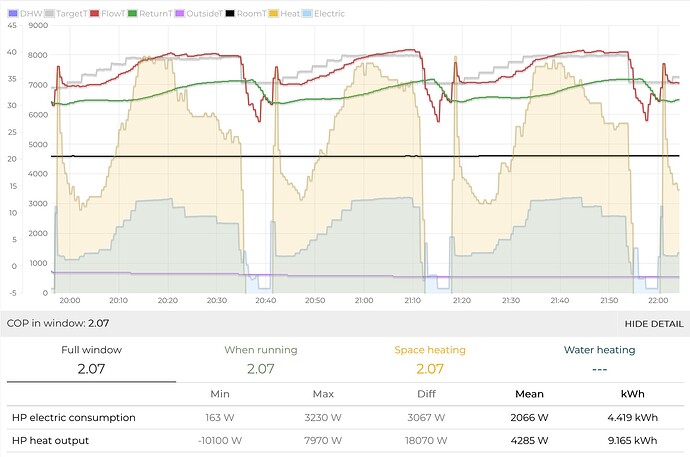

Interesting topic! I decided to try this out and with some help from Gemini, came up with an automation that drops the LWT by 5c and gradually ramps it back up over 15 minutes. The results are limited (because I forgot about the Onecta API limit and ran out), but over a two hour window and comparing it with a similar two hour window earlier that same day (where TargetT, OAT and ORH% are broadly similar), it appears to have reduced defrost cycles and increased COP by 10%.

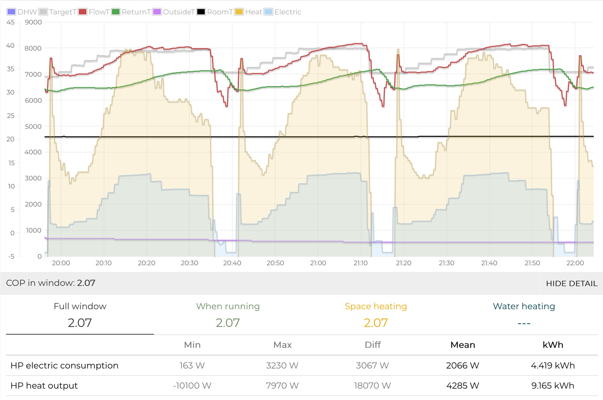

Before:

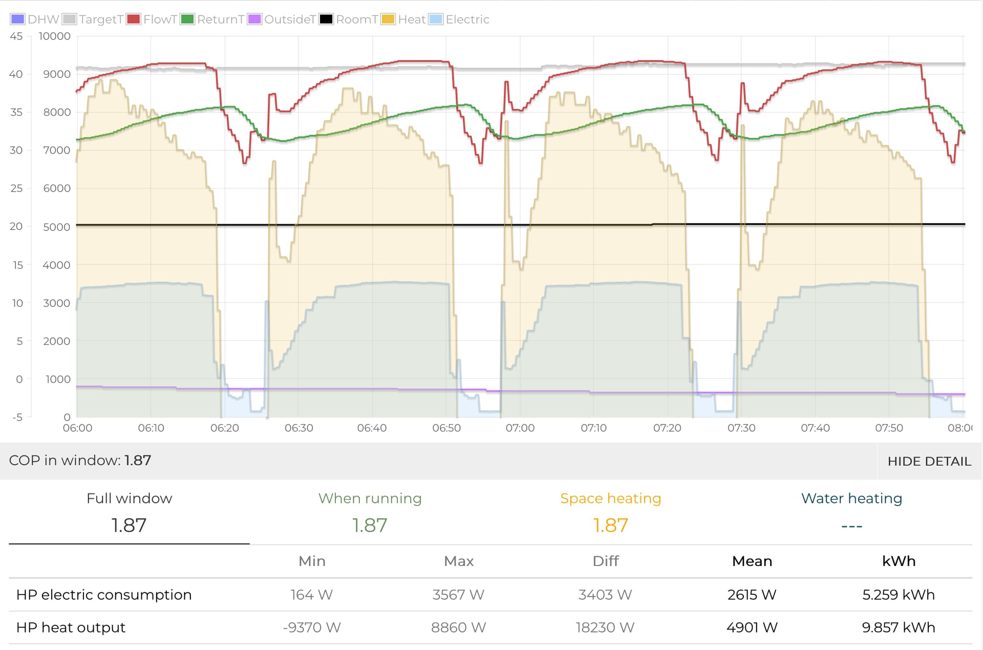

After:
You can see input power has reduced, both in kWh and also mean/max.
Of course, heat output has reduced as well but this doesn’t appear to be at any cost to room comfort. I think what we lose in heat output by slowly ramping up, we regain later by losing a defrost cycle.
Unfortunately, I couldn’t test for longer as I ran out of API calls for the day and now the weather is warming up but I thought it was an interesting experiment building on the working @Chris_Hill and @Mld were doing. I’m going to keep running like this and see how it goes. I’ve now turned off automatic API polling of the Onecta integration since using ESPAltherma means I don’t need any info from it regularly and hopefully that’ll stop me running out of API calls.
