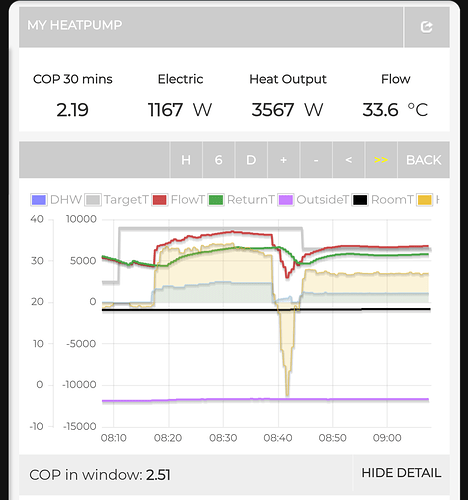

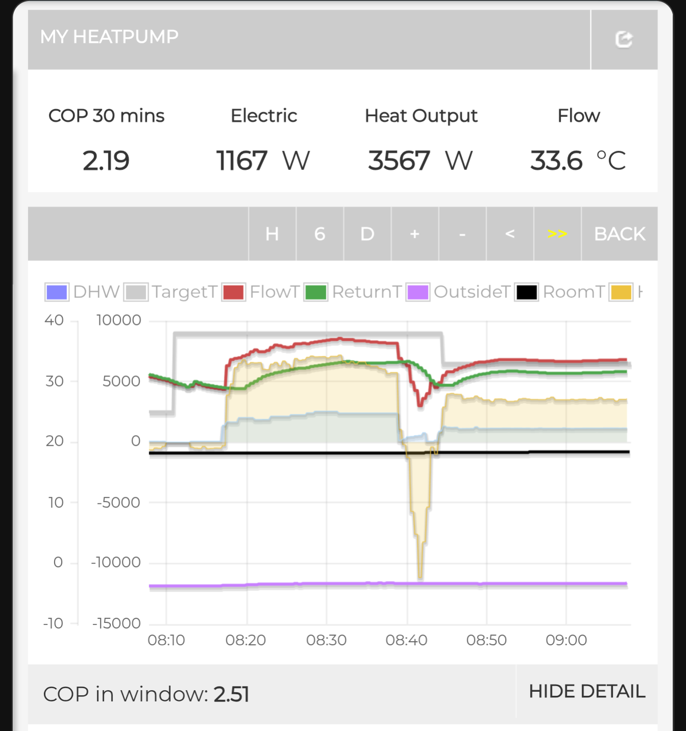

I’ve had some good success using Matt’s advice from this thread to reduce my defrosts. I basically increased the delta from 4 to 8 and it’s made a huge difference. It’s been running since 2:00 this morning now with no defrost and no cycling. Holding the target flow temp much better too. Made the change around 22:00 last night. Thanks for the great advice Matt!
Must admit, I’m a bit baffled as to why increasing the DT results in fewer defrosts and less cycling (by the looks of things). I would assume that an increased DT also results in lower SCOP as the flow temp has to be increased to acheive the same leaving water temperature. @agileoctopus which system is yours on HPM I’d be interested to have a look? I’ve got a 6kW altherma currently.
Increased dT is a side affect of reduced flow rate.
It is limiting the flow rate that reduces the power on start up and that reduces defrosting.
The power is limited by the lower flow rate, that means the return doesn’t rise so fast and there is no need to overshoot the set flow temperature so much to keep the dT under control. Basically taming the aggressive start up of these Daikin heat pumps.

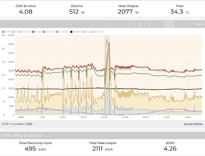

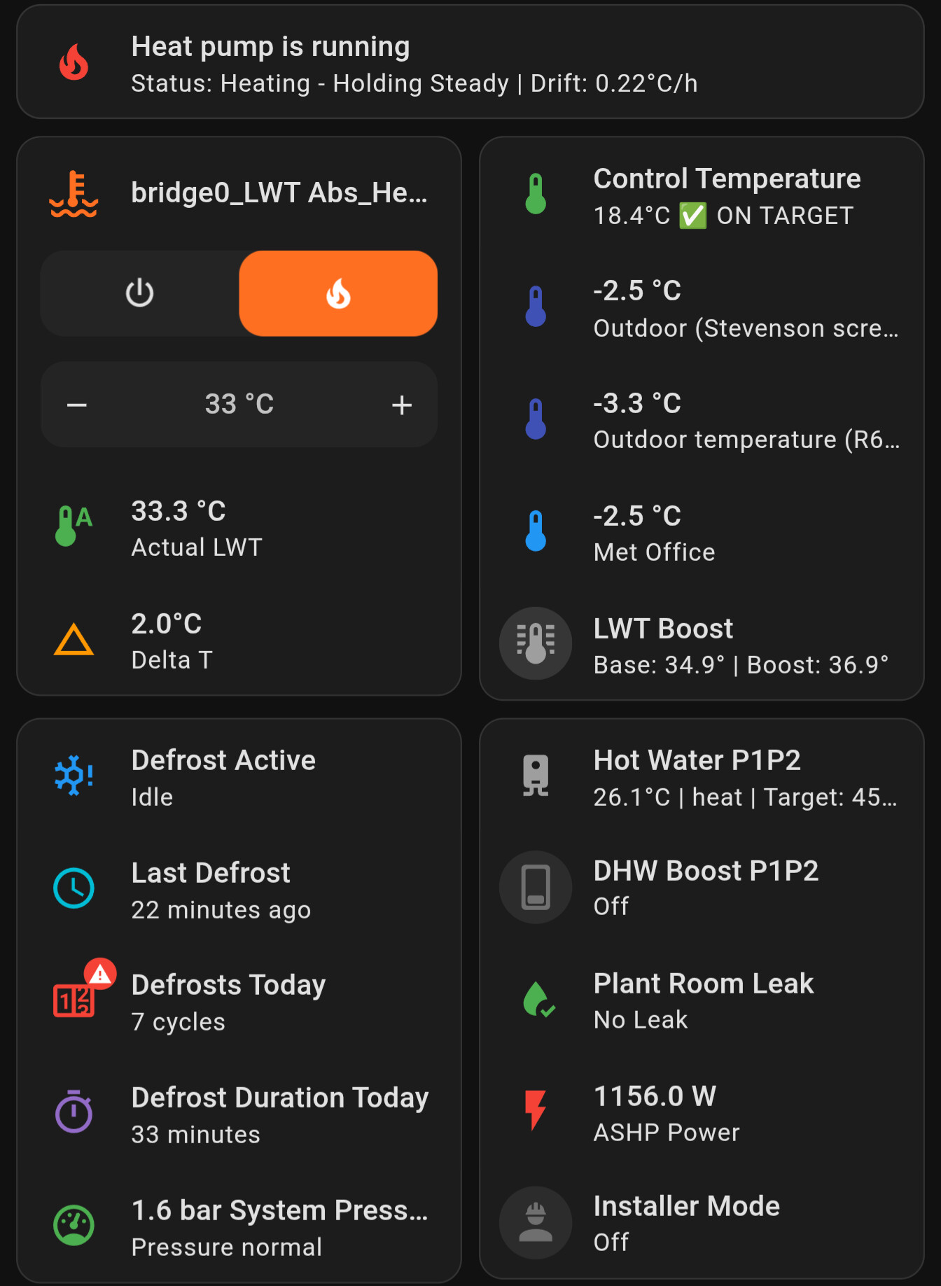

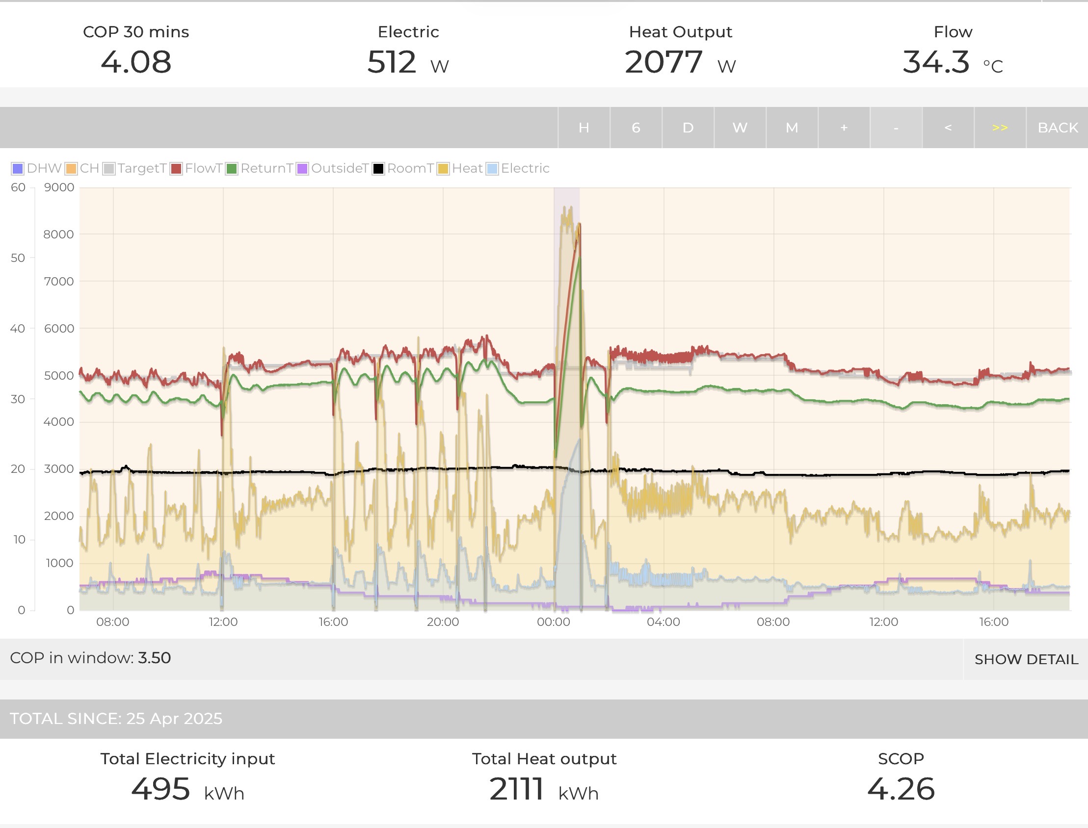

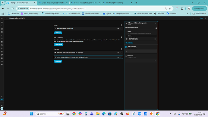

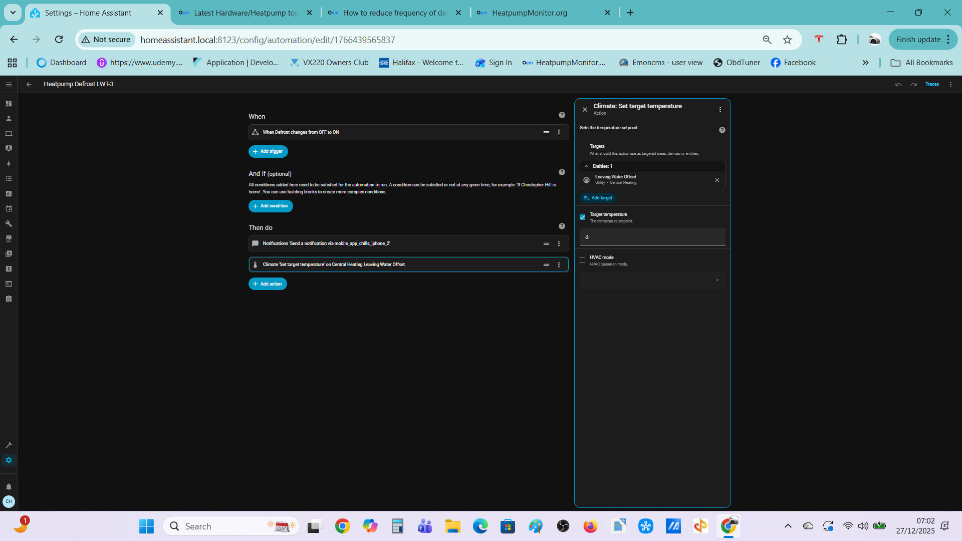

Doing a few more experiments to try and reduce the defrost cycles further ,
when a defrost cycle starts i have automated the LWT to reduce to -3 to reduce the load on the heat pump straight after the defrost cycle
i am not suffering as much as last year so all the above techniques definitely help
i am using other LWT automations to fine tune the weather curve dependant for solar gain and home occupancy so eventually the LWT will come back to where its needed (details below) but will reduce load on the heat pump for long enough to delay the defrost cycle further (i hope )
Also trying 5C below the curve.
Before and after
