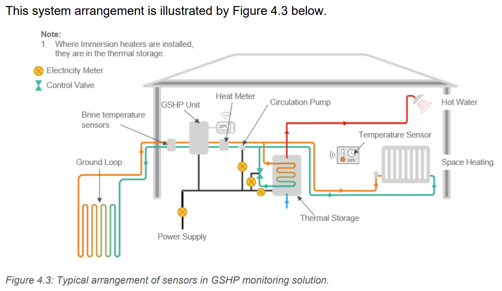

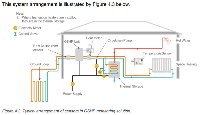

I am looking through the EOH data and am confused by the meaning of some sensor positions:
The figure for the ASHP sensor placement suggests that the heat meter was installed on the refrigerant lines, while for the GSHP the heat meter is installed on the water line.
Do I interpret it correctly, that the Heat Pump Return Flow is supposed to be measuring the refrigerant line that is coming from the condenser outlet while the Flow Temperatures are measuring the water lines inside the house?
If that is the case, is the ASHP figure missing a heat meter on the water side?
In turn, assuming my interpretation of the Heat Pump Return Flow measurement is correct, how is the temperature measured with the heat meter for GSHP?
GSHP:
Source: https://es.catapult.org.uk/wp-content/uploads/2023/03/EoH-Interim-Heat-Pump-Performance-Data-Analysis-Report-1.pdf
