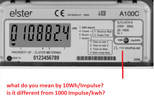

Meanwhile, I got a quick question regarding UK meters (1 pulse = 1 Wh), i think you are referring to Elster meter A100c. I mentioned my question in picture! Will really appreciate if you can throw some light on it…meter

10Wh/Pulse is the same as 1 pulse / 10Wh which is an order of magnitude higher resolution than your most sensitive setting above of 1 pulse / 0.1kWh (i.e. 1 pulse / 100Wh).
1000 pulse/kWh is the same as 1 pulse per Wh which is an order of magnitude more sensitive again.
The pulse duration setting is unrelated to that. You should set that long enough (50, 100, 200, 300 msecs) to ensure that your pulse-reading h/w can detect it as a pulse. An inevitable side effect of that setting is to limit the maximum pulse rate. But even at the meter’s most sensitive pulse rate (1 pulse per 100Wh) and longest pulse duration (300 msecs) it can still do one pulse per second which I think would require a 360 kW load, so quite a lot of power.
Thanks for the clarification, but on this meter why they have mentioned both things 10Wh/Pulse and 1000pulse/KWh. Can we pick any for real time energy calculation ?People recommend to use 1000pulse/KWh (ie. 1 pulse per Wh) not 10Wh/Pulse. Is there any particular reason?
I guess it’s convention or personal preference. It’s like asking why is vehicle’s fuel consumption sometimes given as miles per gallon in the Imperial system, and litres per kilometre in the metric system. Higher is better in the first, lower is better in the second.
Sorry, I missed that both markings were on the one meter. I can’t explain that. My only guess is that one overrides the other and they forgot to cross the other out.
