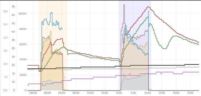

24

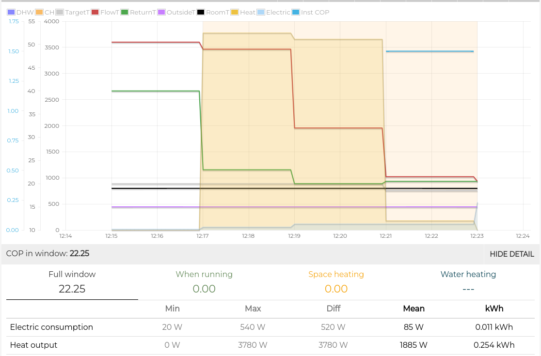

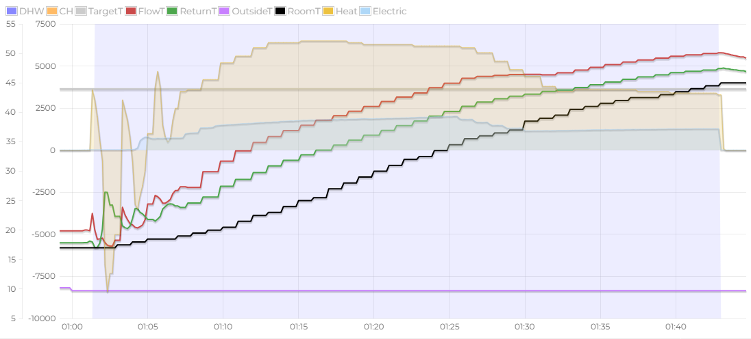

Watching this tread with interest as I try and work out where any of the inefficiencies of my system are.
I’ve found the following DHW run in coolish outside conditions but warm enough that there is no heating straight after (so any heat in the primary pipe work would be wasted):
Is there any way from this to work out what effect the primary ducts are playing?
We have about 5-6m of external pipework (quality of insulation install could be better) and about another 14-16m in the cellar (on this day it was about 16 C in the cellar and 9 degrees outside).
I assume the large first drop is the cold water from the primary pipework going through the flow temperature sensor and the warmer water sitting in the coil going through the return (looking like heat has been taken out of the system) and this would cancel out a bit as it all goes round the loop again and starts to stabilise as the HP adds heat.
It just looks like the first negative power output swings are very large compared to the positive ones.

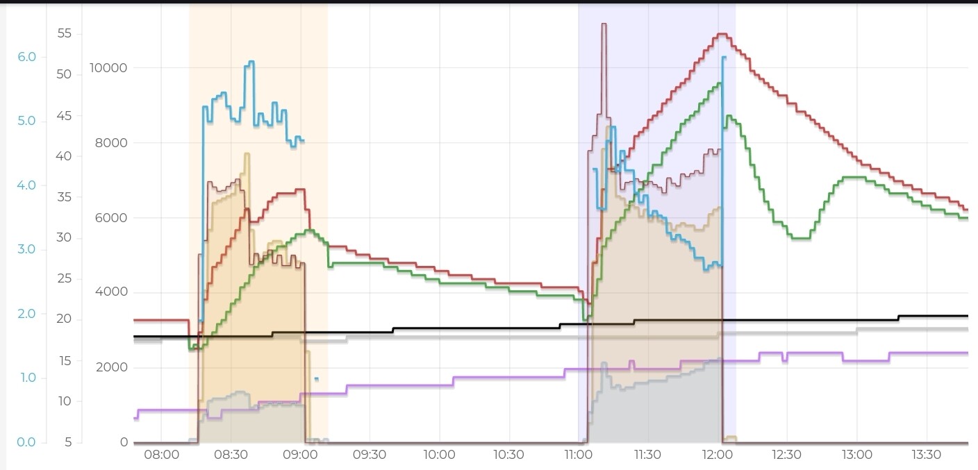

I’d caution against comparing only hot water cycles, as there may be other factors that affect the system efficiency.
For example, my system (#1) fits a carnot factor of 0.5 when space heating, yet can barely manage 0.4 during DHW. Not sure why, maybe it’s the plate heat exchange, or the different pump it uses, or maybe higher primary pump speed?
https://emon.cryosphere.co.uk/ashp?mode=power&start=1726469280&end=1726490880&carnot=0.5
How does the flow temperature affect the carnot factor?

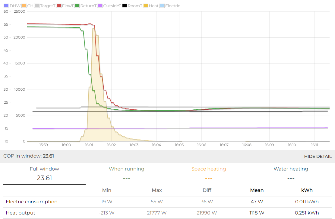

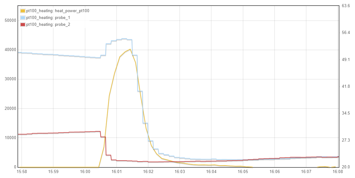

I was able to measure the “losses” of a DHW run in the primary pipes, i.e. the energy stored in them after the DHW run finishes. They get used in the cold season for heating or are simply lost in summer. My approach was this:
I have sensors on flow and return lines right after the hydraulic station on my Vaillant, which is where the 3-way-valve is located. Outdoor temperature was above the heating threshold, so there was no heating demand. I let the DHW cycle start and finish. At the end of the DHW run, I raised the heating threshold temperature so the heating would turn on. However, this does not turn on the compressor at the same time but just circulates the hot water contained in the primary pipes into the CH circuit - right past my sensors.
This would not work with sensors right at the heat pump, as these would not fully “enclose” the stored hot water. The sensors right af where the pipes enter my house register around 1/3 of that, the rest is stored within the pipes after those sensors.
Integrating that power peak yields around 0.75 kWh - around 12% of the total heat delivered during that DHW cycle. In other words, around 16 liters of water could be heated from room temp to 58°C (mean between flow & return temperature at the end of the cycle). Note that this does not include the energy stored in the primary pipes on the DHW side of the 3-way-valve. I guess I could calculate that based off the exact length of pipework, but I guesstimate the overall loss to be 20%, which sounds reasonable.

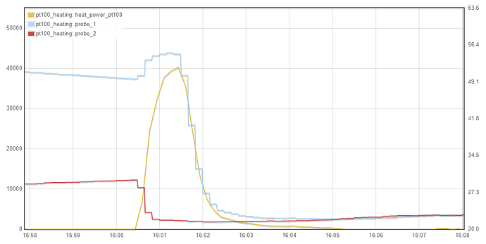

I happened to have a very similar situation with my DHW run today, followed by a little heating:
Resolution of the data isn’t as good, but the numbers for “lost” heat are almost identical.
Primary loop is about 20-something meters, most of which is between heat meter sensors.
I do wish the heatpump would just keep the primary pump running until the dT had dropped.
