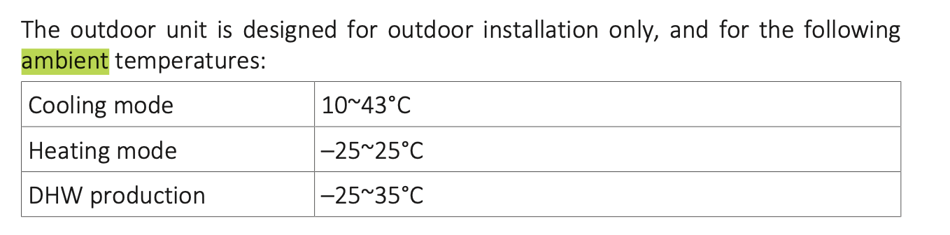

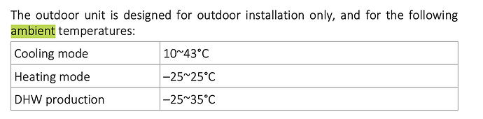

Looking at the EDLA08-04 installer reference manual, there is only this that I can find looking for “ambient”:
The only references to “ambient” and “DHW” in the Field Settings table refer to the limits of the WD curve you can set on DHW if you want. I assume you’re not using that?

Correct I’m not using WD curve. But interesting to see heating mode has an upper limit of 25.
Daikin’s brochure page 10 suggests an upper limit of 35c for both low and high capacity units. I can confirm my 11kw ran and topped up the DHW while it was 32c outside yesterday, according to it’s own sensor.

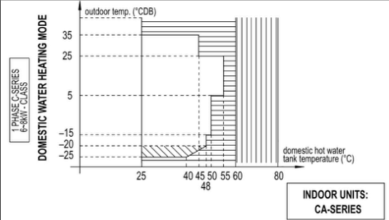

From Daikin;
With this hot weather you may notice that the booster heater / mixergy is coming on to do hot water,
With the small Daikin units E series eg 4,6 ,8 kw units and a ambient temp above 25deg the hot water schedule will use heatpump to heat tank to 45deg then booster heater will then take over and take it to cm setpoint, For ambient temperature above 30 +deg the booster heater will only come on
Things to check on site are that the booster heater is set to compressor off and that there is no booster heater schedule set ,as said above this only effects the smaller Daikin, so as the weather gets warmer you may see more booster heaters coming on to do hot water.
This graph shows when the booster kicks in. On the y axis is outdoor temp. On the X axis is tank temp. If we take 25 c outdoor temp for instance trace across you can see the line hits a hatched area at 45 c tank temp. The hatched area is when the booster kick in over the compressor at a given external temp.
