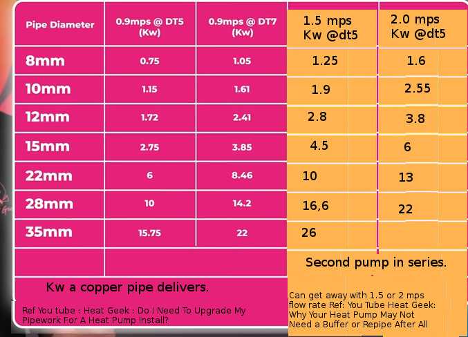

So, I thought I was being cunning at the time, but when I installed some external wall insulation about 5 years ago, we ran some 22 mm PB barrier pipe inside the (250mm thick) wall insulation to use as a potential ASHP future primary pipework. This was a late afterthought and done in a hurry. The pipes are surrounded on all sides by at least 100mm of insulation (expect where they pass through AAC blocks where and have about 30mm of coverage, n.b. the blockwork is externally insulated, so any heat loss to the blockwork ends up inside the building).
If I scrap the 22mm primaries, then I’ll need to run new 28 mm primaries for an additional 3.5 metres outdoors. I might be able to replace them in-situ, but the scheme I have for that might not work and would probably end up destroying the 22mm pipes.
Assuming the 22mm pipes are to be kept, then if I stick to the CIBSE recommended limit of 350 pa/m pressure drop for primaries, that limits flow to 0.66 m/s. Grant’s “Maximum Flow rate required” figure of 11.77 litres/minute (4.1 kW at 5°K ΔT) would result in a flow rate of 0.77 m/s. Reducing that to 0.66 m/s limits the output power to 3.5 kW (or 0.62 m/s → 3.2 kW if I go with the MCS recommendation of 300 pa/m instead).
I have not yet done an index circuit analysis, but can do so if that would help answer the question.
I live in a dense urban area and will almost certainly want to leave the HP in silent mode. I think that using “silent mode 1” on the 4kW Grant 290 gives a maximum power output of about 2.8 kW. I’ll slightly oversize the DHW cylinder to accommodate the longer recovery time, but the fact that the showers have 50% efficient heat recovery means that shouldn’t be an issue (since the practical hot water recovery time should be about the same as if we had the 6 kW model running in non-silent mode).
As well as the silent mode option, I think I’m right in saying that there is a Grant firmware option which allows both the max compressor speed and pump modulation to be limited, which would presumably allow capping the output at 3.2 kW or 3.5 kW (giving a bit more headroom whilst still staying inside of the head loss and flow rate limits).
Cost in time and materials of replacing them with 28mm pipes is about £300 to £500 (50% chance of having to run them a different route so that they have a worse heat loss).
I’m confident the 22mm pipes will be fine as far as delivering sufficient heat into the building.
In practice, are any installers or Grant (or MCS themselves) likely to be happy with that too, so that the BUS grant can be claimed?
What are the potential pitfalls (if any)? Defrost mode?
Does defrost mode pull heat from the DHW or heating circuit? I plan to run the heating circuit open loop, but at the very least I could leave some or all of the UFH permanently on - these are a mixture of pipe in 30mm conventional screed, and pipe in 125mm concrete slab. For the concrete areas, that’s about 8 tonnes of concrete, so no problem with thermal mass.

For your heat loss 22mm pipes will be totally fine. There would be zero advantage of upgrading to 28mm. Any decent heat pump installer will be able to do the calcs to satisfy themselves of this. MCS don’t care what pipe sizes are used as long as the system is fit for purpose. The Heat Geek pipe sizing chart is a useful quick reference, 22mm is fine for up to 6kW
Using 22mm actually has an advantage for DHW, since there’s less volume of water in the primaries to heat up before the tank can start heating up. I’ve seen many BUS installed heat pump with 22mm.
Defrost pulls from the heating circuit, if the system is open-loop this won’t be a problem. If the heating circuit is small, then fitting a volumiser can be a good idea, but you should be fine with the volume in the UFH and rads. Also, UFH has a lot of thermal mass, which is good for defrost.

For your specifics 22mm plastic pipe will certainly be able to carry 4kW of heat. I’m not clear exactly what the Maximum Flow Rate required of 11.77 l/m is. Our Daikin has a minimum required flow rate for defrosts and hot water of 12l/m however in reality it targets 25l/m when doing those things.
As long as your pipework is able to meet the minimum requirement specified by Grant then it will be good enough for MCS & BUS.

To add - slim primaries, if an issue is an easy fix. Run a primary and secondary loops, with secondary loop run via closed coupled tees. You need a secondary pump, but total Watts pulled by the two pumps is almost the same as one pump providing flow to the whole system. You run the primary and secondary pump at fixed flow rates, either match flow rates or secondary slightly slower than primary to ensure you get zero temperature distortion.
