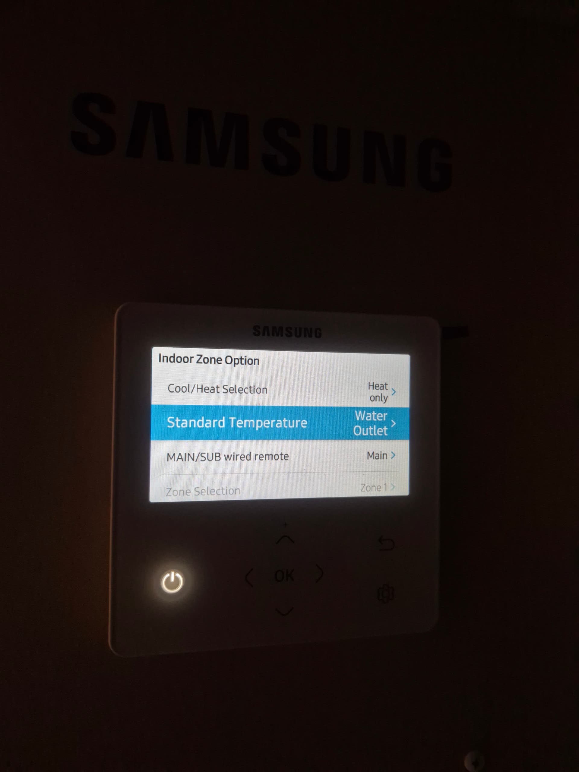

Samsung have added some new settings to the R290 units which helps with this, (but still isn’t perfect). I think it’s FSV 106*. With the homely controller, I’m running in water outlet mode, so I use 1061 to set a larger hysterysis to reduce cycling. Ive settled on 5.0, which means it’s looking for the LWT to drop 5.0 degrees below target before switching back on.
You can also change the thermostat hysterysis in here too, but I’m not sure if you can make it smaller than the default 2 degrees.

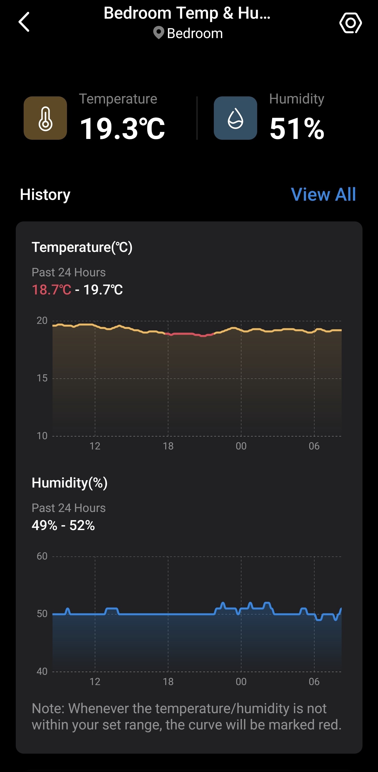

Here are some screenshots from my Tapo temperature monitors in the living room (where the homely stat is also located) and the bedroom. Both south facing. You can see it manages the temperature really well.
Just to note: I’m changing between Cosy and Agile a bit figure out which is best for me, but I think it’s fairly clear from the monitoring when I’ve been on Cosy as it targets the 3 cheaper periods alot more aggressively.

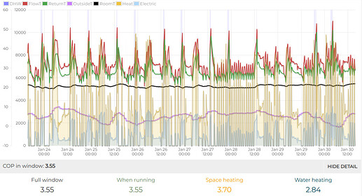

UPDATE
I have disconnected my Homely controller for last 6 days and reverted back to WL.
I wasn’t happy with the control of the heat pump with the Homely Controller. It was turning the heat pump on & off too regularly, and not working low and slow, like it should. Here are 2 screen shots, 1 from the last week before the Homely was disconnected, and 1 for the last week. Coincidentally, the mean average outdoor temp for both of these periods was 4.6 degrees.
Homely Controller
Samsung WL
You can see that my COP has drastically improved, even with an extremely cold snap last night.
I also simultaneously switched from Octopus Cosy to Octopus Go to make use of a cheaper overnight rate. (this coincided with changing from a PHEV to a BEV and needing to charge more than I used to) But even though I no longer have as many cheaper hours, I’m fairly sure it it costing me less money to run, and is more comfortable. I have been playing around with turning the heat pump off for a few hours at the beginning of the night, or simply reducing the WL curve by a few degrees over night from the controller home screen.
