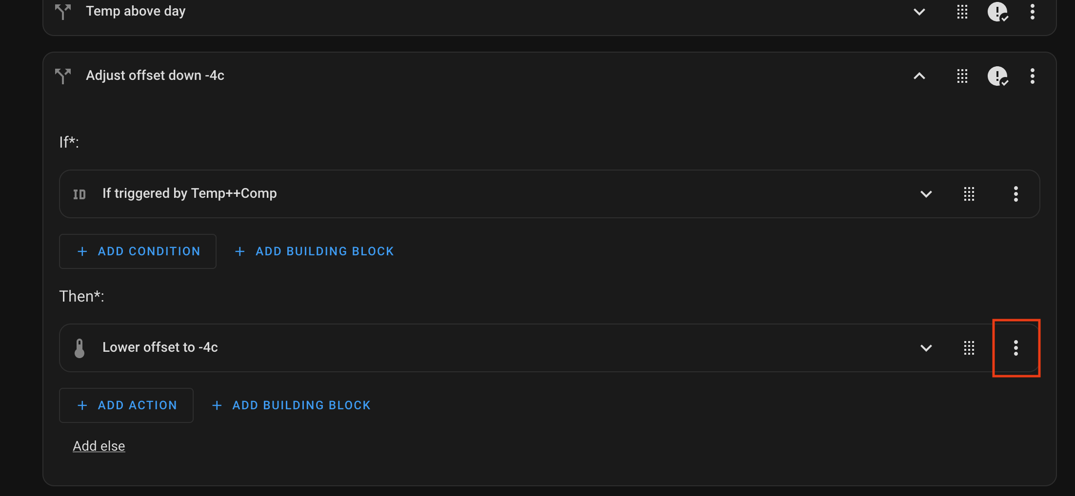

@chrisg thanks so much for sharing the automation. I’ve tried the following but cannot get the automation to run, even after restarting HA. Any idea where I’m going wrong?

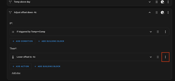

  - alias: Adjust offset down -4c
    continue_on_error: true
    if:
      - condition: trigger
        id:
          - Temp++Comp
    then:

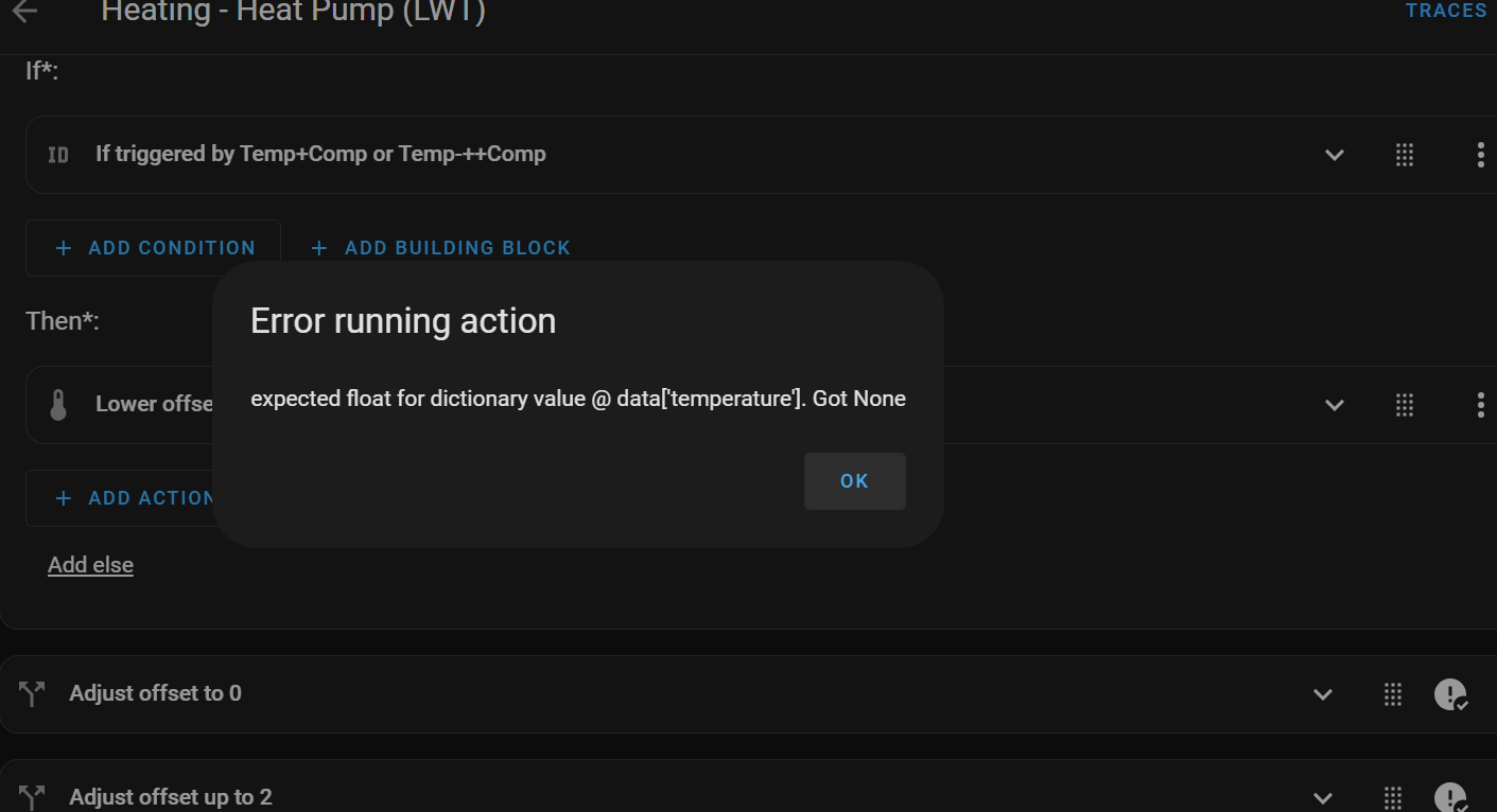

      - action: climate.set_temperature
        metadata: {}
        data:
          temperature: >-
            state_attr('climate.altherma_leaving_water_offset','target_temp')|float(0)
            -4 #}
        target:
          entity_id: climate.altherma_leaving_water_offset
        alias: Lower offset to -4c

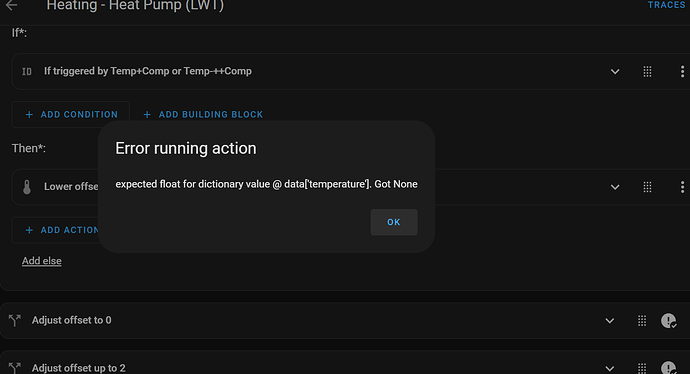

        metadata: {}
        data:
          temperature: >-
            -2 #}
        target:
        alias: Lower offset to -2c

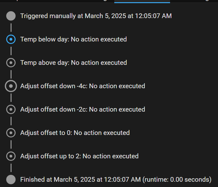

No worries. Firstly, in the automation list, does it show when it last fired, or was it never?
If never, that means none of the triggers fired which means none of the thresholds were crossed, either because the temperature didn’t change or the signal from the sensor didn’t reach HA.
If the automation did run, open it and check ‘traces’ to see what happened, which trigger was fired and whether an action fired as a result and ‘related logbook entries’ may help.
thanks, it last fired yesterday, but that when I manually the actions, however it didn’t change the LWT.
this may help too, seems like an error in the yaml:
Yes, a manual run of the automation won’t ever fire an action because all the actions fire based off the unique ID of one of the triggers. The design idea was to have one convenient automation that contained multiple triggers and multiple actions. So the only things that can actually fire an action are one of the triggers.
That said, you can manually fire the actions to test them. For example, in the ‘Then do’ section where the actions are, you can expand one of them, click on the triple dots as indicated and ‘run action’. This would test what would happen if the relevant trigger fired it.
Looks like you may have done that already and saw the ‘expected float’ error.
I see a difference in your yaml vs mine, for the two negative offsets, you have:
            -2 #}
but my code is:
{{ state_attr('climate.heating_leaving_water_offset','target_temp')|float(0)
    -2  }}
I think the issue is the two hash symbols (I was able to reproduce the error you saw), try removing those.
great thanks, not sure why those hash signs came from, so I have removed and was able to raise the offset by +2 degrees! Thanks again
