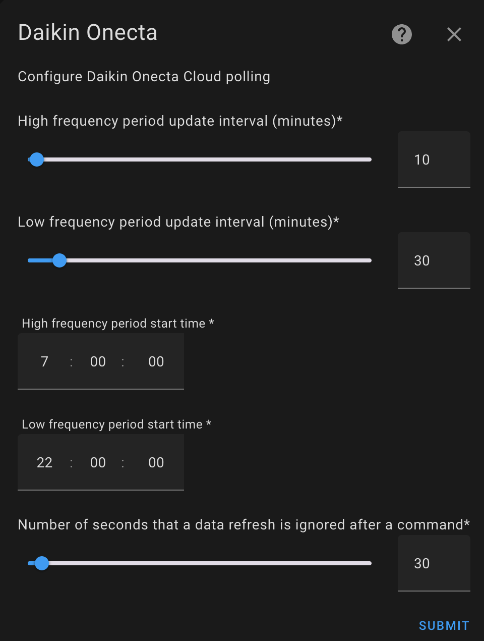

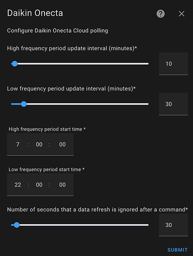

It all stopped working about 9:00pm…took me ages to figure out what was going on but I eventually identified the problem in homeassistant …
The Onecta integration had failed because of the poll count exceeding 200 (for the APIs). unlike the earlier integration that used to use reverse proxy access to the MMI, The latest and only integration is cloud-based and requires API calls but these are limited to 200 in a 24 period.
I had set , in the integration configuration, the priority polling to 5 minutes and the low priority to 10. I’ve now changed that to 10 and 20 respectively and will give that a go. I suspect because of this automation algorithm from @Chrisg, automation is constantly tweaking the numbers each of those tweaks will result in an API call.
Chris, Have you not run into this problem and what are your poll settings in the onecta integration?
EDIT @chrisg what is the purpose of the repeat for …on the automation. My climate device responds to demands with no issues… did you have a device that was temperamental?
Yes, before I installed ESPAltherma, I ran out of API calls polling too frequently. These are my settings today:
I typically end each day with at least 80 API requests left.
The API update values here do not influence how responsive your automations are - merely how often they’ll gather values for the various sensors they give API access to. Anytime your automation fires and requests and offset, it’s actioned immediately.
For reference, I typically have 10 or fewer offset adjustments per day.
WRT your earlier question - it’s not really an algorithm, just a set of thresholds I chose based off my own personal comfort needs balanced with keeping the heat pump running if at all possible but wanting to shut it down if, as we are these days, warming easily from solar gain. I worked out through trial and error what level of offset was effective enough to curb the heat trending upwards without inducing a see-saw effect. -1c wasn’t enough, -3c was too much, -2c seemed just right. YMMV, of course, but here, in this house, the thresholds and offsets I’ve chosen work for me.
Writing the HA automation was the easy bit. Getting the WD curve right to minimise offset corrections has taken basically all winter, not helped by finding the ABV was wide open a couple of months ago which resulted in no longer needing the lockshields closed down to balance - fixing those things changed how the heat was delivered requiring a slight tweak to the WD curve.
appreciate that, thanks, I’ve adjusted my polling.
