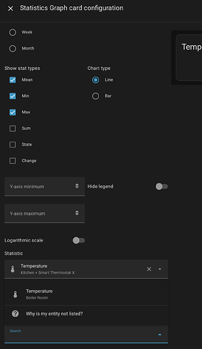

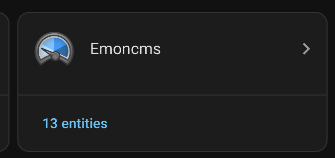

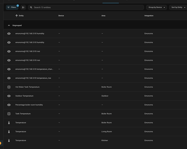

Hi Guys, I managed to get my metrics into Home Assistant and I’m trying to make some graphs. But none of the Emon values show up under the graph data. I’m assuming it’s something to do with the metadata of the sensors. I found some old posts about autodiscovery and editing YAML files. So is there a simple way to fix this?

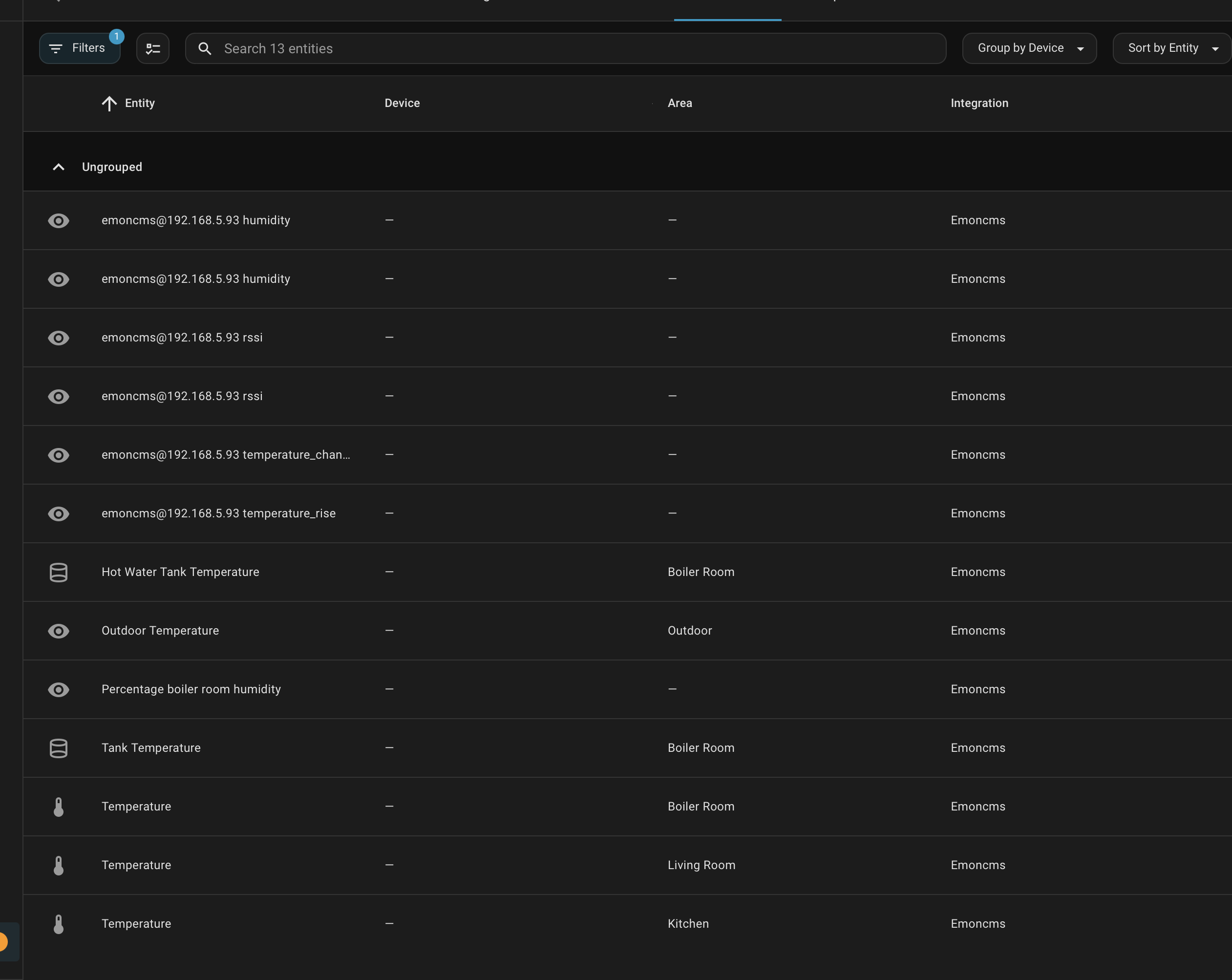

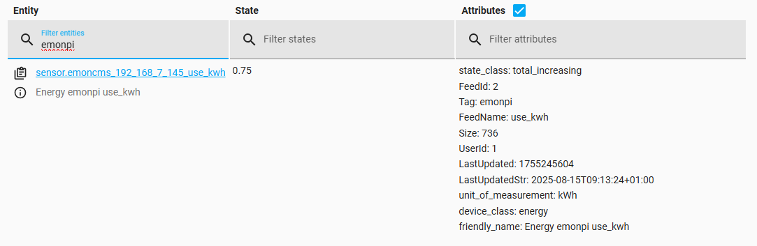

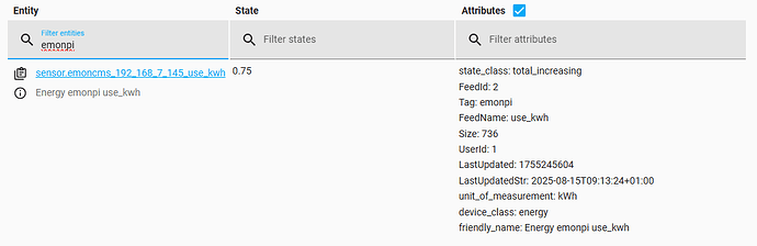

If you go into Developer ToolsStates and filter on your entities, you should see this

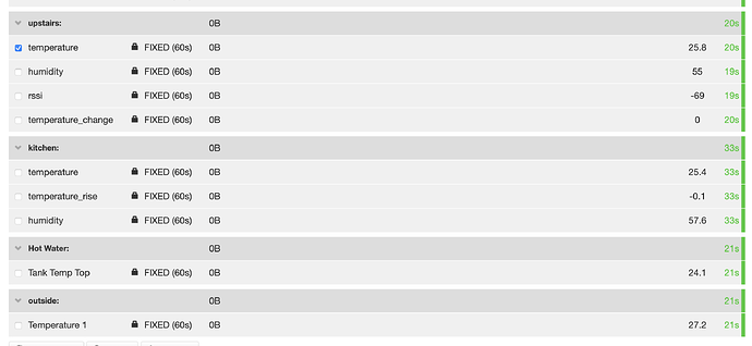

Have you set the Units of the Feeds in emoncms?

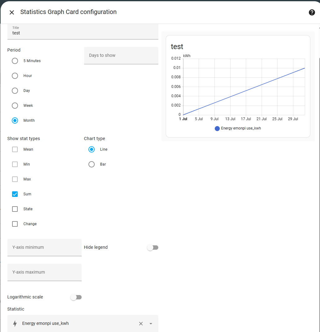

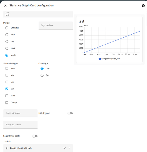

What card are you trying to use?
Works for me
Although I don’t think this card is the best card to use for this sort of thing.
What information are you trying to convey?

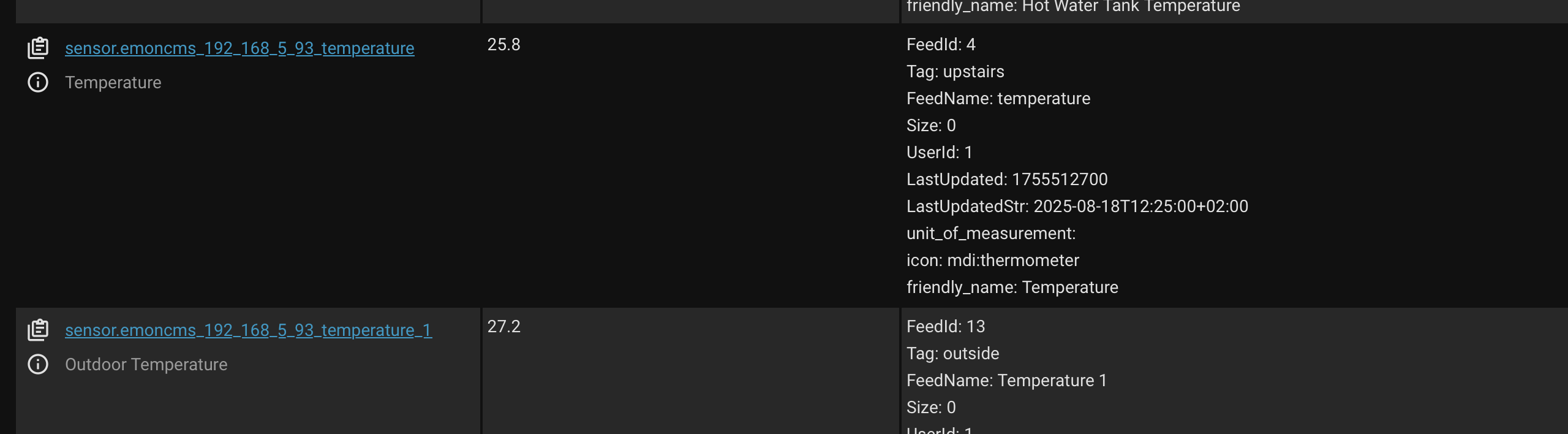

with recent version of the plugin, sensor class and units are available but you need to fix the unit in emoncms. If you dont, HA will not do that for you. Devices are not implemented. Dont know if it you make sense anyway….
Hi guys, thank you for the replies. Mine doesn’t have the class (either state_class or device_class) at all:
And yes, it seems like most of my feeds are lacking units:
I’ve fixed that and I’ll have a go. Thank you!

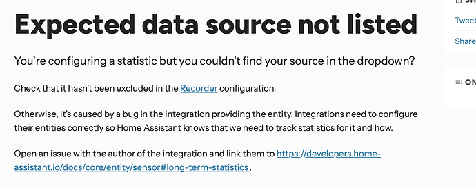

Just for reference, re: “Long-term Statistics”
Sensor entity | Home Assistant Developer Docs
Might it be worth having a warning in the HA log for this on startup? Could it also warn the user when the configuration is done?
