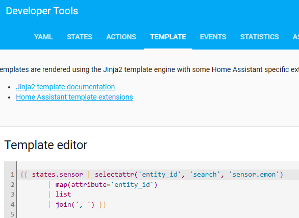

In addition, this may help. You can rename the new entity to match the old name. Everything should then work as before.
Thanks but I don’t understand the cure! If I go to Developer Tools I see a screen with a menu oftabs at the top and YAML is selected. I don’t see anywhere there to type in anything like
{{ states.sensor | selectattr('entity_id', 'search', 'sensor.emon')
       | map(attribute='entity_id')
       | list
       | join(', ') }}
and if I select every other tab in turn I don’t see anything else that immediately leaps out as the place to do it. I do wonder about Template editor, but there’s no links to any idiot’s guide?
I braved it and put it in the template and that worked, so that’s good :smiley:
