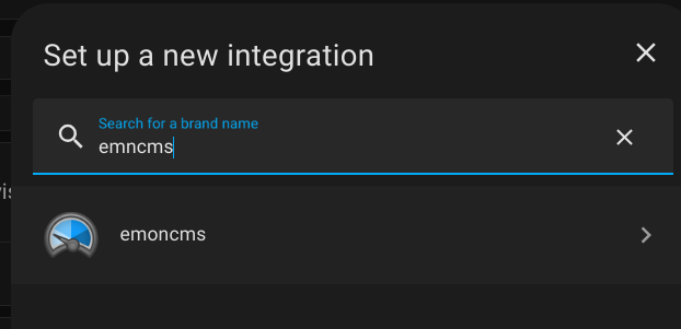

Here’s a few screenshots of what the user journey looks like to setup Emoncms integration on Home Assistant when running 2014.10 +. It’s now very straightforward:
1. Add the Emoncms integration
Settings > Devices and Services > Add new Integration > Search for ‘Emoncms’
2. Enter Emoncms URL & API
This will usually be https://emoncms.org, or a local emonpi e.g http://emonpi.local
The API key can be found on the Emoncms account page, you should enter the read-only API. Both API keys will work, but there’s no reason for HA to require write access, so it’s safer and best practice to use the read-only key.
3. Select the Emoncms Feeds you want in Home Assistant
It’s possible to add multiple Emoncms integrations e.g pull data from both emoncms.org and emonpi.local. To add a 2nd instance choose ‘Add Entry’ in Devices & Services > Emoncms
