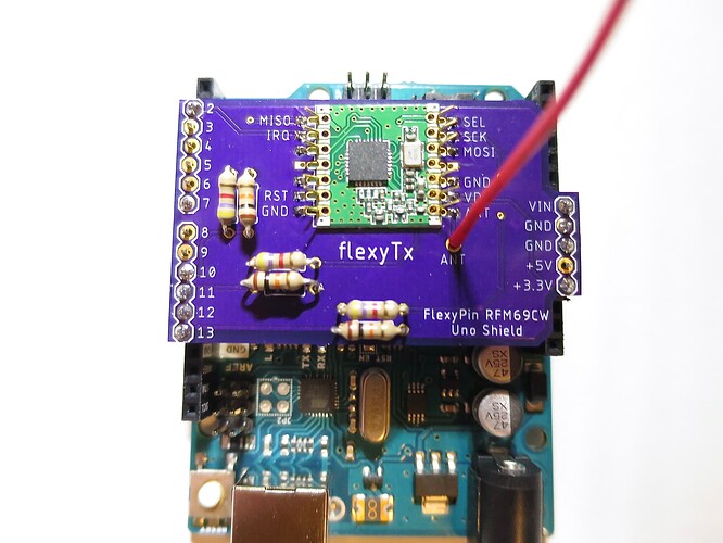

I am working on an Arduino Uno Shield for testing RFM69CW radios with FlexyPins from Solder Party (FlexyPin | Solder Party). FlexyPins are designed to allow easy insertion and removal of castellated modules like the RFM69CW.
The FlexyPins are working great! My Uno shield is not. Any suggestions are most welcome. I am attaching the schematic and board below. The idea is to follow the example of the “Arduino Uno Connections” section of the documentation (RFM12B & RFM69CW Wireless Transceiver Modules — OpenEnergyMonitor 0.0.1 documentation). As well as the original emonTx Shield. In other words, power the transceiver with the +3v3 pin of the Arduino. Level-shift the MOSI, Clock, and Select connections using 4k7+10k voltage divers.
I am testing with the usual RF12 Demo sketch from JeeLib. I am powering everything with USB plugged into a Mac running Arduino IDE.
What I find is that the radio will not even initialize. I see “[RF12demo.14]” in the serial monitor, but no subsequent output.
I tried various things. Checked that I had good GND connection. Checked my soldering. Measured the output of the voltage dividers. Checked the continuity of my traces.
I also tried powering the transciever with the +5V and the VIN pin running through a couple different 3V3 voltage regulators I have around. This didn’t work, but while I was doing it I made a breadboard error and bypassed the regulator, powering the transceiver with the +5V pin. I expected this would fry the module, but instead it started working! It initialized and started to output packets from the various sensors in my home.
I had three copies of my PCB from OSHPark to try, so I soldered up a second unit, but this time I bypassed the voltage dividers. (I replaced the 4k7 resistors with jumper wires.) This unit works when powered from the 3V3 pin. Without the level-shifters the MOSI, Clock, and Select are exposed to the 5V logic of the Uno, but it works and hasn’t (yet) fried a radio.
I took the third PCB and soldered it up with voltage dividers, but this time I used 470 and 100 ohm resistors, thinking that I could supply the same voltage but more current to the transceiver. This unit does not work. It won’t initialize.
To summarize:
  • Powering from +3V3 pin and using level-shifting dividers: doesn’t work, but seems like it should.
  • Powering from +5V pin: works, but seems like it shouldn’t.
  • Powering from +3V3 pin and bypassing level-shifting dividers: works, but seems like it shouldn’t.
I appreciate any thoughts and suggestions. I am stuck.

With every respect, you seem to have done so many things wrong that it’s difficult to know where to start.
There’s nothing wrong there. (You did mean “dividers”?)
I don’t use a Mac, but that too should be OK.
Where does that come from - is it in the sketch you’re using? Is it before the call to rf12_initialize( ... )
If the sketch stops there, a likely cause is rf12_initialize is failing to return. To prove it, put a Serial.print("Init done") (or similar) statement immediately after - if this doesn’t appear, you’ll know for certain where the first problem is.
One likely cause is that JeeLib was written for the RFM12B. If you’re using an RF69CW, you must tell it so, BEFORE you #include <JeeLib.h> like this:
#define RF69_COMPAT 1
#include <JeeLib.h>
Do you have this in your sketch?
I strongly recommend you read the data sheets for the modules. While applying 5 V is permissible for the RFM12B, it’s strongly not recommended in normal operation. For the RFM69CW, the situation is a lot clearer: Under “Absolute Maximum Ratings” it lists “Supply Voltage Min: -0.5 V, Max: 3.9 V”. It might surprise you to learn they mean that. Putting more than 3.9 V on any pin is liable to cause permanent damage, as the data sheet warns: “Stresses above the values listed below may cause permanent device failure. Exposure to absolute maximum ratings for extended periods may affect device reliability.”
Just read again what I wrote above. You are likely to have caused permanent damage to the module.
What in heaven’s name made you think this might be a good idea? Do you not believe that Glyn knows what he’s doing when he designed the Shield? Do you not have the faintest idea of the input current that a digital input on this sort of device requires? When I learned about this sort of thing, the Internet didn’t exist (in the form it does today). All you need to do now to find out is a few keystrokes and you’ll be able to have a reasonable indication, if not an exact value.
Do you mean powering everything at 3.3 V, or the Arduino at 5 V and the RFM69CW at 3.3 V. ?
I think it should work, after all, you’re following a proven design - so your next move should have been to look for something else that might be wrong.
You need to ask yourself: For how long will it continue? Bear in mind the warning on the data sheet.
My best first suggestion is scrap those 3 modules, they’re likely to be seriously stressed and liable to fail at some time in the near future, even if they appear to be working now.
The second is while you’re waiting, read and understand the documentation for the parts you’re using and for the software you’re using.
And the third is don’t “Poke an’ 'ope.” Follow engineering and scientific knowledge and employ a purely logic-driven approach.
If you want a more accessible library to see exactly how the RFM12B and RFM69CW are initialised and driven for transmit only, look at my rfmTxLib:

Lots of opportunities to learn something then, I suppose!
Yes. Typo.
Yes it comes from the sketch, and yes it happens before the call to rf12_initialize. The sketch is the RFM12Pi V2 with RFM69CW Firmware (below).

I do. (The RFM12Pi V2 with RFM69CW Firmware I am using does.)
I can’t claim to have read every page, but I spent a good amount of time reading about the voltage ratings and the level-shifting necessary to use the modules with a 5V-logic device such as an Uno. There are a lot of warnings around the internet about this, and I had every intent of heeding them.
That may be true. If so, I am out about $1.50 US.
I did a very careful study of Glyn’s designs for the Sheild, starting from the earliest v1 with through-hole resistors. I also read as many blog posts from Jean-Claude Wippler as I could find from the era when he was developing JeeNodes, especially his first RFM12B Board. I believe Glyn and JCW know what they’re doing, which is why my design tries to stay true to theirs.
When my board didn’t work I started searching on the internet for reasons it might not. I ran into a lot of forum posts that claimed the built-in 3V3 voltage regulator on the Arduino Uno does not supply enough current to the RFM transceiver. That didn’t make sense to me, because the emonTx Shield works, and it uses that 3V3 voltage source, but it was worth exploring. So I moved to a breadboard and connected VDD of the RFM69CW to a 3V3 voltage regulator, which in turn I connected to +5V. This I saw RCW do with his JeeNodes, so it seemed a valid thing to try. I tried a L4931-3.3 and then a LD1117-3.3. This didn’t help.
While I was doing this I accidentally connected VDD to +5V because of a breadboard mistake. That’s when I noticed the radio initialize and start reporting packets. That was unexpected. What I expected based on the datasheets and thoughtful designs of experts was blue smoke.
I then tried the lower-value voltage divider as an attempt to see if that made a difference. My thought was that if my setup was already low on available mA for the module, further restricting it with larger-value resistors could be contributing to the problem. Honestly this was a bit of a poke and hope. And it didn’t pan out. But again, I’m doing this to learn.
I mean powering the Arduino at 5V and the RFM69CW at 3.3V. And I agree. It is a proven design. It should work. I am stuck.
The only thing that is all that different in my design is that the FlexyPins are the “last mile” of every connection. Could that be the difference? Could they cause the behavior I am seeing?
When you’ve ruled out all possible explanations, it’s time to consider the impossible ones.
Yes, that could be a problem - but you should be able to feel if there’s enough contact pressure on each one (each that matters - many are unused). If you use my library and it’s a RFM69CW, only GND, 3.3 V, NSS, SCK, MOSI & MISO are used.
Is there solder on either the module or the pins where they make contact? If so, that’s bad - it should be gold on gold.
What do you have in the way of test equipment and instrumentation?
NSS (selects the module) should be high except when transferring data, SCK is the data clock pulses and MOSI is the data in from the Arduino, MISO is data out received by the module. Even if you’ve only got a multimeter, you might be able to see a change on SCK and MOSI as it tries to initialise the module.
How does that work? Most SPI slaves require that to go low before they’ll look at the bus signals. Without that they typically assume the transaction is for some other device on the bus and so ignore it.
You’re right as usual - I was looking at the start of the init( ) function, not at the actual function that does the writing.
Edited above.
It does seem to be making good contact. And this is a new radio - no solder to get in the way. Here’s an attempt at a photo.
I believe that is true of the older “JeeLib Classic” library I’m using as well. That’s been my experience. (I’ve read a lot about your work on continuous monitoring for the emonPi and the rfmTxLib library with native rfm69 packet format support, but haven’t had the opportunity to try it yet. (Since my house is full of OEM devices running the classic library, the classic sketch gives me immediate feedback when it works - lots of packets are rolling in all the time.))
I have a Fluke 83 III multimeter, a Rigol DS1052E oscilloscope, and LowPowerLab CurrentRanger.
I’ll try to take a look at these with the oscilloscope.
But first I will shovel a lot of snow.
You need to use your 'scope to look first at NSS to ensure the module is selected, then at MOSI and MISO to see the data sent to the module and its response.
The problem with the ‘Classic’ library, as you’ve no doubt read, is it is almost completely interrupt-driven - because the RFM12B had only a 1-character buffer. The RFM69CW has a sensible buffer at around 66 bytes and so the host can leave all the processing to the RFM69CW and then extract the message (in receive mode) at its leisure (and much the same when transmitting). Interrupts are not required when you use the RFM69CW’s internal buffer - you either poll it and ask if it’s got a complete message, or feed it the message and tell it to get on with sending it.
The RFM69CW reference design in section 7.3 of the V1.1 data sheet has a 100nF decoupling capacitor to ground on the RFM69CW Vcc (+3.3V) pin.
The reference schematic has a note:
‘Note that all schematics shown in this section are full schematics, listing ALL required components, including decoupling capacitors.’
I can’t see an obvious capacitor on the RFM69CW Vcc pin in the photo of the board?
I’m not sure what difference a lack of the decoupling capacitor might make …

Your voltage dividers aren’t voltage dividers. You’ve got the input pin from the Arduino and the output to the RFM swapped - the 10 kΩ resistor is loading the Arduino output and the 4.7 kΩ is directly in series with the signal path.
Or put another way, the 10 kΩ is connected to the wrong end of the 4.7 kΩ.
But I must say, you’ve been consistent. All three have the same error.
This at the very least explains your 4.2 V on the RFM pins.
It would be a big help if there was some visual contrast on those PCB drawings.
Compare your PCB with this:
Ha! I was studying the world of compensation adjustments and realized the same thing. I made this image to explain my mistake, came here to post it and … you had already solved it.
So, here it is as another way of visualizing my mistake, for all to see. I repeated this mistake faithfully on all three level-shifters.
