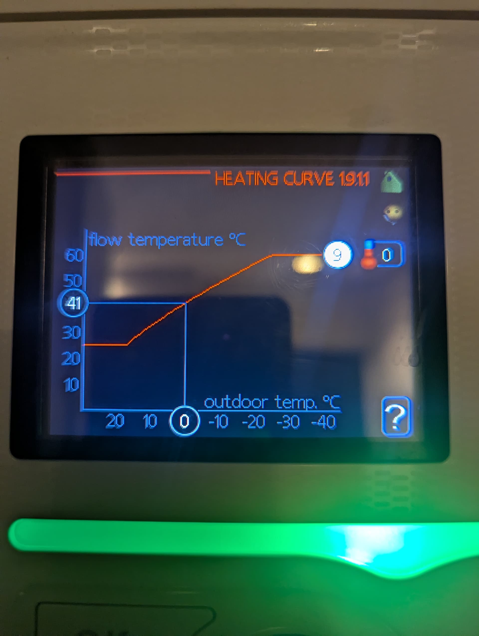

That’s good info and almost certainly means you’ll want to be on a ‘higher’ Curve than the default #9. If the house is warm when it’s cool outside but cold when it’s colder outside, that’s a clear sign of needing a higher flow temperature at lower outside temperatures, so a higher Curve number (assuming you want to prioritise comfort over running costs). Maybe try #12 instead - if you’re happy things have settled down with the changes you’ve already made.

I can’t really tell at the moment since #9 isn’t doing anything (which is fine with current temps). Now that I know I can update this setting if we start feeling chilly I guess I may as well wait til the autumn/winter and then try to work out the right setting for us.

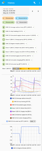

One thing I was thinking about is whether I could collect some useful stats around how long the pump was running for heating / DHW during peak and off-peak hours. I could then draw some graphs to try and visualise when things happen during the day.

This can definitely be done with the nibe data. Based on my understanding so far I would still expect your heat pump to run in heating mode on curve #9 at some point in a 24 hour day. If you’re logging data via HA we can get into determining this and go through how you can use the data to really understand what the NIBE unit is doing. Even in summer it’s possible to get a baseline idea (if you leave it in auto mode)
We have thermostats in each room. They are all hooked up to a Heatmiser hub. They aren’t explicitly set to off but the target temps are low enough that they shouldn’t be coming on much, if at all, during the summer months.

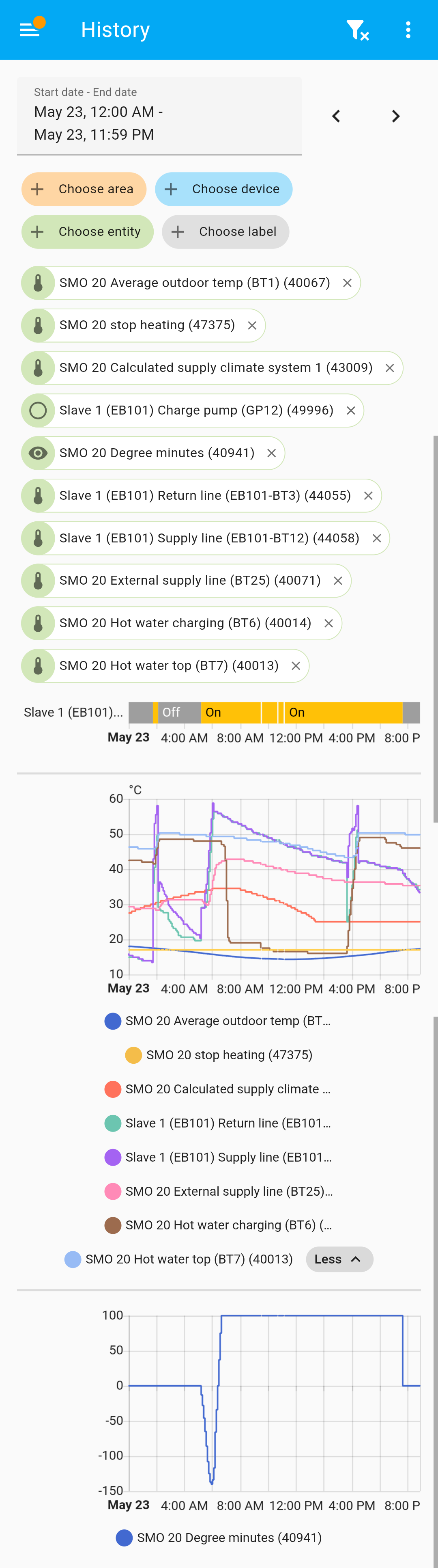

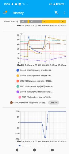

I have the myUplink integration installed on HA and I’ve also tried to save the data into InfluxDB but I’m not really sure that’s working. I’ve been viewing the data in HA history view recently. I don’t think I have the sensor that tells me whether the system is in heating or water mode so I’ve not yet figured out if I can deduce which mode it’s in and then log the start/end time it’s in each mode.
I don’t think it had all week but now that I look I see DM did briefly go negative early this morning and then move back to positive so that must have been it coming on. The charge pump running at 0511 this morning is the heating I think. I’m not sure which UFH zone would have triggered it. I’m sure I can get smarter with having the thermostat information feed into HA. I have the heatmiser integration installed but I need to do some work to organise things so that it’s easy to see what’s going on. I guess a heating focused dashboard might be the way to go but I’ll need to do some more research into the what and how. I’m sure there are plenty of YouTube videos to reference.
With NIBE systems it’s not necessary to add a third-party sensor like it is with other brands - there’s a myUplink parameter which tracks this. Unfortunately the specifics seem to vary between different NIBE models: my F1145 reports it via parameter 50095 and values like 15003 (=Off), 15004 (=Hot Water), 15005 (=Heating) but on the SMO 20 I think it’s parameter 49994. Sam will know what it is for his system; should be the same for yours.

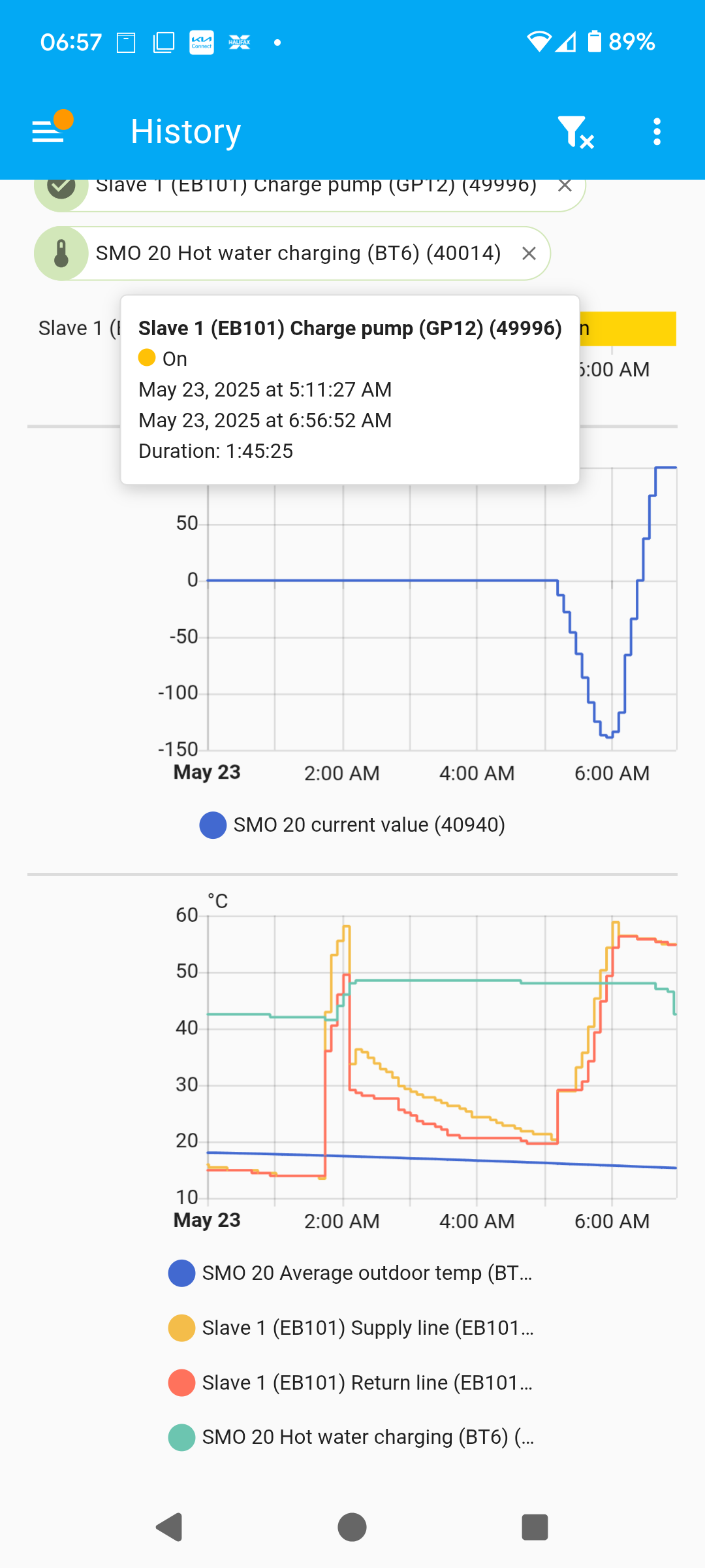

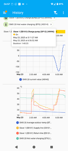

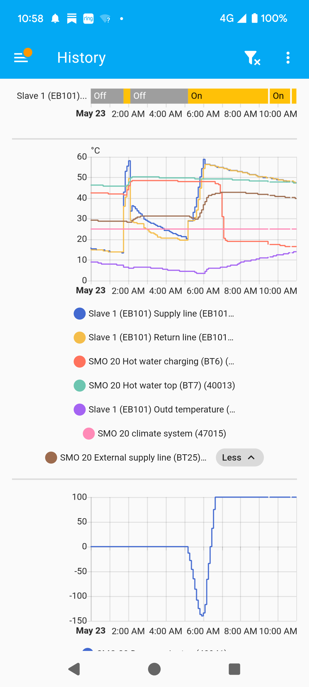

Those graphs show a Hot Water cycle around 02:00 then a Heating cycle around 06:00.

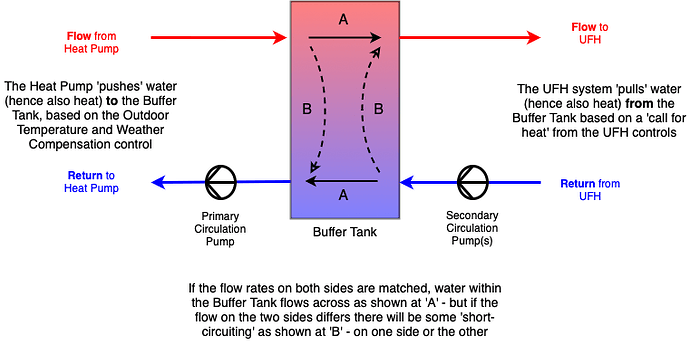

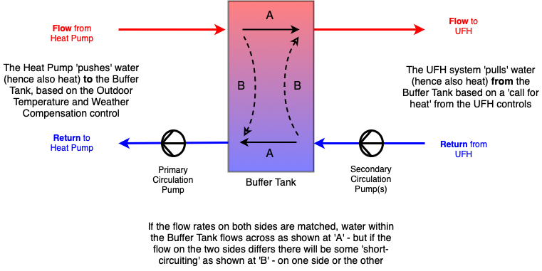

You’ll find a lot of posts elsewhere on these forums saying that Buffer Tanks are A Bad Thing. While they might not be required in small and simple installations, when there are multiple secondary circulation pumps in play it’s important to have something to hydraulically separate the ‘supply’ side (i.e. the Heat Pump) from the (highly variable) ‘demand’ side (i.e. the UFH circuits).
I’ve drawn a simple sketch to show what the Buffer Tank is trying to do - making the assumption it’s plumbed-in as a “four pipe buffer”.
The challenge is that the controls on the ‘left’ side and the ‘right’ side aren’t linked in any way - so you get situations like at 06:00 today when the UFH didn’t want any heat but the Heat Pump ran anyway. The graph showing the slow decay of the Supply and Return Temps after 06:00 implies the primary circulation pump was just moving water to and from the Buffer Tank - and none of the secondary circulation pumps were moving any heat to the UFH.

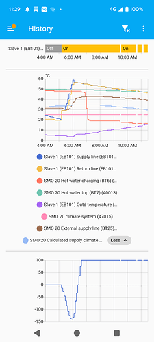

On the heating cycle, it seems odd that the flow temp gets up to 60 degrees - unless it switched to DHW. If the system is running on curve 9 and for a 15 degree (approx) outdoor temp I would expect the flow to be 35-40 degrees?
It would be really helpful if a plot can also
show S1 - target temperature and the BT25 temperature in the same graph.
I would try the priority parameter with ID 49994. Value 10 = off, 20= hot water and 30 = space heating

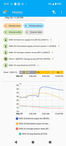

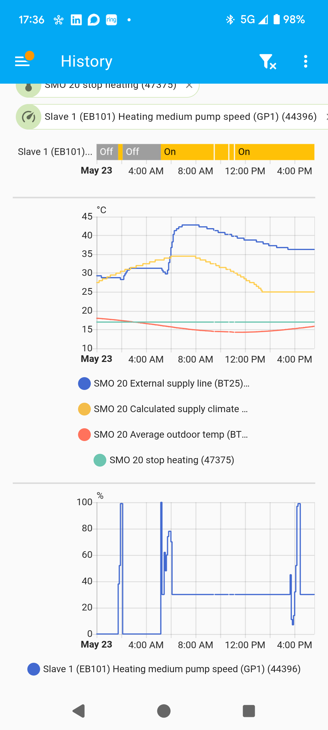

I’m a little confused as to what’s going on today. I’ve noticed the charge pump has been running for quite a while (and still is) which is different from recent days. Nothing particularly abnormal about our daily routines today and weather is roughly the same. I don’t see anything called S1. Maybe it’s referred to via a different name. When I’m home I could send a full list of all the things that are visible in HA of that’s helpful? I’d like to label them up with easy to understand names eventually.
On my system, Home Assistant knows S1 as: “Calculated supply climate system 1”
(Anything with “Calculated” in the name is probably a good candidate.)
Found it, it’s called the same for me. I’ve added it below. I recall you previously mentioned that the charge pump being on continuously doesn’t use much electricity and isn’t in of itself an issue, but it does seem odd that it’s decided to behave differently today so if I can uncover why it might be enlightening.
Yep, that’s it. Sam will be happy now :wink:
When BT25 is less than S1, the ‘DM deficit’ I wrote about before starts building up (i.e. the DM value gets increasingly negative) then once they swap over the DM value gets increasingly positive - but it’s capped at +100.

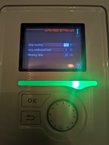

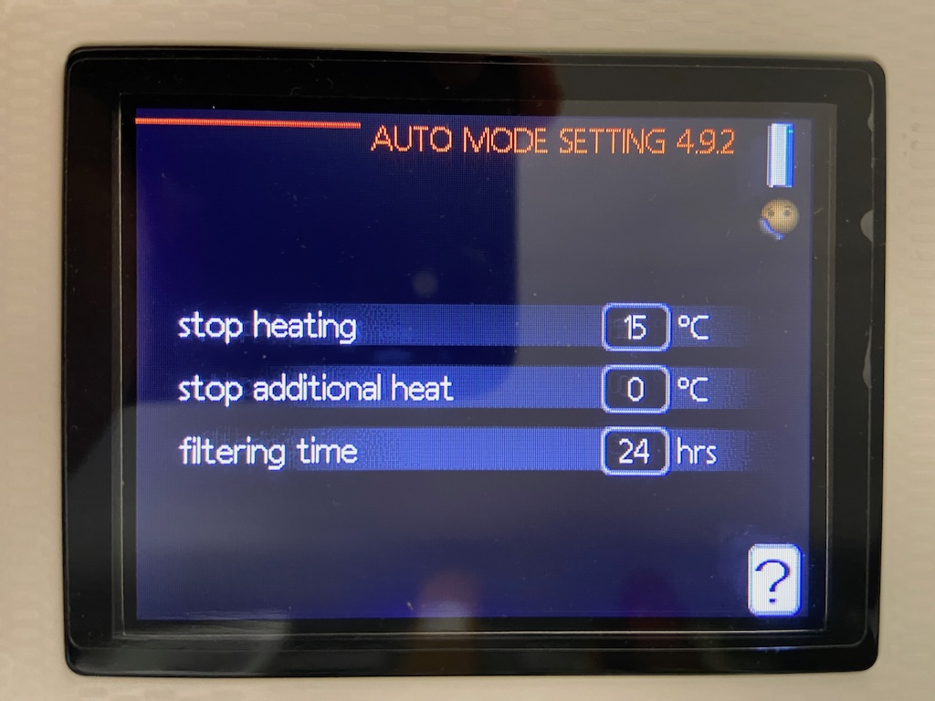

When you’re running in ‘auto’ mode, the “Auto Mode Settings” from menu 4.9.2 apply:
The help text for that screen explains that if the Outdoor Temperature - when averaged over a 24 hour period - has been above 15 C (or whatever other values you have set on your system) the heating system (i.e. the charge pump) will ‘stop’. It’s been colder recently, especially overnight, hence your charge pump has been running.

Those plots are the ones that will be helpful going forward.
The mystery still to solve is why you get a flow temperature (supply) up near 60 degrees when the target temperature (S1) is somewhere around 35 degrees. There is always an element of overshoot so it can satisfy the heating “deficit” and get the DM above 0 again, but I’ve never seen such an overshoot. This will be running the heat pump fairly hard to get to this temperature.

This appears to explain things accurately, assuming my settings are those defaults I’ve tidied up the graph to only show the relevant values and can see the average outdoor temp does dip below that 15°C threshold. But what does running the charge pump actually achieve if there is no heating demand at present?
Remember that the SMO 20 is not being told about any ‘call for heat’ from the Heatmiser UFH controller so it’s just doing what it’s been configured to do, based on the Outdoor Temperature and its Weather Compensation algorithm. As per my Buffer Tank sketch, the Heat Pump is ‘pushing’ heat to the buffer based on what the SMO 20 has been configured to do.
The SMO 20 is also unaware of what the ‘heat emitter’ side of your installation looks like:
  • It doesn’t know there are multiple secondary circulation pumps to ‘help’ with circulation
  • It doesn’t know whether there’s a ‘volumiser’ tank in play - which would require flow from the primary circulation pump (charge pump) in order to move heat from that volumiser into the house, between heat pump cycles
In your case it’s being overly-cautious. As I noted before, BT25 needs to see “a bit of flow” to give an accurate temperature reading - but if the charge pump is running at 30% that does seem excessive.
Got it, I keep forgetting left hand doesn’t know what right hand is doing. Seems odd that they’ve not solved that “problem”. Maybe problem is the wrong word.
Would reducing the minimum speed make sense?
Looks like its mostly been running at 30% and has kicked up a gear for a couple of short periods today. Should I think about changing the 15°C “stop temp” if we’re not actually feeling cold in the house at the moment?

Yes it’s curve #9/0°C offset at the moment

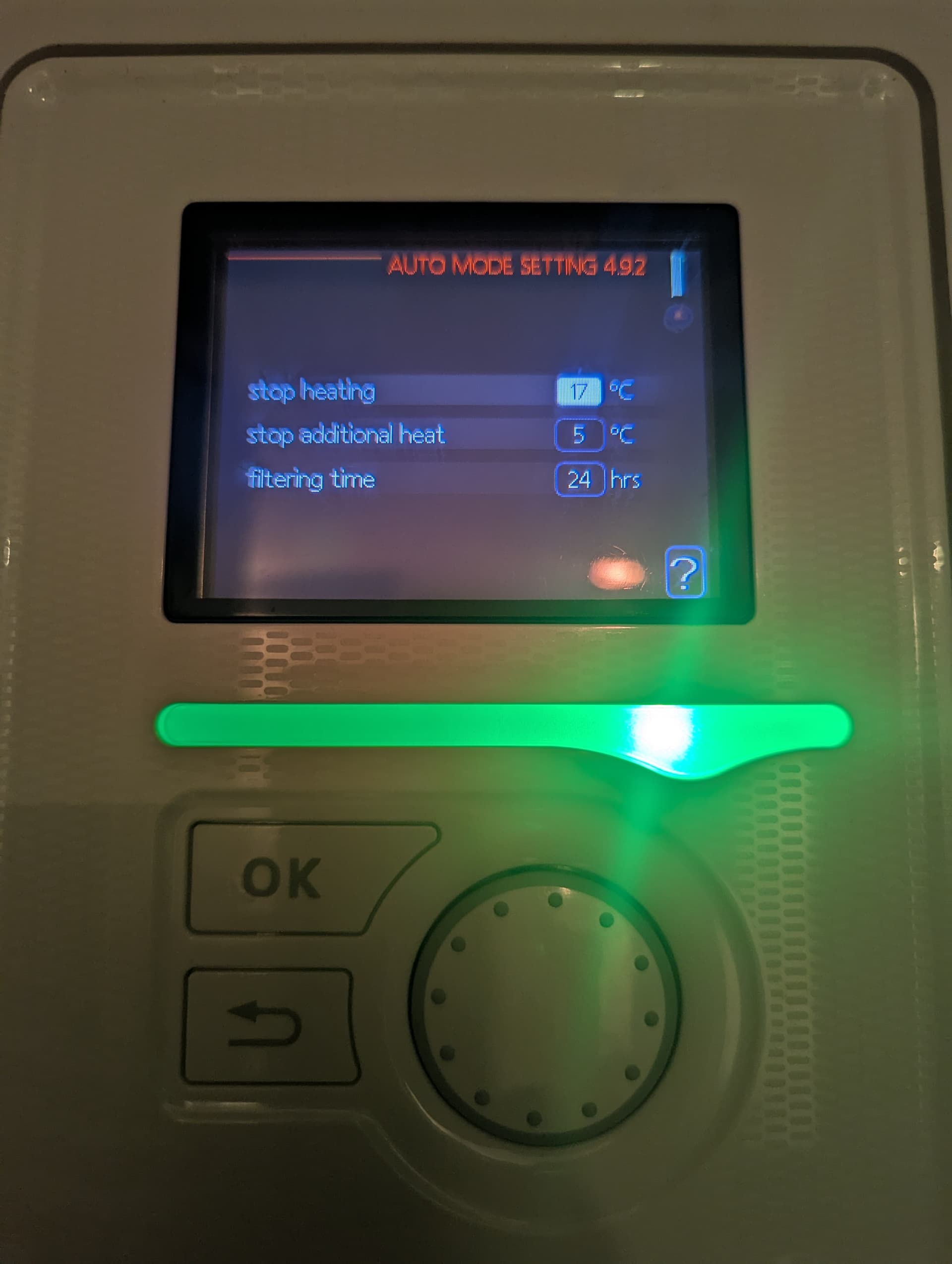

I realised my “stop temp” is not the default. It’s currently set to 17°C (and 5°C for stop additional heating). We’re going to be away from home for a couple of days so I’m thinking of going back to manual to save my bills but when we’re back I’d certainly like to go back to auto and figure this out properly.
Today the pump did turn off when the average temp crossed 17°C so it does look like that was the driving factor today. I note that the supply line temp heads towards 60°C during the times when the DHW is being heated (e.g. just after midnight when the off-peak period begins, again after 0630 when I got out of the shower and it was still within the off-peak period and around 1530 when it’s peak electricity but I have the water heating scheduled. My wife used the shower after 0700 so the water tank had some cold water in it when the afternoon schedule kicked in today)

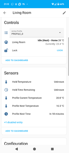

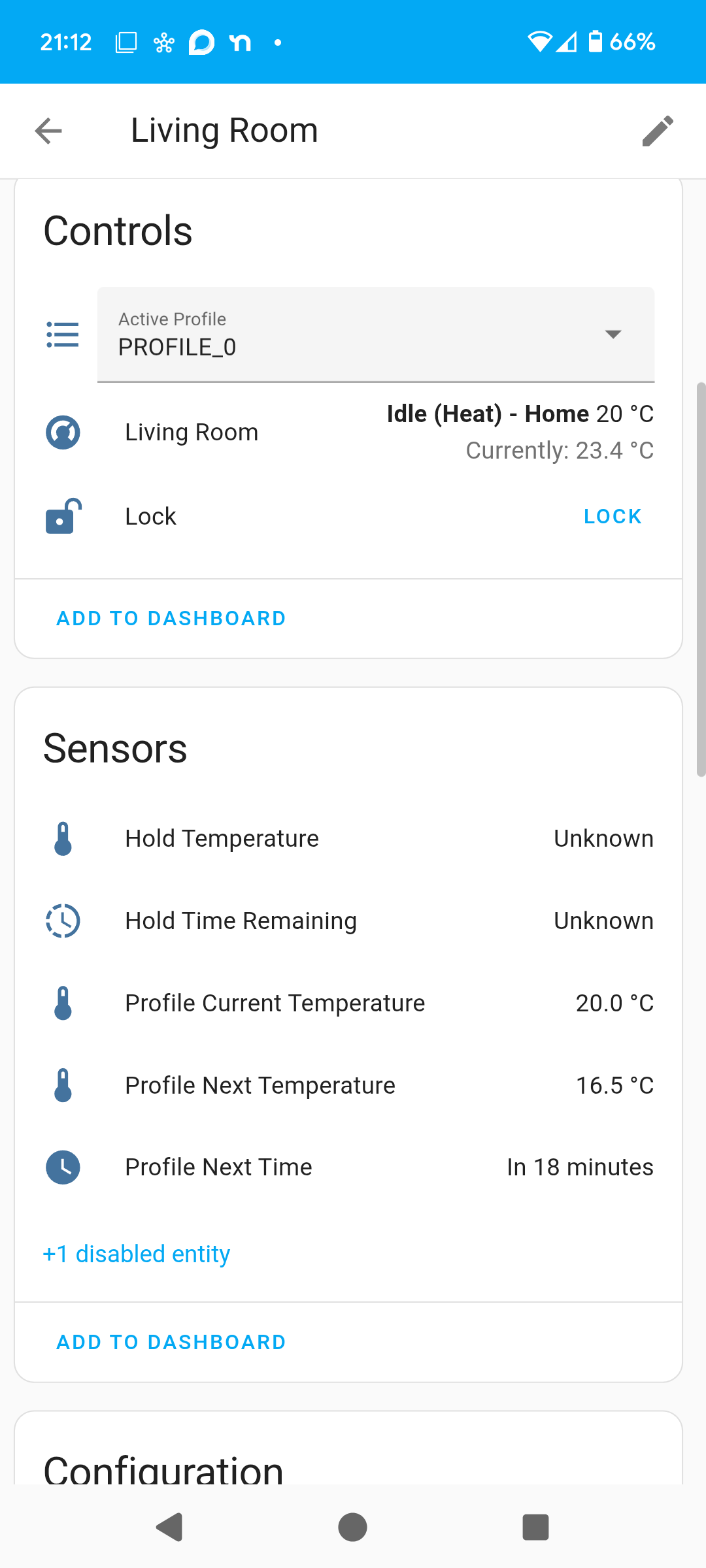

This sounds interesting. I can provide some info on what the heatmiser integration gives. Here’s a screenshot. This is the living room thermostat. Note that the wire that reads the temperature is embedded in the floor so it’s important to note that the 23.4°C current temperature shown here is certainly not the temperature of the room. The profile (i.e. target) is set to 20°C right now so given the floor is supposedly above that it’s not calling for heat. We have a profile so at some point later this evening the target will drop to 16.5°C. I think we probably need to do a bit more tinkering to work out which floor temp equates to a comfortable air temp in each room. I think there is certainly scope to make one or more room(s) on each floor draw heat and so activate the pump if that’s worth trying.
No such metric on my side and I don’t see anything obvious. From what I can see I’d have to deduce what the system is trying to do by combining multiple sensors with some logic. HA should be flexible enough to do it but it does seem a little more complicated than I was hoping for.
