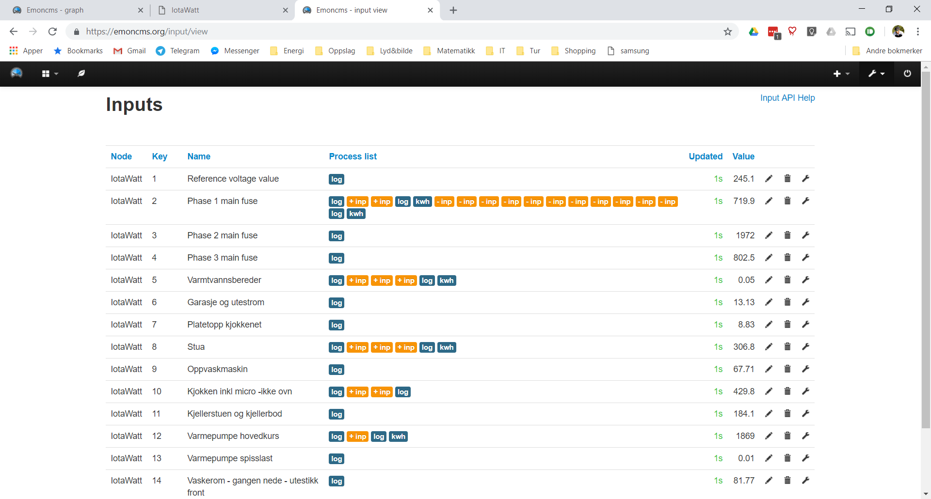

I have an IotaWatt up and running, uploading to emoncms. I try to understand how the input->feed calculations work, specifically the one calculation on Key 2.
What I try to do is:
  1. Sum the three phases on my main fuse to a total consumption. The result makes sense and is within 1% of my electricity meter.
  2. I measure many users, but not all. After summing the phases and creating “log to W” feed and “accumulated kWh” feed, I subtract all the CTs measuring individual users with aiming to get a “the rest”-calculation. Is that the way to do it?
    I get a result, but it seems to not subtract everything. Specifically, it seems not to subract my water heater, so I just wanted to ask if I have got it right.
I think I would use “Reset to ZERO” after you have logged the sum of the 3 inputs and then start again, by adding the Inputs you want or (preferably, for reasons of timing) adding the Feeds that you want.
You appear to have the right idea, but the devil is in the details. The screenshot doesn’t show the intermediate values, and it doesn’t show specifically which inputs are being added and subtracted. So there could easily be a mistake or omission there. If you click the little wrench at the right of the Key 2 line, you will see a detailed listing of the input processes, along with the latest values produced by each when the process list was last executed. If you post that, it would be possible to see, at least, if it’s a problem with the specification or how it is executed.

Thanks a lot for the comprehensive reply! It turns out that my confusion was in one of the users (the water heater) was on the wrong phase, and was logged with about 50% of its actual power. So that’s sorted.
