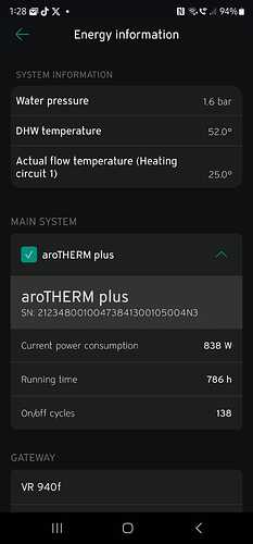

I’m looking for some advice on interpreting data from my air source heat pump (ASHP). I’ve attached two screenshots showing performance on days with similar weather conditions.
Please ignore the internal room temperature shown in the data—our front door has been left open a lot due to bathroom tiling work, so it’s not relevant. The system is running on full weather compensation, so internal temperature isn’t a factor anyway.
I’ve read a lot about cycling and understand that ASHPs are designed to perform several cycles per hour. Based on the data:
  1. Why does the ASHP complete more cycles on one day compared to the other, given the similar weather conditions?
  2. Why are there so few cycles overall?
  3. What should I expect in terms of cycling behavior during warmer weather and how will the efficiency be affected?
Looking forward to hearing your thoughts and insights!

The main reason a Vaillant cycles is that the internal Energy Integral counter tells the heat pump to stop and then restart.
Integral is explained in this article I wrote.
Basically, your emitters can’t shed the heat being generated so it shuts down for a bit, restarts and starts the process again.
Your indoor temperature actually matters. If it is really colder inside because the door is open, the radiators will be putting out more heat despite everything else being equal. Looking at your first graph I see less cycles; and this coincides with long periods of low indoor temperatures. In the second graph your door looks closed, it is warmer inside and the radiators emitted less heat - hence the increased cycling.
Vaillant’s full Weather Compensation mode is set to “inactive,” the system dose not use the internal temperature sensor for its calculations. The flow temperature of the heating system is adjusted solely based on the external temperature and the heating curve.
Andre is right.
If it’s colder inside the house the system can shed the heat via the emitters, so the energy integral doesn’t rise as quickly before needing to shut the system off.
It it’s already warm in the house, the system can’t shed the heat via the emitters so the energy integral counter rises more quickly, reaches zero, heat pump clicks off.
Energy Integral is working in the background regardless of which weather comp mode you’re in.
Yes that’s true, but the radiators’ output depends on (T_radiator - T_room)^1.3. If T_room is lower, you output more power at the same flow temperature.
Excellent points. I’m hopeful that with good system design, we’ve addressed this effectively. The UFH has 100mm pipe centres, 35mm pipe throughout, a 125mm thick slab, and significant thermal mass in the 225mm thick walls with EWI. Am hopeful that as long as the shutdown period exceeds the startup bump, any cycling won’t have a negative impact?
At 25C flow you’ll have tremendous performance.
You could always look at lowering the curve?
Or even playing with “Compr.start heat.from” and increasing from -60 (default) to -100 to increase runs times. But you do risk overheating if the runs are too long and Energy Integral doesn’t click the cycle off.
But might be worth having a look at.
End of the day though, at 7C outside, i’d say that’s around the tipping point when most well designed system start to cycle. It’s what they are meant to do.
