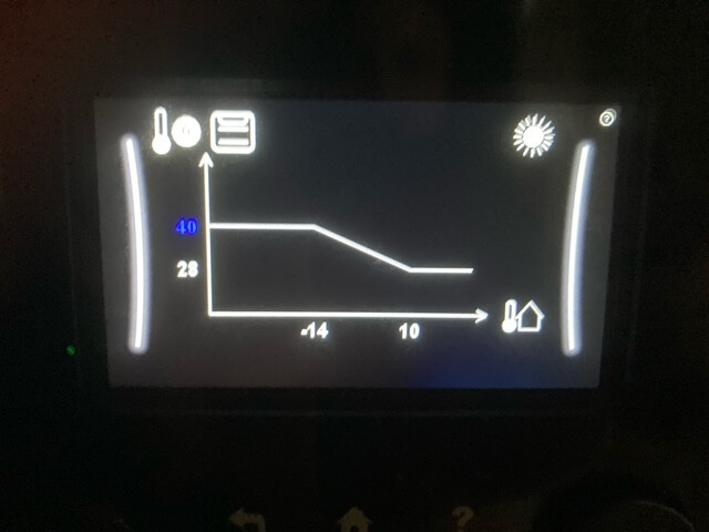

im still tuning my weather curve in below -2 ish so this might look a bit extreme but its working so far , im guessing eventually the -14 will be lower and the 40 hopefully wont need to go up but it might do
its looking like i will need quite a shallow curve

My WDC, just modified a bit
