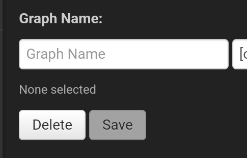

Have you tried the Graph tool instead? Setting a fixed interval of 21600 seconds should show 6 hourly bars synced with midnight (UTC).
Thanks, Tim, that’s helpful.
Is there a way to embed that in a Dashboard?
Thanks,
David
Yes you can. Give the graph a name, save it and then add it to the dashboard.
  1. Screenshot_20240517_194116
Again, thanks for the really helpful information, Tim!
