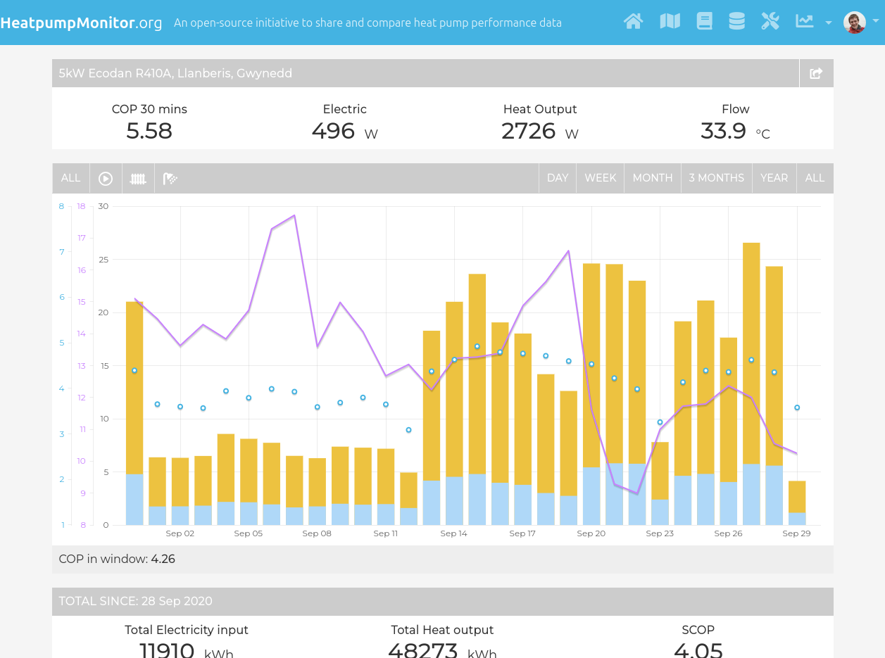

Individual system heat pump dashboards (the MyHeatpump app) is now integrated directly in to the HeatpumpMonitor.org site rather cross linking to emoncms.org.
Example: https://heatpumpmonitor.org/dashboard?id=2
This provides a couple of important improvements:
  • The title of the dashboard is now set by the system meta data, hp size, model, refrigerant and location, this makes it easier to know which system you are looking at.
  • The dashboard URL is more concise and consistent with other system pages e.g: https://heatpumpmonitor.org/dashboard?id=2 and https://heatpumpmonitor.org/system/view?id=2.
  • Privacy improvement: The read key’s used to authenticate read access to the app dashboards are no longer publicly accessible, this has been something I’ve wanted to improve on for a while. The use of the read keys for dashboard access was originally designed for private use: an easy way for users to create private bookmarks of a dashboard but it became the most convenient way link emoncms.org and heatpumpmonitor.org heat pump data. This change moves the use of these URL’s to the back-end only making them no longer publicly accessible.

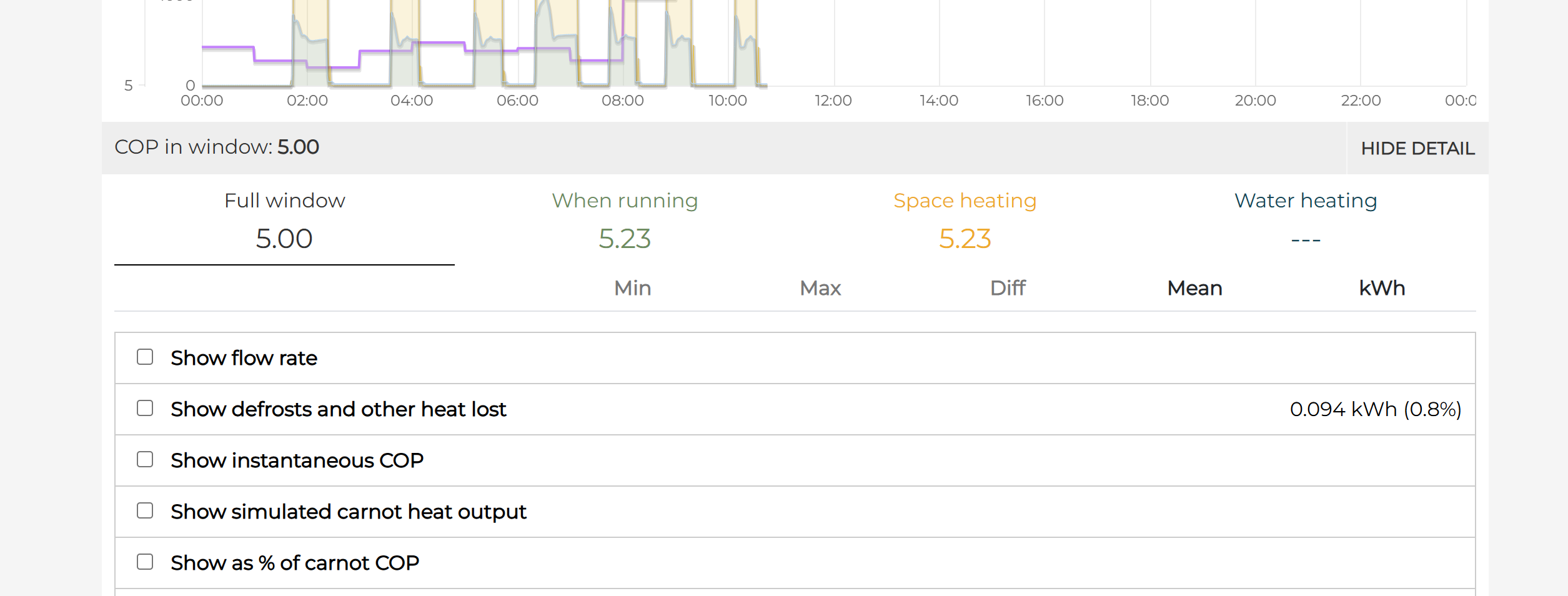

Noticed the “show detail” functionality has broken though.
Not exactly a HPM feature request, but it’d be great to get the ability to view details while on the front page of the dashboard in the Month view - currently you can achieve this by going to Day then increasing the data viewed until reaching a month, but it’s a bit of a faff.
Show detail works for me, what do you see?
:+1:
full window displays details, then clicking to “when running” breaks it and then none of the filter buttons work.
Thanks you are quite right! will look into it

This issue is now fixed :+1:

Did you rule out having the external temperature have a fixed Y level of 0? Rather than float. In the example above - that line on the graph doesn’t ‘feel right’ for the usual daily-temperature curve? As it swings too big a percentage.
