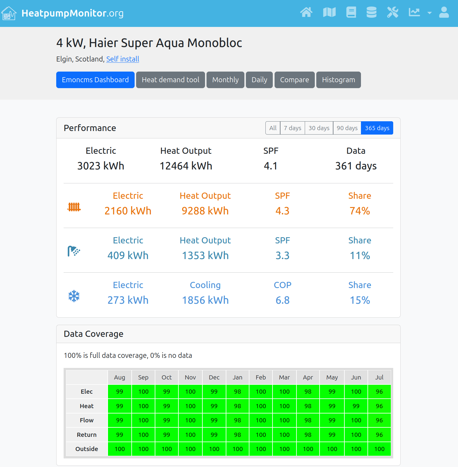

HeatpumpMonitor.org: Hot water and cooling split out on system view page
The system view now shows how heat demand splits between hot water and space heating for systems that are measuring this. Cooling is also split out for those engaging in cooling.
Example: https://heatpumpmonitor.org/system/view?id=337

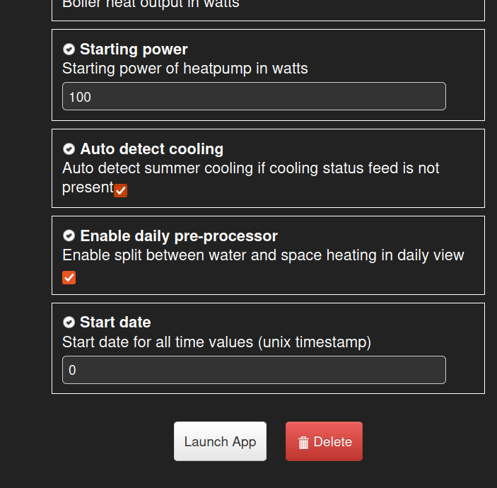

:waving_hand: I have an Air to Water Panasonic Aquarea and fan coil circuit that I use for cooling monitored with an emonHP install HeatpumpMonitor.org is this an option that can be turned on somewhere? I would love to separate the heating from the cooling data. Currently cooling looks like a massive defrost which drags down the SCOP measurement.
Hello @keithduncan you can enable it in the config page for the MyHeatpump dashboard:
Make sure to reload your daily data after changing it.
