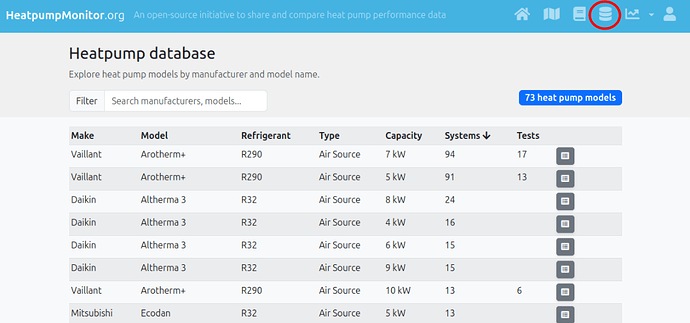

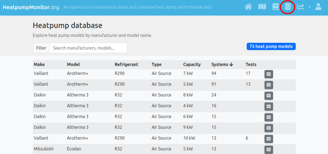

I’m happy to announce a new feature on HeatpumpMonitor.org, the heat pump database!
This database enables:
Future plans include:
  • Summaries of key technical properties such as min & max flow rates, compressor amperage, data sheet based capacity information (that can then be cross checked with the monitoring based test results).

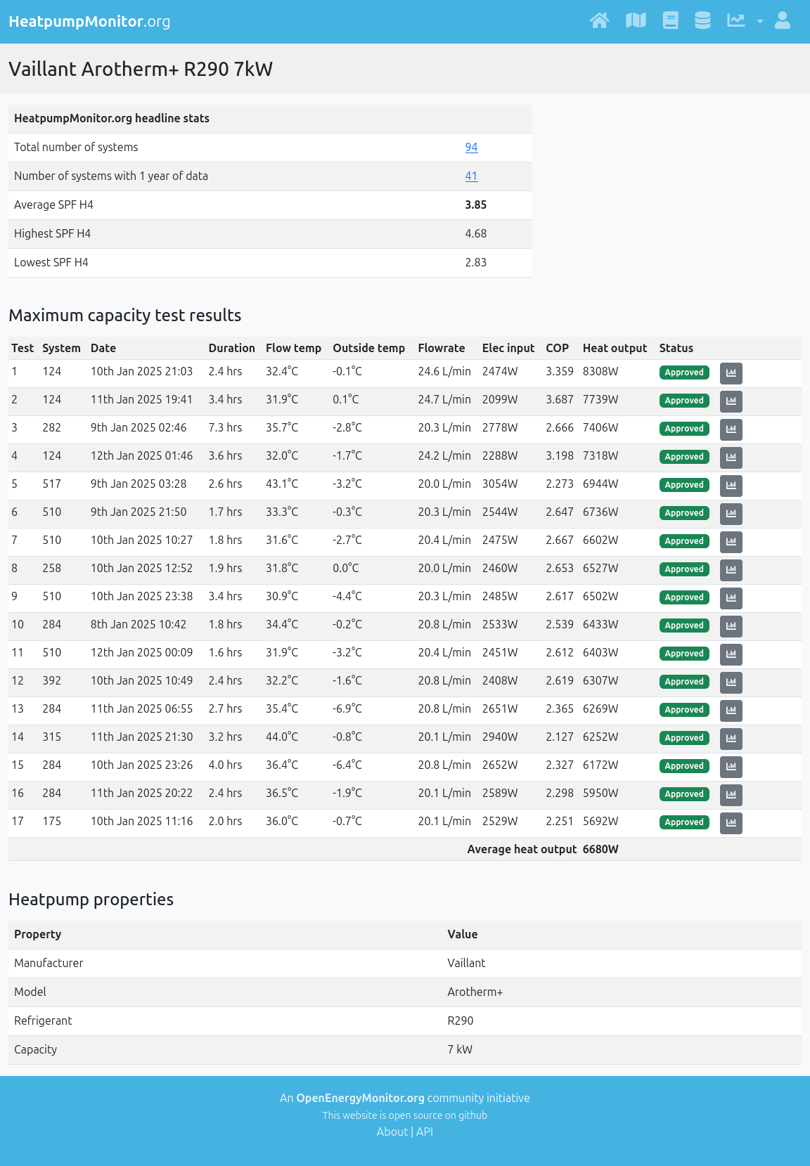

Clicking on a particular make & model of heat pumps shows the information page for that heat pump. Here’s the page for the Vaillant Arotherm+ R290 7 kW with the max output tests copied over from the spreadsheet.
https://heatpumpmonitor.org/heatpump/view?id=3

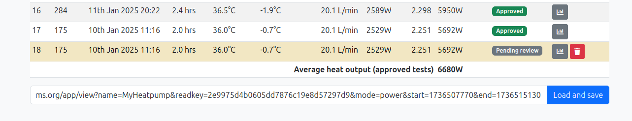

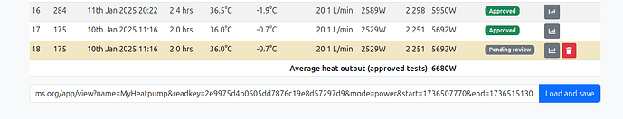

If you are logged in, the page shows an entry box to submit a URL for a max output test, entering the test and clicking ‘load and save’ automatically fetches the key metrics for the test period from the dashboard based on the URL.
@glyn.hudson and I will do a separate post and possibly a video on how to perform these max output tests alongside careful selection of the test period. This is just a quick post for now to give a quite overview of what we are building in preparation for next winter (during a heat wave in the middle of summer :sweat_smile: )
