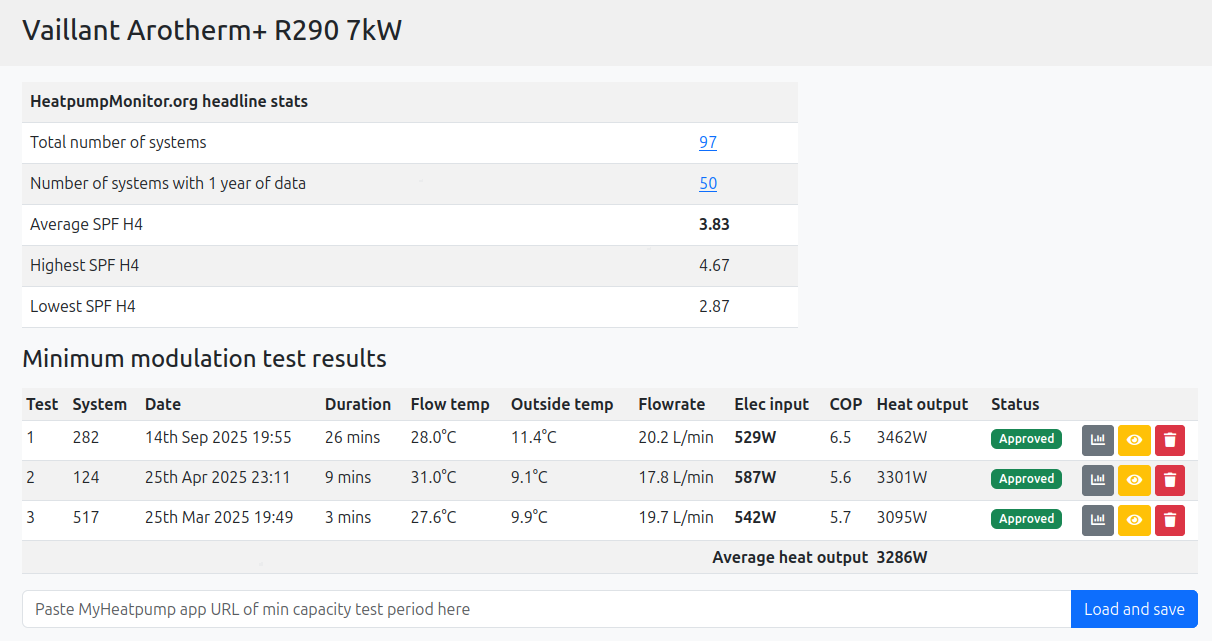

The heat pump database tool now has the option to add minimum modulation test data. This should be a really useful set of data points alongside max output to aid with unit sizing:
See example on Vaillant 7kW page: HeatpumpMonitor.org

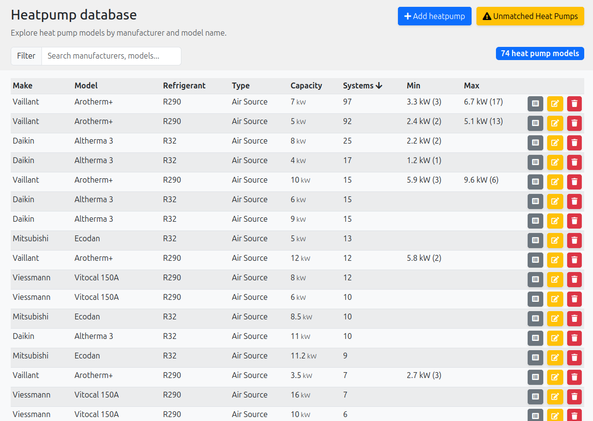

and then min and max output averages listed on heat pump database list page:

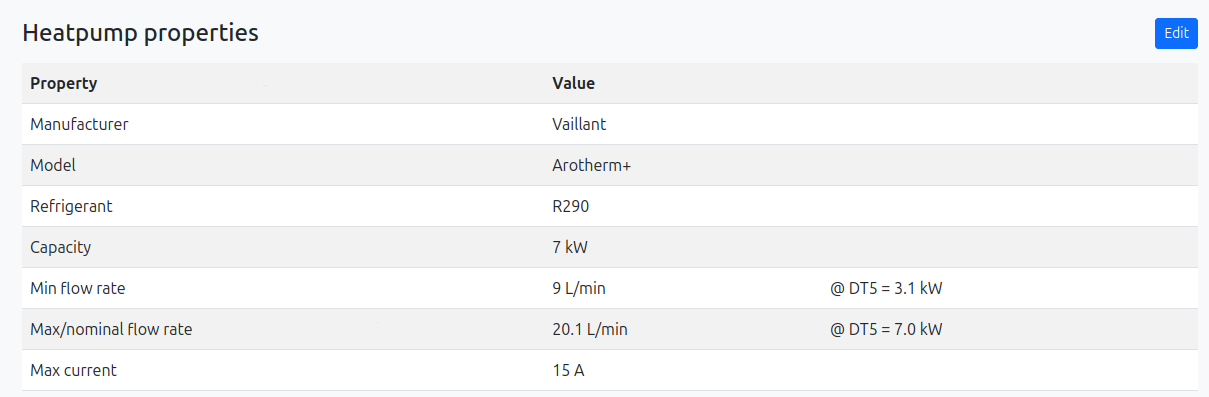

The heat pump properties section, below the tests, can now list min and max flow rate and maximum rated current as well:
We’d very much welcome submissions of minimum modulation tests.

  • The modulation range of the 10 kW Vaillant arotherm looks quite narrow, between 5.9 kW at minimum and ~9.6 kW at maximum. Yet this heat pump can perform very well even when the heat loss of the property is near the minimum modulation point. This suggests that well controlled degree-minute based cycling can compensate very well for a narrow modulation range.
  • The minimum modulation of the 12 kW arotherm is basically the same as the 10 kW - which is what we would expect given the understanding that the 10 is just a derated 12.
  • For Vaillant units the minimum flow rate x DT5 x 4150 J/K.kg gives a minimum output that matches observations quite well - but this does not hold for the 9kW Grant R290.
  • The minimum modulation on the Grant R290 9 kW unit is impressive, being fairly close to the minimum output of the 5 kW Vaillant and Ecodan.
