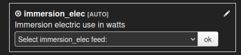

Has anyone got an immersion heater as a separate feed I can test immersion heater app support with? Ideally on emoncms.org :slight_smile:
This is live on emoncms.org, see app configuration:
Latest version of the app’s module is v3.0.0 and requires a database update.

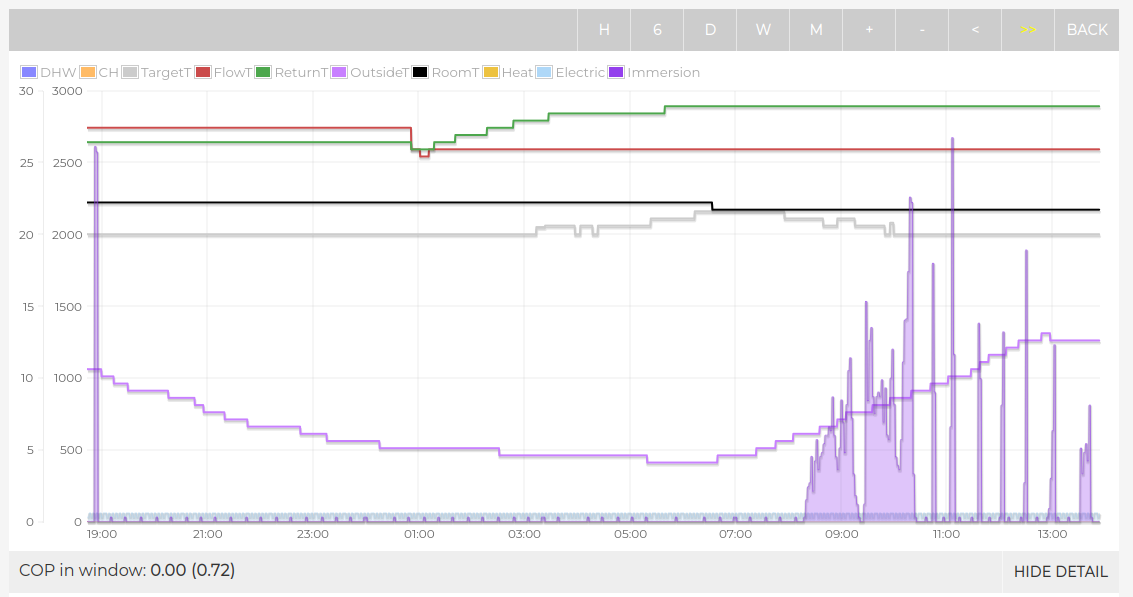

Thanks Trystan. I’ve just added one to mine (Derby NIBE F1145 GSHP):
https://emoncms.org/app/view?name=MyHeatpump&readkey=6d0aa54296732b559a2afc0256180f21&mode=daily&start=1724803200&end=1727481600
I only just created the Feed and briefly ‘forced’ the immersion On for a quick test, but it’s showing up OK. Tomorrow it should start registering solar PV diversion.
For clarity, this is intended to be the immersion heater installed in a DHW cylinder, right?
(Not the separate ‘auxiliary’ or ‘booster’ heater within the heat pump.)

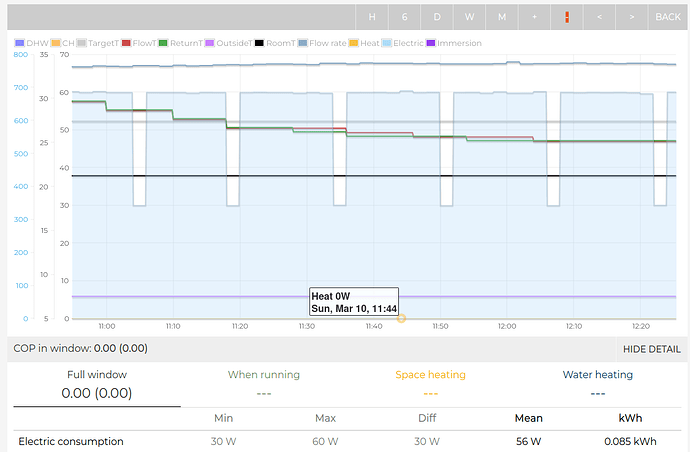

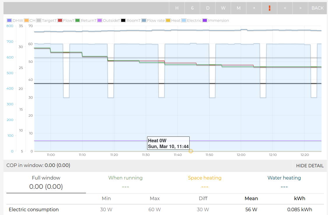

Was just having a look at your standby, ~ 56W, or 500 kWh for all time in your dashboard. If that was treated as heat gained given that it’s in the heated envelope that would increase your SPF from 3.50 to 3.73 (I think you did cover this above?)
It is an interesting question all of this, how to report the physical reality as accurately as possible, rather than using SEPEMO assumptions… I imagine my 11W of standby is probably 4W in the inside unit, If I added this to the heat side of the equation my SPF over 4 years would increase from 4.07 to 4.09, so fairly inconsequential and likely a smaller error than the metering.
But in your case it is more important as missing 500 kWh of useful heat gain and 0.2 SPF is more substantial.
Your COP when running for all time is also pretty great at 4.44! and between 4.0 and 4.4 on the coldest day! The benefit of high performance on the coldest day from a grid perspective is something that is easy to overlook.
PS good posts @John @dMb , all very well said. I will have to think a bit more about how far we go in terms of providing options for dis-aggregating.
My Primary circulation pump is running a lot of the time too, during the heating season, which helps move the water through the volumiser tank; I normally reckon on 45W for the controller and another 15W for the primary pump. But yes, everything is inside the heated envelope so all the energy ends up in the house. I’d done a quick calculation of the impact on SPF from my Secondary circulation pumps and come up with an increase of about 0.2, so 3.50 → 3.73 sounds about right. Adding in the resistive heat from the controller and the Secondary pumps (but not the Primary pump, which is already heat-metered) should get me more like 3.9.
Currently (with no space heating demand and DHW done via excess solar pv diversion) my system is showing a COP of 0, which does seem a bit unfair; it should really be 1.0.
Yep; it does very well when it’s shifting lots of heat - it just doesn’t need to do that very often, and the relatively high standby drags it down overall. Ground Source still has advantages - especially overnight and especially early in the winter, when the ground is still relatively warm. I know it’s often not suitable for retrofit but for a new-build (like mine) it can be a very good choice. No defrosting!
