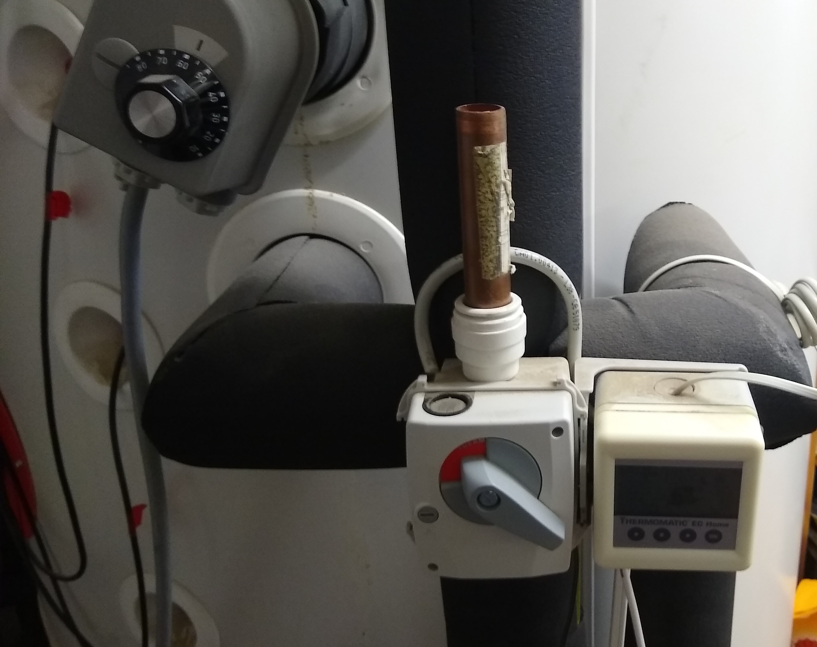

I’d be increasing that insulation significantly with a second layer of EPDM insulation and completely cover the brass fittings…
Is that the condensate pipe? I suggest this might be at risk of freezing up in cold weather.
Nice an neat though.

Perhaps I went OTT - 22mm pipe for scale :grinning:.
Condenstate? I am not sure that there us any condensate in a ASHP system.
That copper pipe is the emergency overflow incase the hot water tank boils and needs to vent. Its end is covered with a cage outside to stop anyone scalding themselves.
Ah OK, unlikely to freeze then :grinning:. It’d be too late to say after…

Lastly - ASHPs do produce condensate, as part of the defrost process. The evaporator will need to defrost every so often in the cooler weather and that defrosted condensate usually trickles out of the bottom of the machine outside and into a soak away (and not on the patio slabs where it forms sheet ice and a slipping hazard!) Seen some shonky installs before :frowning_face:
The evaporator and condenser are outside, so there will be no condensate inside. The big unit outside does drain into a drain.
