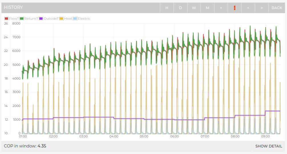

I happened to notice that one of my systems was firing up in ‘heat zones’ mode every 10-15 minutes and running for 5 minutes before returning to idle state. Effectively cycling the heat pump and chewing through electricity. This was happening at a time when all of the room thermostats (Heatmiser NeoStat v2) were in standby mode.

Looks like I spoke too soon, the heat pump is still cycling every 10-15mins running for 5 mins and then going back to standby.

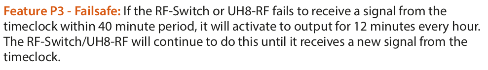

Hello @Dan_Nichols Im sure I noticed this as well with the heatmiser neoAir, there is the failsafe mode that runs for 12 mins every hour if the neoAir is not detected, but that’s a different time period from what your seeing.

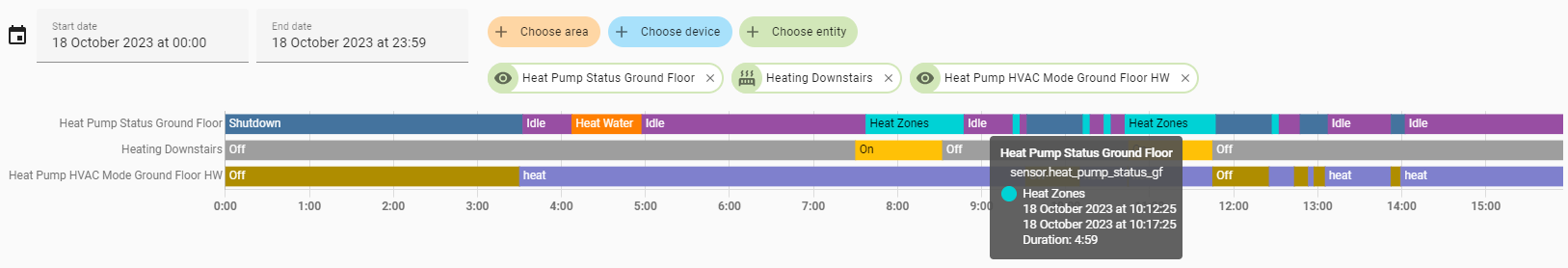

The image below shows the heat pump switching to ‘Heat Zones’ periodically throughout the day whilst ‘Heating Downstairs’ is Off (this coincides with all thermostats being in standby mode). The only way to stop it was to shutdown the heat pump (HVAC mode = Off).
So the phantom calls for heat continue (sometimes with a few hours gap lulling me into a false sense of victory).
