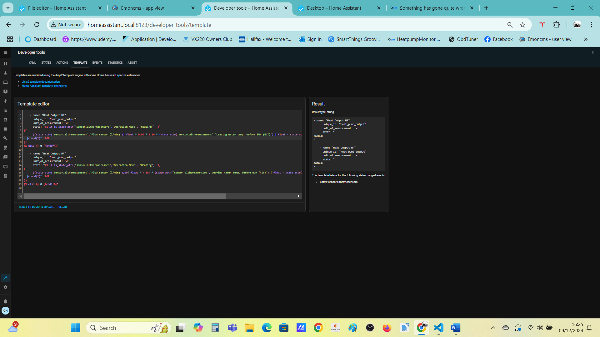

i am going to add this calc to my yaml code for heat produced , i will shout up when i have done it if you wouldn’t mind taking a other look after ive done it , it would be appreciated
What are these constants in the middle?
Neil has / 60 * 4.184 * which looks closer to the physics.
PS: for systems with 25% propylene glycol, the specific heat of the fluid is 4000 at 40°C.
i am running both and they are returning the same value

Here is all three options including the one im using now which seems to be over reading
so looks like i can sort it out, thanks for pointing this out , the calculation does look like it is the issue as you previously mentioned
as this s a live view of the sensors i have been monitoring it for 15 mins and im not getting the bouncing of the out put , so just need to bring all this together , when ive applied it to heat pump monitor i will mention it here and if you wouldent mind taking a look to see if the figures look better

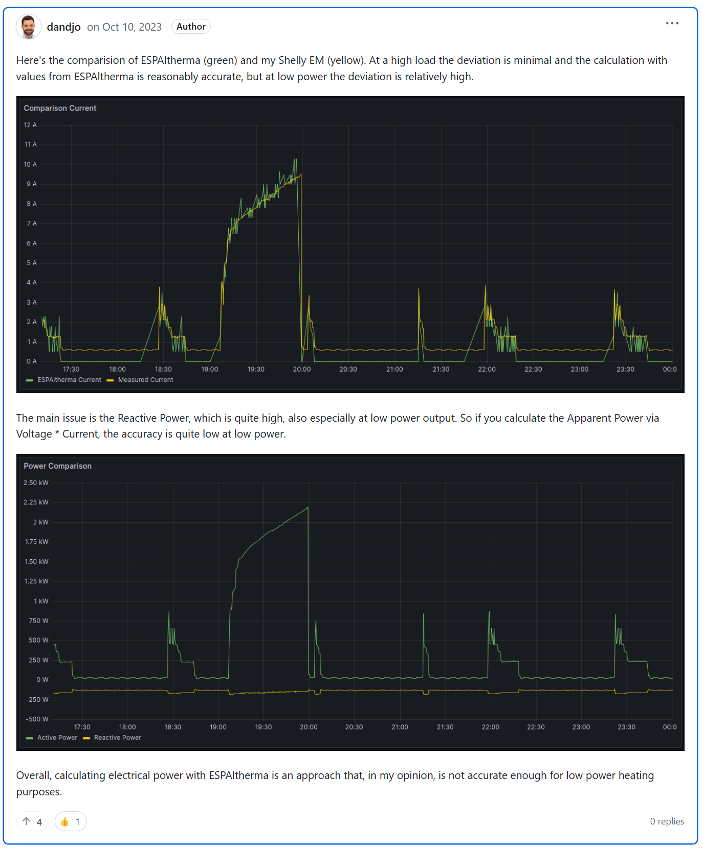

Hi @Chris_Hill,
Are you using ESPAltherma primary current in your calculations?
If this is so, this is the cause of the inaccuracies:
See here:
You will want to be getting a Heat Pump Power feed from another source (in my case, its the Myenergi setup I already had for the car charger)
Screen grab of the main point in the link:

Hi @matt-drummer
If using the ESPAltherma data, there is no Power metric, so others have tried using the current and voltage figures presented in the available data (and there are multiple which further muddies the water), but they (for reasons I do not understand) are so wildly different than a separate power meter, it is unusable even for non-MID monitoring IMO
