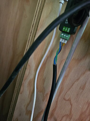

Hi I’m new to all this.
I have the EmonHP package installed. I’m getting data flowing from the heat meter and emonTH room sensors, but not from the two electrical meters.
I believe they are wired correctly. The software is working, so I guess it might be a software set up issue?
Photos attached.
Any pointers gratefully received.
Bertie
Hi Bertie,
Nice work getting the system up and running. I’ve checked the software configuration for your system and everything looks correct. The emonHP base-station is reporting that the RS485 modbus reader is connected via USB, but there is a null response coming from the electricity meters.
How far is the cable extension of the RS485 modbus wires?
Have you got a photo showing the connections between the extension cable and the black flex on the base-station end? All the other connections which I can see your photos seem to look correct.
Glyn
I think Ive spotted a very obvious cause. The cable is damaged part way along- I just discovered it now. I suspect that once Ive replaced the cable we will be good.
