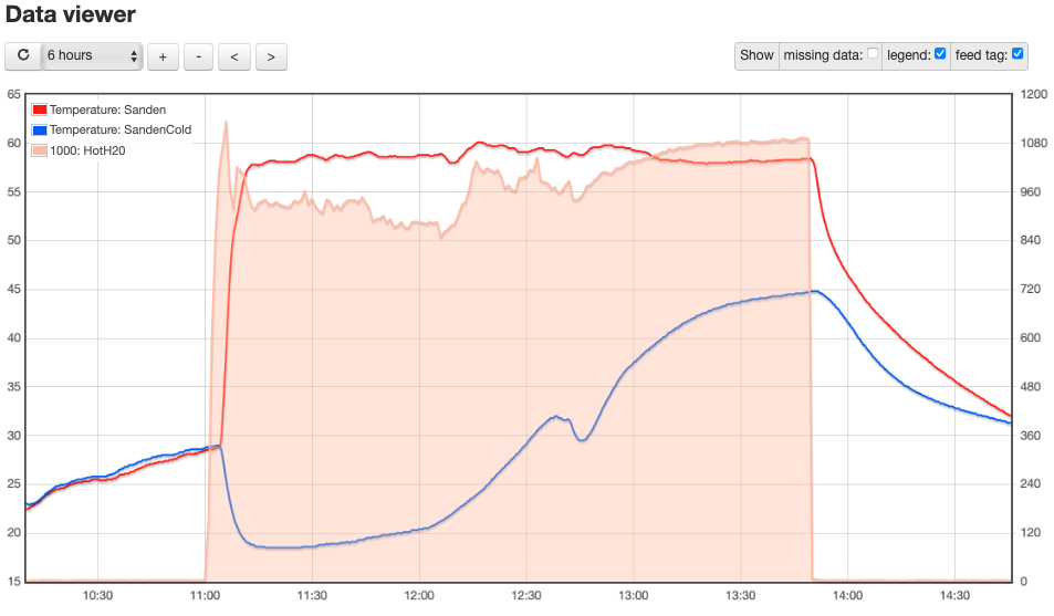

So much, I went out and changed my Temp sensors on my Sanden Hot Water Heater around and ‘attached’ them to water inlet and outlet, and added a Power Monitor (Shelly 1PM) to the circuit.
Now I ‘see’ this view:
I guess to do temperature monitoring properly, the sensors would need to be specially inserted in the pipe somehow for accurate measurement of the water. My ‘poor mans’ method involved putting temp sensors against the copper pipe tucked in between the pipe insulation.
How do others do this ?
Great @muzza, John wrote a good blog on attaching temperature sensors here: https://heatpumps.co.uk/2015/06/08/temperature-sensing-with-openenergymonitor.
Although it’s nice to have them in pockets for the most accurate results, attaching them to copper pipe with a couple of cable ties, thermal paste and a lot of surrounding insulation seems to work fine as well. I used this approach when attaching a monitor to diagnose an issue with a system the other day.
From John’s post in the Strapping a sensor to a pipe section:
