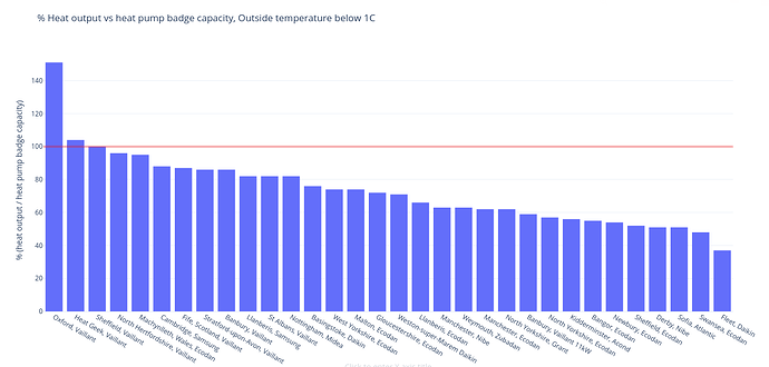

Plot of max heat output over 4 hour period as a proportion of badge capacity (outside temp below 1C)
I should overlay this with the max heat output over a 24 hour period to see how it changes…

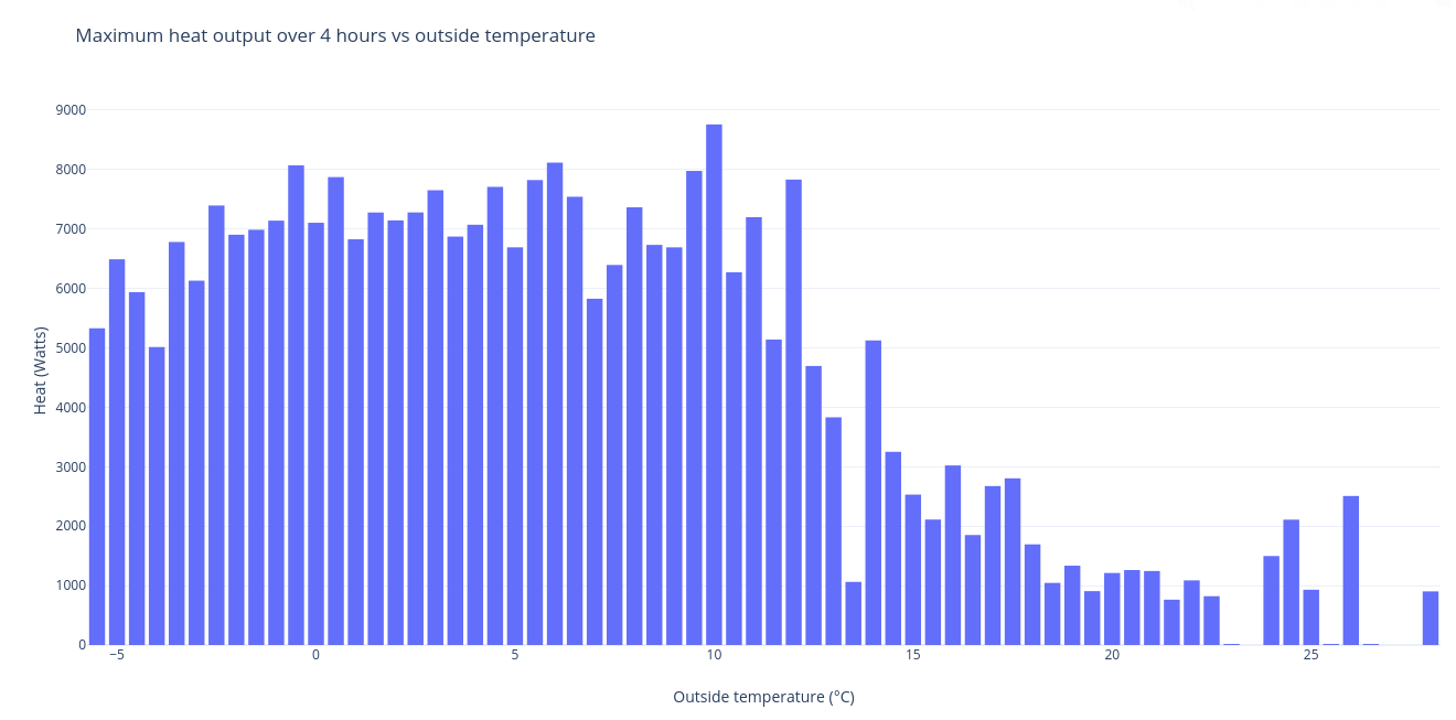

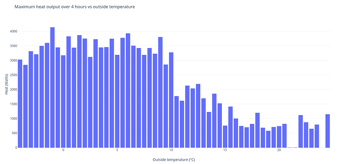

I also extracted the maximum, attempted so far? heat output over a temperature range for a number of the heat pumps on the list.
My Ecodan, 5kW:

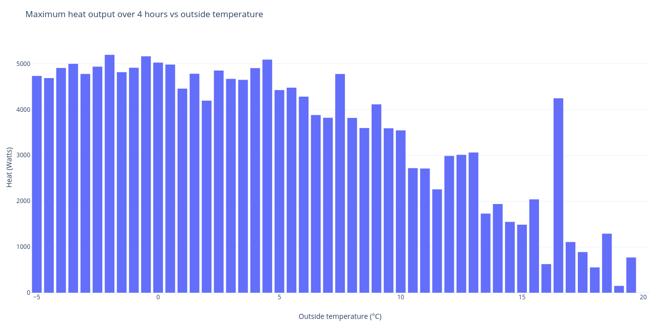

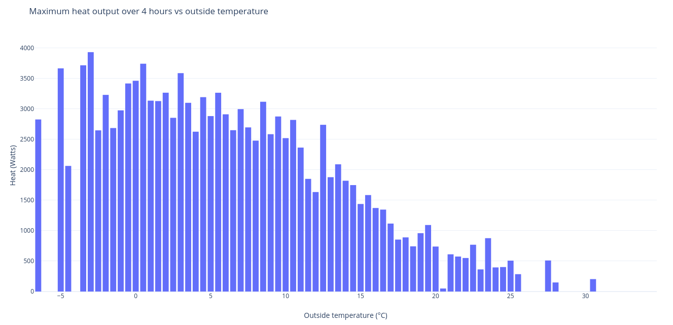

Here’s @glyn.hudson’s samsung 5kW:

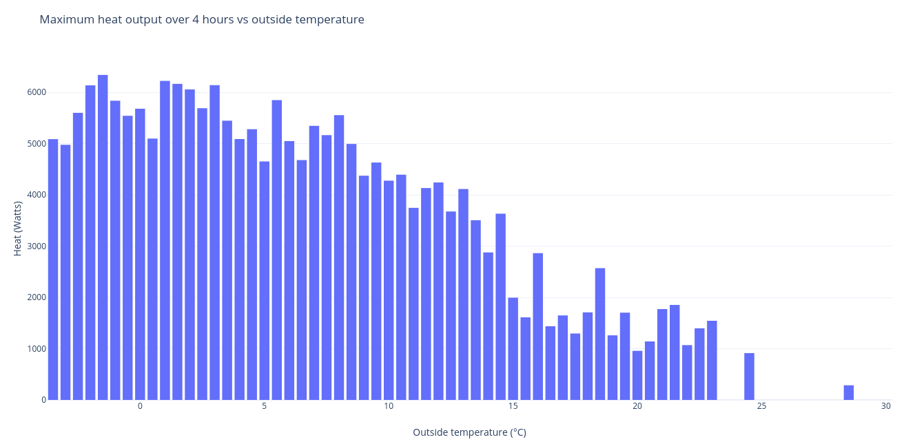

Yorkshire, Ecodan, 11kW:

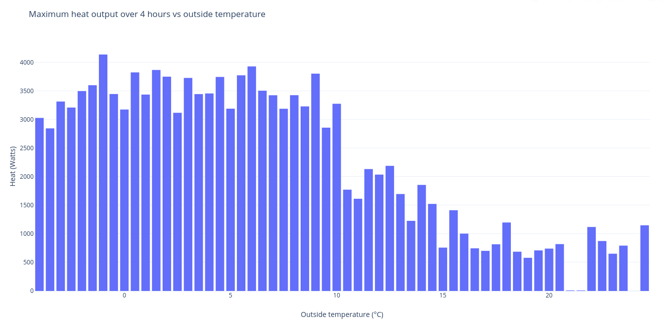

Manchester, Nibe, 6kW:

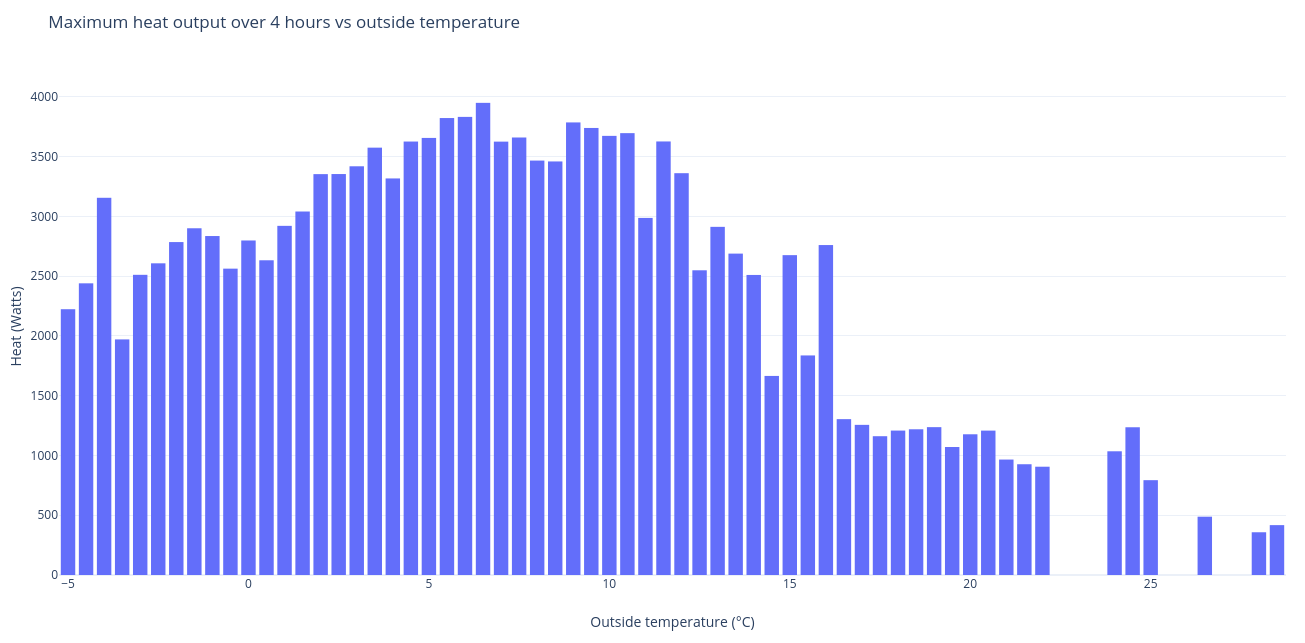

Heat Geek, vaillant, 5kW:

Brilliant stuff Trystan.
Interesting to see how some are clearly not producing as much heat as you might expect at low temps.
The Daikin 11KW clearly maxes out at about 0C.
I wonder how defrosts are affecting temps? Also maybe a WC curve too low? As you say it’s hard to know if the heat pumps could have done more.
Room temps is something I would have added which would be a measure of ‘customer satisfaction’ but I found limited data on that. Maybe you could overlay room temp data?
I would say the value of these comparisons would be to see at a glance how likely it is for a heat pump install to keep you warm in winter but at the same time the chances of being hugely oversized.
