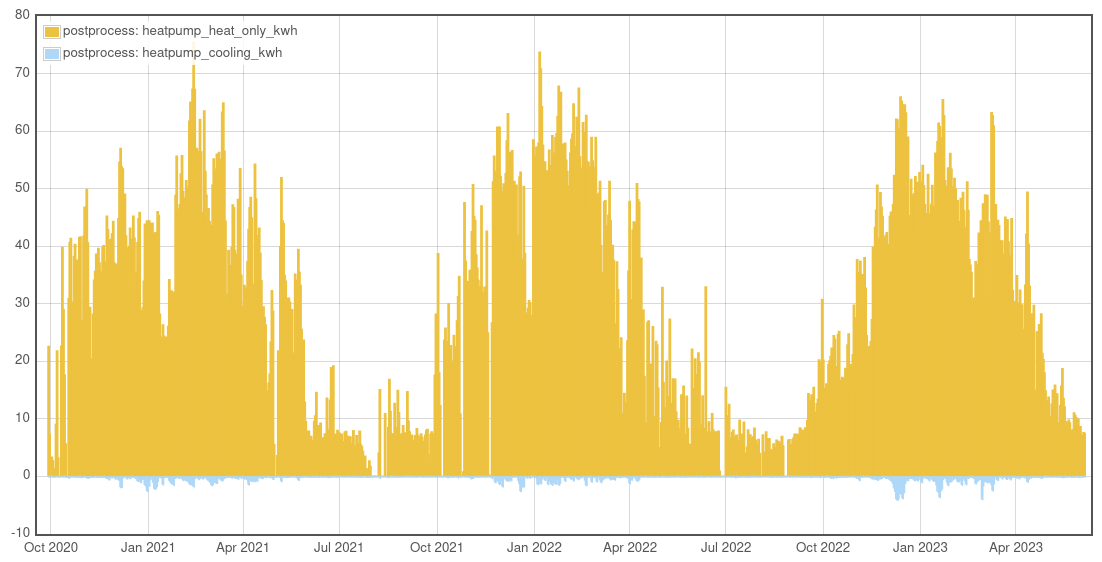

Here’s cooling/defrost energy vs heat delivered on our system for the last 3 years:

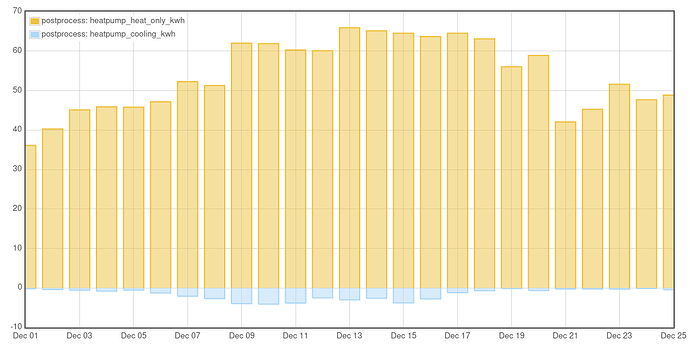

Zooming in on the peak around December 10, 2022:
4.1 kWh lost to defrosts 61.9 kWh of heat initially delivered, 57.8 kWh of heat net

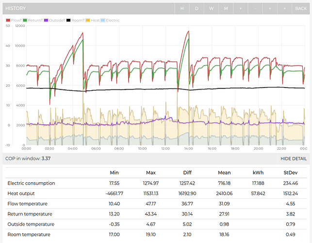

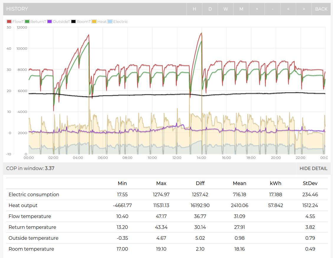

Detailed view for December 10, 2022:
2579 W gross, 2408W net
Flow temperature is very low 31C, outside temp is above zero at 1C. Average room temp quite low (comfort preferences - we could have run the system hotter), peaks at 19C at end of the evening.
Looking at the Ecodan datasheet for our unit, it doesnt list a COP that matches the 31.1C flow temp and 1C outside temp exactly.
  • At -7C outside and Mid range output the COP should be between 3.85 (25C flow) and 3.25 (35C flow).
  • At 2C outside and Mid range output the COP should be between 4.9 (25C flow) and 3.54 (35C flow).
I’ve got a COP calculator that interpolates this table as part of https://openenergymonitor.org/heatlossjs/ and it suggests that the COP should be 3.74. Im actually getting 3.37. Without the defrosts I would have got 3.6…
That’s probably quite a good example of reduced performance compared to the datasheet.

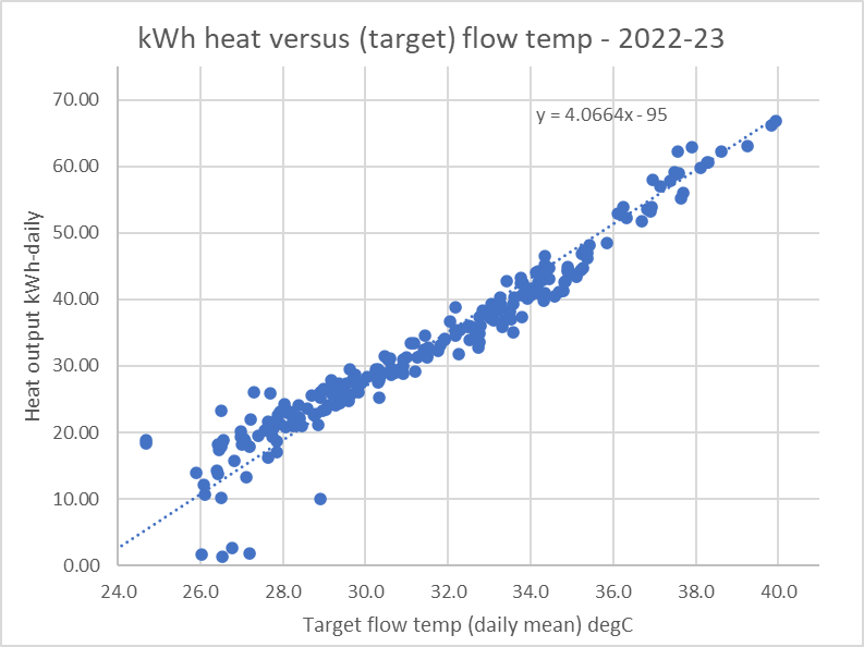

The single thing which has the greatest effect on heat pump performance is flow temperature, if you want to maximise SCOP the focus should be on getting the flow temperature as low as possible, ideally under 40C at design temperature. Getting a low temperature will probably require radiator and possibly pipework upgrades but will be worthwhile long term.
From my experience and looking at monitoring data, flow temperature and control strategy has a much greater effect on performance than heat pump than sizing and cycling. I can think of examples where an oversized heatpump can get good performance even while cycling because it’s running at a low flow temperate with optimised control setup.

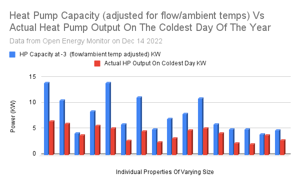

Hi All
This is my first post here so…HELLO.ooooo
I have collected some data from the lovely open energy files to compare power usage on the coldest day of the year, December 14 2022.
Taking the coldest 24 hours energy use, dividing by 24 and comparing that figure with the capacity of the heat pump on that day. I have learnt that Heat Pump capacity changes depending on ambient temp and also flow temp. So the capacity figures have been adjusted.
Hope it is of interest
Yours
Andrew Cunningham @suburbanpirate
Heat Pump Capacity (adjusted for flow_ambient temps) Vs  Actual Heat Pump Output On The Coldest Day Of The Year
